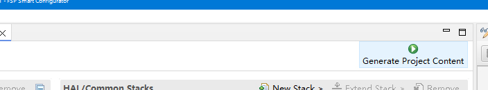

rasc部分
打开【RA4E2开发板评测】电压检测器 ThreadX显示量程0-3300 mV+独立看门狗定时器配置的RA Smart Configurator.
RTC定时器配置
点击配置窗口底部的“Stack”,在Stacks项中 点击Stacks->timeS-> Realtime Clock (r_rtc) 。如图步骤加入RTC模块。
属性配置
在下面配置中:
Parameter Checking : Enabled
Set Source Clock in Open : Enabled
Clock Source : Sub-Clock
NMI callback : rtc_callback
事件标志组
采用上次一样的配置,用其中一位代表 rtc起用标记。
点击Stacks选项卡--在左侧 Threads,
在Threads下方有一个Object区域,点击New Object--Event Flags  属性 Name: EventGroup
Symbol: EventGroup
完成后点击生成代码即可
rasc部分配置完。

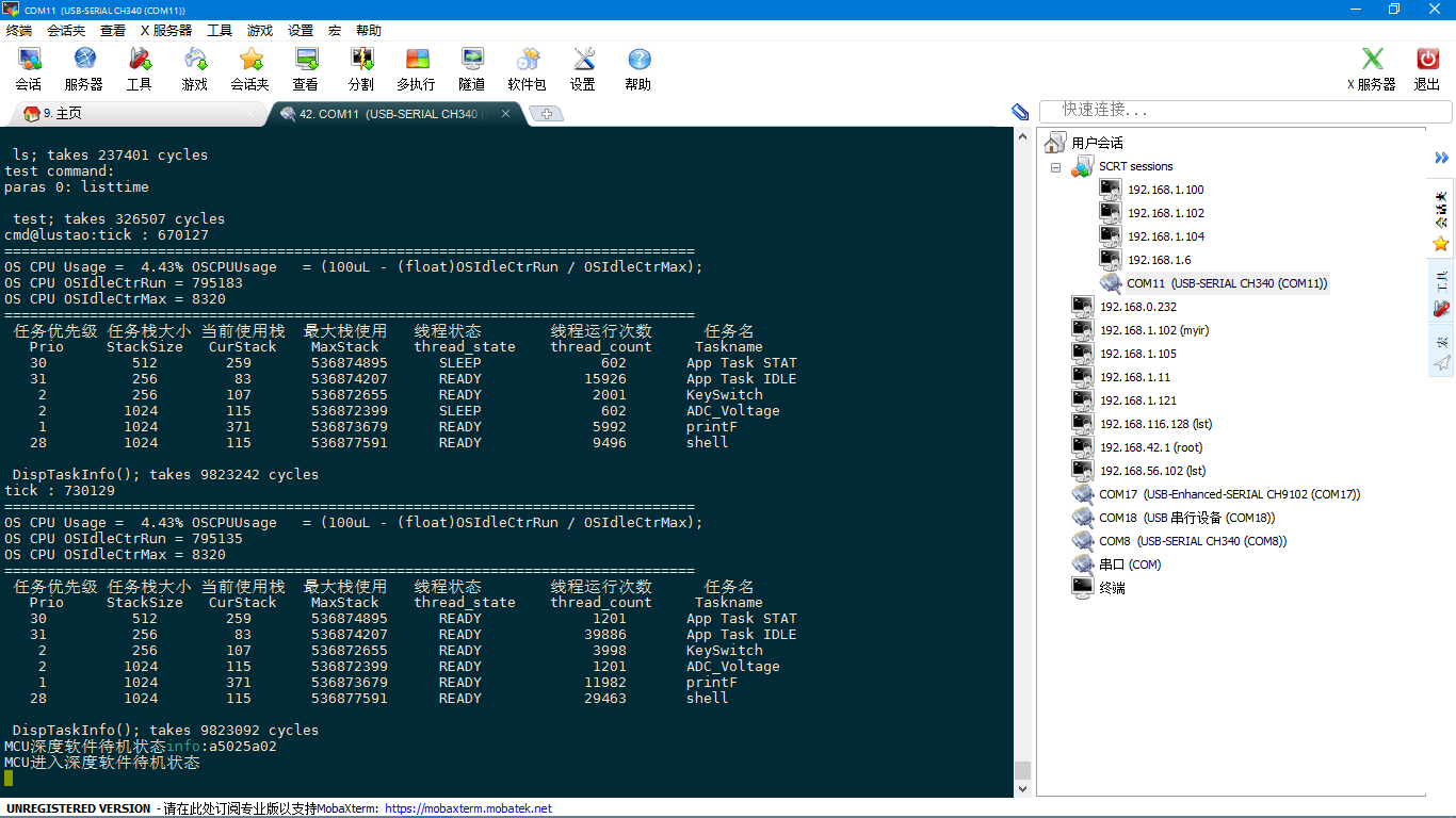

static void DispTaskInfo(void)
TX_THREAD *p_tcb;
p_tcb = &AppTaskStatTCB;
tx_mutex_get(&AppPrintfSemp, TX_WAIT_FOREVER);
printf("tick : %lu\r\n", _tx_time_get());
tx_mutex_put(&AppPrintfSemp);
printf("=================================================================================\r\n");
printf("OS CPU Usage = %5.2f%% OSCPUUsage = (100uL - (float)OSIdleCtrRun / OSIdleCtrMax); \r\n", OSCPUUsage);
printf("OS CPU OSIdleCtrRun = %d\r\n", OSIdleCtrRun);
printf("OS CPU OSIdleCtrMax = %d\r\n", OSIdleCtrMax);
printf(" ÈÎÎñÓÅÏȼ¶ ÈÎÎñÕ»´óС µ±Ç°Ê¹ÓÃÕ» ×î´óջʹÓà Ïß³Ì״̬ Ïß³ÌÔËÐдÎÊý ÈÎÎñÃû\r\n");
printf(" Prio StackSize CurStack MaxStack thread_state thread_count Taskname\r\n");
while (p_tcb != (TX_THREAD *)0)
printf(" %2d %5d %5d %5d %s %5d %s\r\n",
p_tcb->tx_thread_priority,
p_tcb->tx_thread_stack_size,
(int)p_tcb->tx_thread_stack_end - (int)p_tcb->tx_thread_stack_ptr,
(int)p_tcb->tx_thread_stack_end - (int)p_tcb->tx_thread_stack_highest_ptr,
tx_thread_status[p_tcb->tx_thread_state].name,
p_tcb->tx_thread_run_count,
p_tcb->tx_thread_name);
p_tcb = p_tcb->tx_thread_created_next;
if(p_tcb == &AppTaskStatTCB) break;

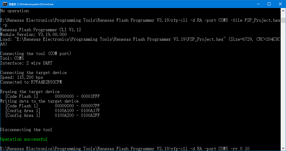

rtc_status_t R_RTCinformation=(rtc_status_t) R_RTC->RCR2_b.START;
uart_initialize();
R_BSP_PinAccessEnable ();
if (1U == R_SYSTEM->RSTSR0_b.PORF){ printf("MCU Power-On Reset \r\n"); (*(STBRAM_BASE_nmi_reg+4 ))=0; }
if((*(STBRAM_BASE_nmi_reg+4 ))==0xaa)
R_RTC_Open(&g_rtc_ctrl, &g_rtc_cfg);
R_RTC->RCR2_b.START = 1U;
printf("MCU Reset rtc_status R_RTC->RCR2_b.START is:%d\r\n",R_RTCinformation);
if (1U == R_SYSTEM->RSTSR1_b.SWRF)
printf("MCU Software Reset info.%x \r\n",*STBRAM_BASE_nmi_reg);
if (((*STBRAM_BASE_nmi_reg )& 0x5a00)==0x5a00){
printf("No.%d MCU nmi -Independent Watchdog Timer Reset \r\n",((*STBRAM_BASE_nmi_reg )& 0xff));
rtc_time_t get_time;
R_RTC_CalendarTimeGet(&g_rtc_ctrl, &get_time);
printf(" %d y %d m %d d %d h %d m %d s %d w\n",get_time.tm_year+1900,get_time.tm_mon+1,get_time.tm_mday,get_time.tm_hour,get_time.tm_min,get_time.tm_sec,get_time.tm_wday);
printf("before Reset Timestamp =%d \r\n",(*(STBRAM_BASE_nmi_reg+3 )));
printf("after Reset Timestamp =%d \r\n",convert_to_timestamp( get_time.tm_year, get_time.tm_mon, get_time.tm_mday, get_time.tm_hour, get_time.tm_min, get_time.tm_sec));
if (1U == R_SYSTEM->RSTSR1_b.IWDTRF) printf("MCU Independent Watchdog Timer Reset \r\n");
if (1U == R_SYSTEM->RSTSR0_b.DPSRSTF)
R_SYSTEM->RSTSR0_b.DPSRSTF = 0;

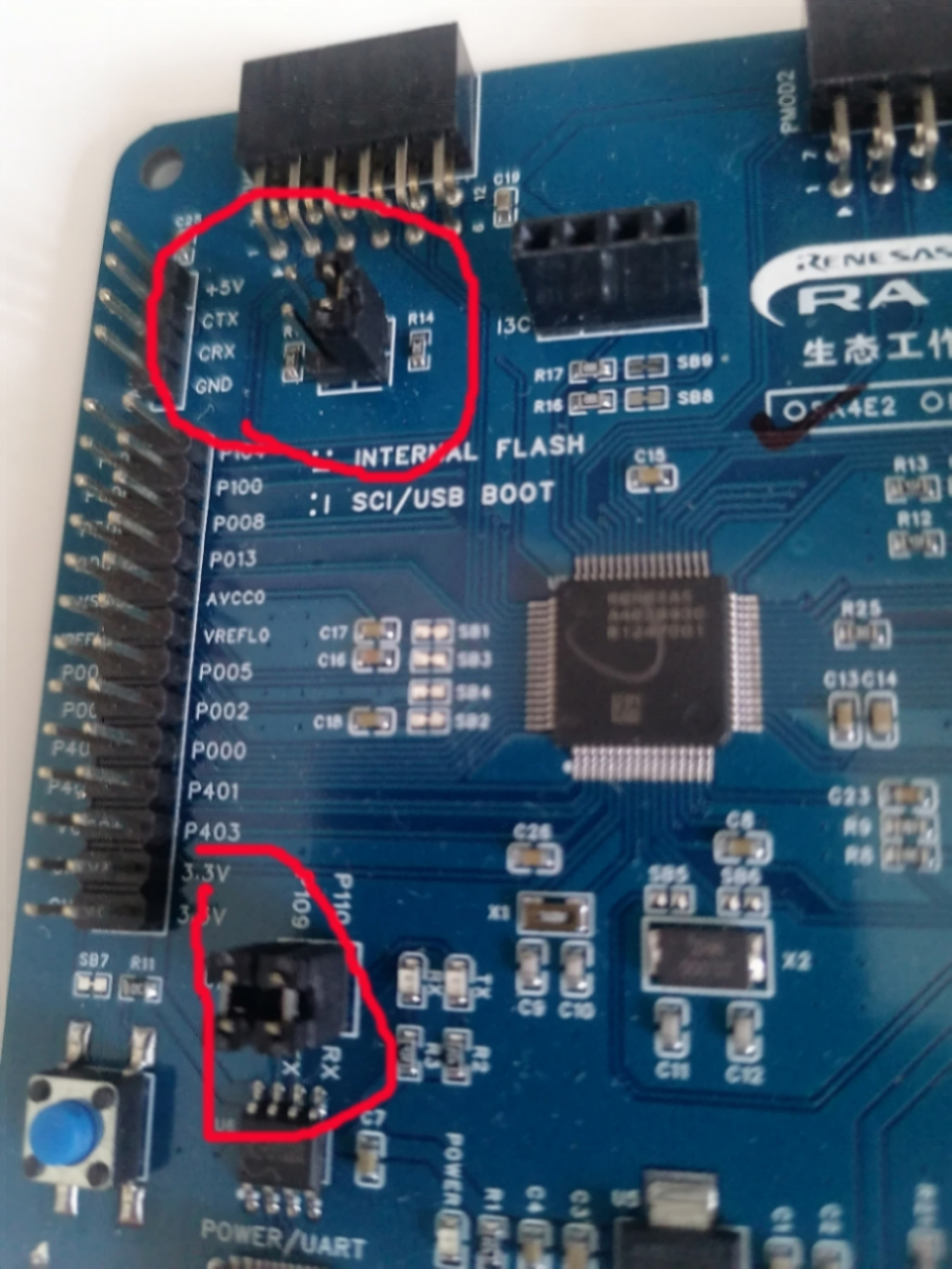

rfp-cli.exe命令行烧录部分 :* MODE CONFIG**
配置成sci boot模式* 连接带自己USB-com接口tx,rx到usb
*找到编译后hex文件\FSP_Project\Objects\FSP_Project.hex并copy到Renesas Flash软件安后目录用type-c usb 连接线连接开发板和电脑,在设备管理器找到com口号为com5在Renesas Flash软件安后目录打开命令窗口,每次发送命令前最好按一下复位。运行各命令。命令rfp-cli -d RA -lp 查看可以用com口```
- MODE CONFIG**
配置成sci boot模式
- 连接带自己USB-com接口tx,rx到usb
Renesas Flash Programmer CLI V1.12
Module Version: V3.19.00.000
[Port]
COM5
COM6
COM7
命令 rfp-cli -d RA -port COM5 -ls查看可以用速度
Connecting the tool (COM port)
Tool: COM5
Interface: 2 wire UART
Connecting the target device
Disconnecting the tool[Speed]
9600
115200
命令 rfp-cli -d RA -port COM5 -sig查看目标信息
Tool: COM5
Speed: 115,200 bps
Connected to R7FA4E2B93CFM
Signature:
Device: R7FA4E2B93CFM
Boot Firmware Version: V7.0.0
Device Unique ID: 4E4B2D5C5B634B533539393742037771
Device Code: 05
Memory Info:
00000000 - 0000FFFF: Code Flash 1 (Block Size: 8 KB)
00010000 - 0001FFFF: Code Flash 1 (Block Size: 32 KB)
08000000 - 08000FFF: Data Flash 1 (Block Size: 64)
0100A100 - 0100A2FF: Config Area 1 (Block Size: 512)
Operation successful
命令rfp-cli -d RA -port COM5 -file lu.hex -p 烧录
Load: "E:\\\\Renesas Electronics\\\\Programming Tools\\\\Renesas Flash Programmer V3.19\\\\FSP_Project.hex" (Size=42459, CRC=68D14AFE)
Tool: COM5
Speed: 115,200 bps
Erasing the target device
[Code Flash 1] 00000000 - 00003FFF
Writing data to the target device
[Code Flash 1] 00000000 - 0000397F
[Config Area 1] 0100A100 - 0100A17F
[Config Area 1] 0100A200 - 0100A2FF

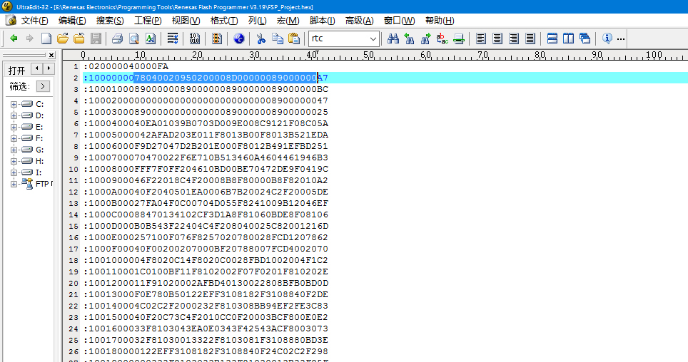

命令rfp-cli -d RA -port COM5 -rv 0 10 读取目标地址 数量数据
Tool: COM5
Speed: 115,200 bps
Reading data from the device
[Code Flash 1] 00000000 - 00000009
Address | 00 01 02 03 04 05 06 07 08 09 0A 0B 0C 0D 0E 0F
00000000 | 40 60 00 20 91 0C 00 00 85 03
- 文件前16字节:40600020910C000085030000B3020000
*烧录数据正确,成功

com显示:
l_key 3
shell_Ff=1
Welcome to the micro_shell v0.01! Build time Sep 28 2025 08:45:43
cmd@lustao:iwdt_counter=1942
cmd@lustaortcset 25/09/28 08:45:43
paras 1: 25/09/28
paras 2: 08:45:43
2025 y 9 m 28 d 20 h 24 m 24 s 0 w
get_txtime: 175 s
Timestamp: 1759091064
start boot Timestamp: 1759090889
cmd@lustao:tick : 180142
OS CPU Usage = 4.42% OSCPUUsage = (100uL - (float)OSIdleCtrRun / OSIdleCtrMax);
OS CPU OSIdleCtrRun = 795204
OS CPU OSIdleCtrMax = 8320
30 512 259 536874895 READY 1378 App Task STAT
31 256 83 536874207 READY 49781 App Task IDLE
2 256 107 536872655 READY 4589 KeySwitch
2 1024 115 536872399 READY 1378 ADC_Voltage
1 1024 371 536873679 READY 13751 printF
28 1024 115 536877591 READY 37123 shell

MCU Software Reset info.a5005a01
No.1 MCU nmi -Independent Watchdog Timer Reset
2025 y 9 m 28 d 20 h 28 m 0 s 0 w
before Reset Timestamp =1759091280
after Reset Timestamp =1759091280
在串口调试助手中看见rtc信息,唤醒成信息包括系统tick 复位状态信息。
达到预期状态。
