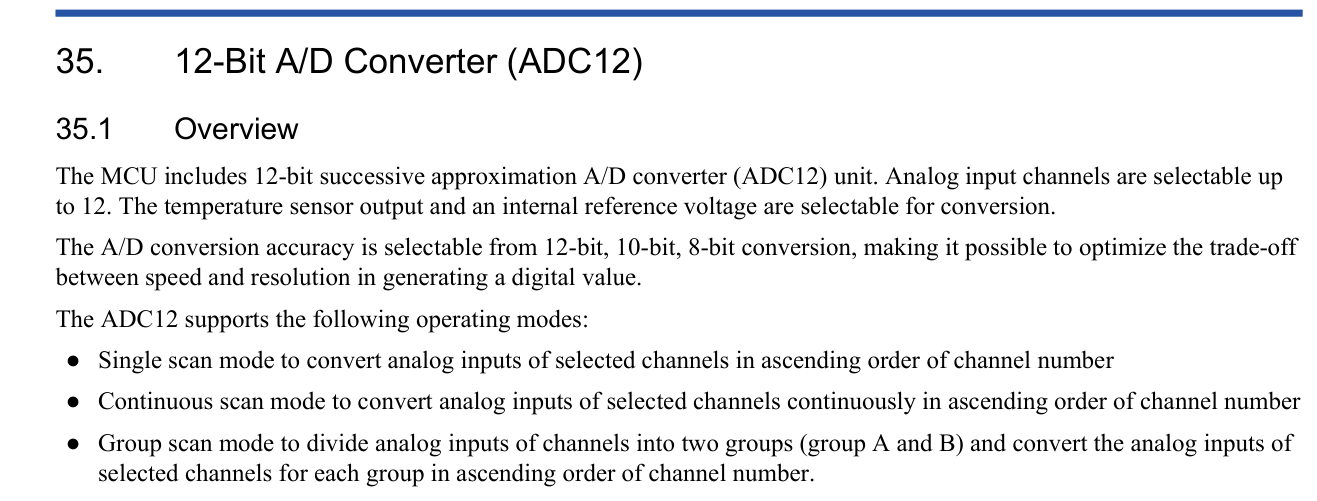

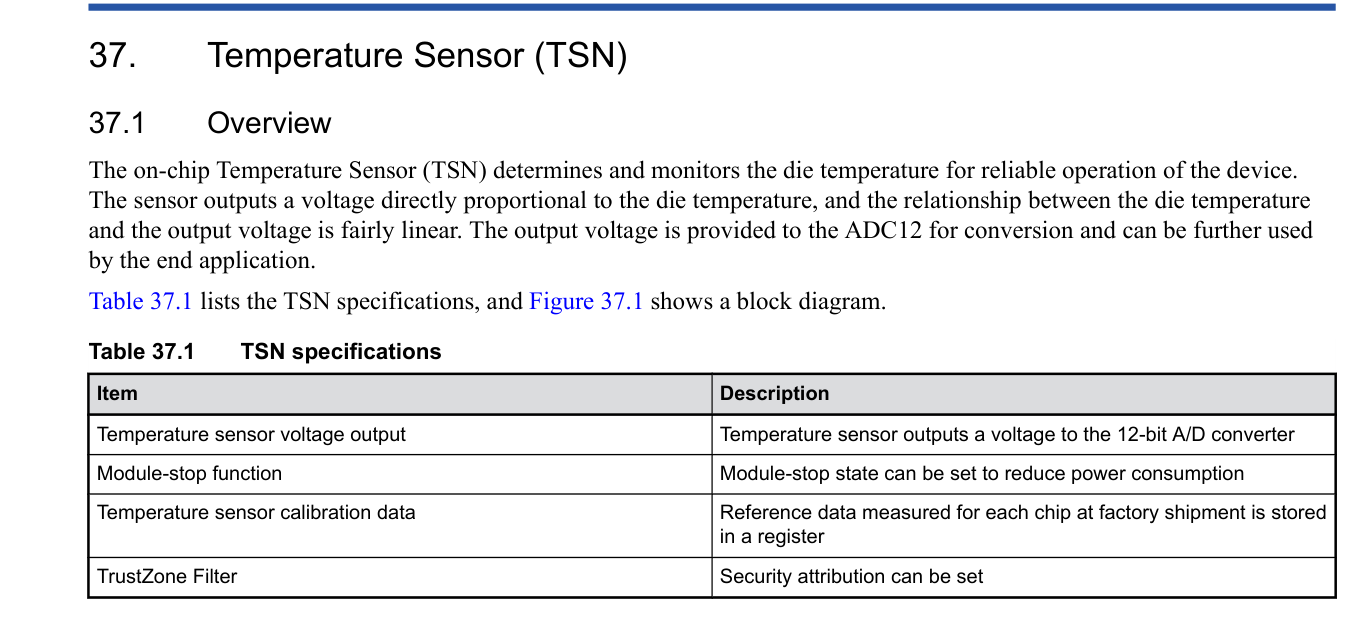

RA4E2是一款基于100MHz Arm®Cortex®-M33内核架构的核心板,主控芯片为R7FA4E2B93CFM。RA4E2组是RA4系列中最新的入门级微控制器,基于带有TrustZone的100MHz Arm®Cortex®-M33内核。RA4E2 MCU提供了高性能的ADC采样通道,具备12-Bit A/D Converter
同时,还带有一个内部温度传感器,叫做TSN。

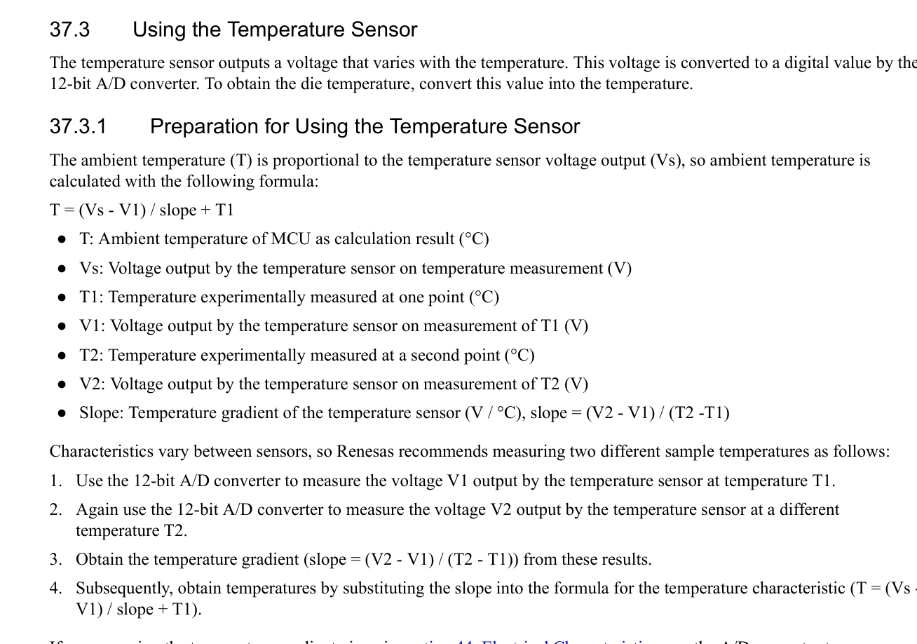

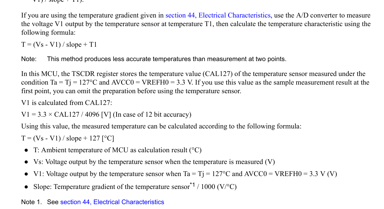

TSN有一套温度值计算算法,如下:
The ambient temperature (T) is proportional to the temperature sensor voltage output (Vs), so ambient temperature is
calculated with the following formula:
T = (Vs - V1) / slope + T1
● T: Ambient temperature of MCU as calculation result (°C)
● Vs: Voltage output by the temperature sensor on temperature measurement (V)
● T1: Temperature experimentally measured at one point (°C)
● V1: Voltage output by the temperature sensor on measurement of T1 (V)
● T2: Temperature experimentally measured at a second point (°C)
● V2: Voltage output by the temperature sensor on measurement of T2 (V)
● Slope: Temperature gradient of the temperature sensor (V / °C), slope = (V2 - V1) / (T2 -T1)
Characteristics vary between sensors, so Renesas recommends measuring two different sample temperatures as follows:
- Use the 12-bit A/D converter to measure the voltage V1 output by the temperature sensor at temperature T1.
- Again use the 12-bit A/D converter to measure the voltage V2 output by the temperature sensor at a different
temperature T2.
- Obtain the temperature gradient (slope = (V2 - V1) / (T2 - T1)) from these results.
- Subsequently, obtain temperatures by substituting the slope into the formula for the temperature characteristic (T = (Vs -V1) / slope + T1).

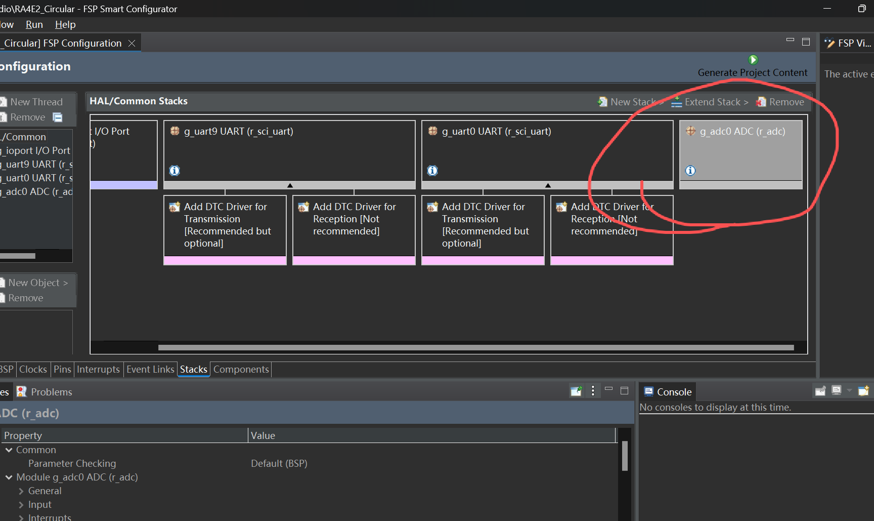

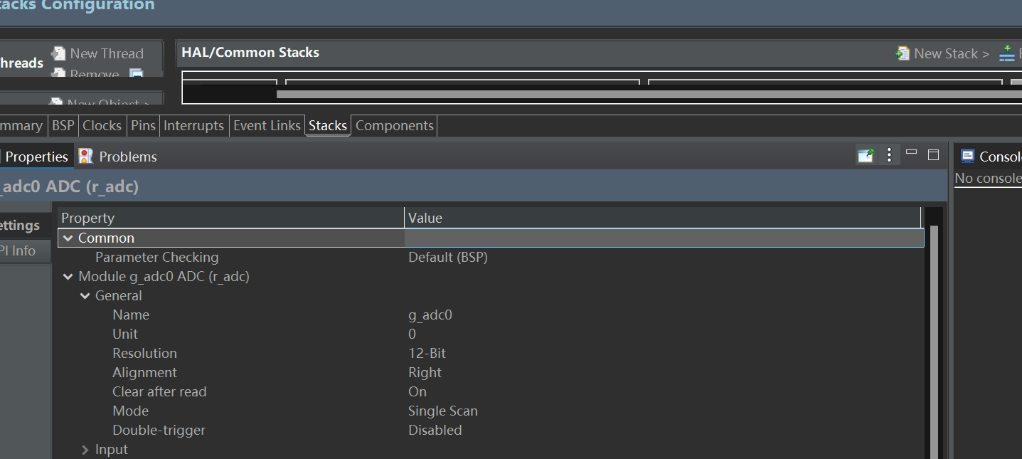

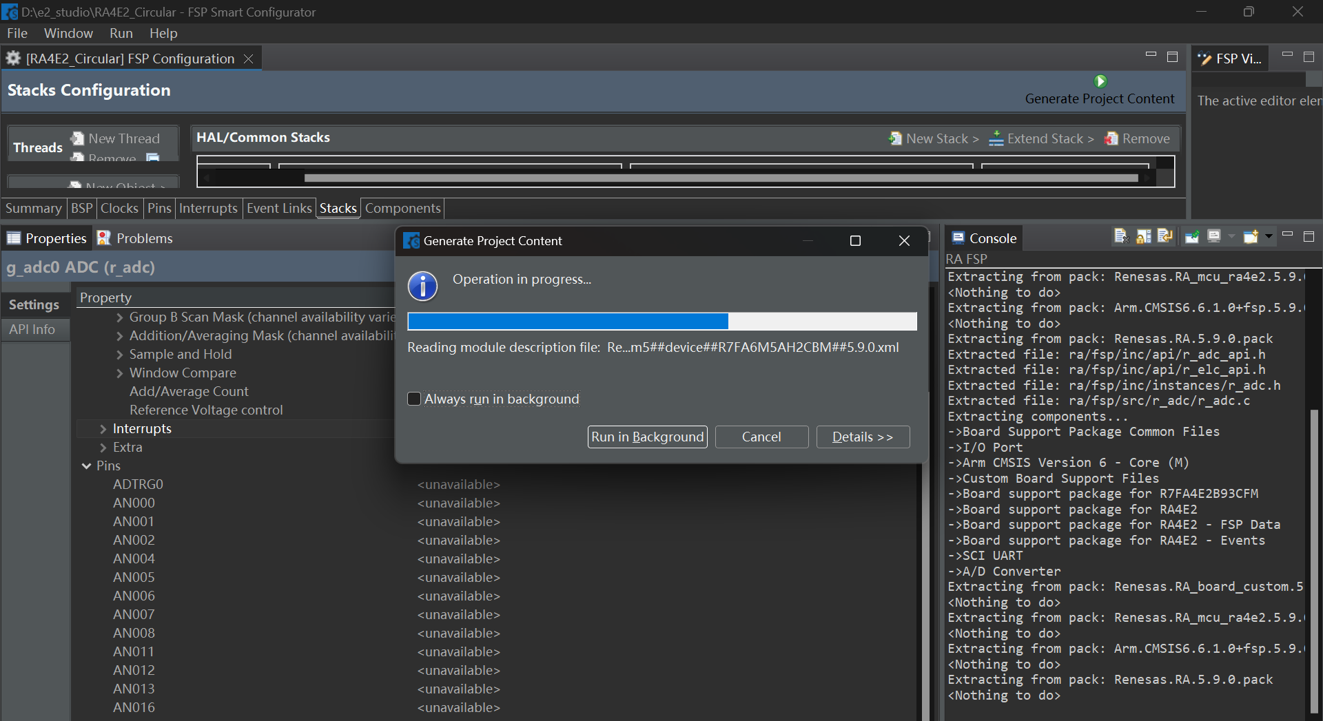

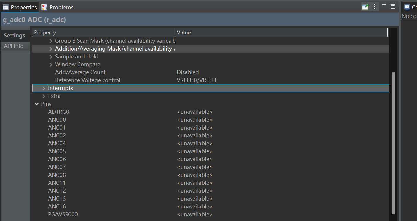

1。打开瑞萨RA Smart配置软件
配置ADC
2。点击生成代码

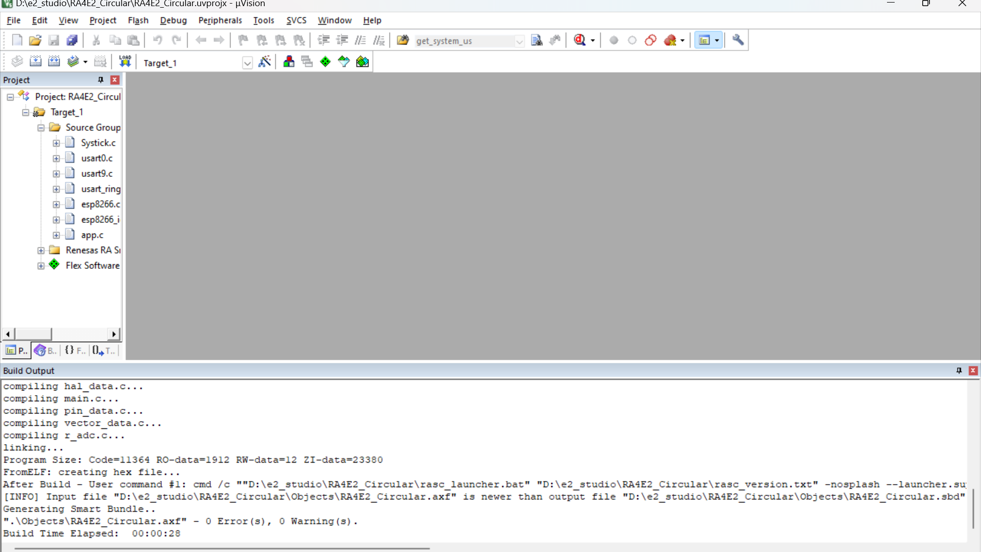

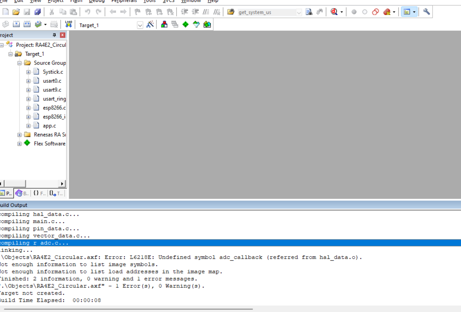

3。打开KEIL
编译代码,会发现如下错误

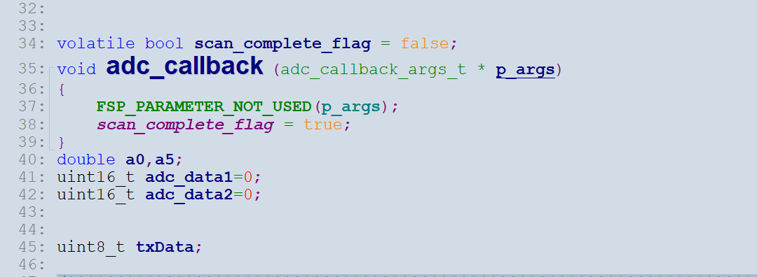

这是因为还没有实现adc_callback()中断函数
4。打开主函数,添加adc_callback函数
添加void adc_callback (adc_callback_args_t * p_args)中断函数

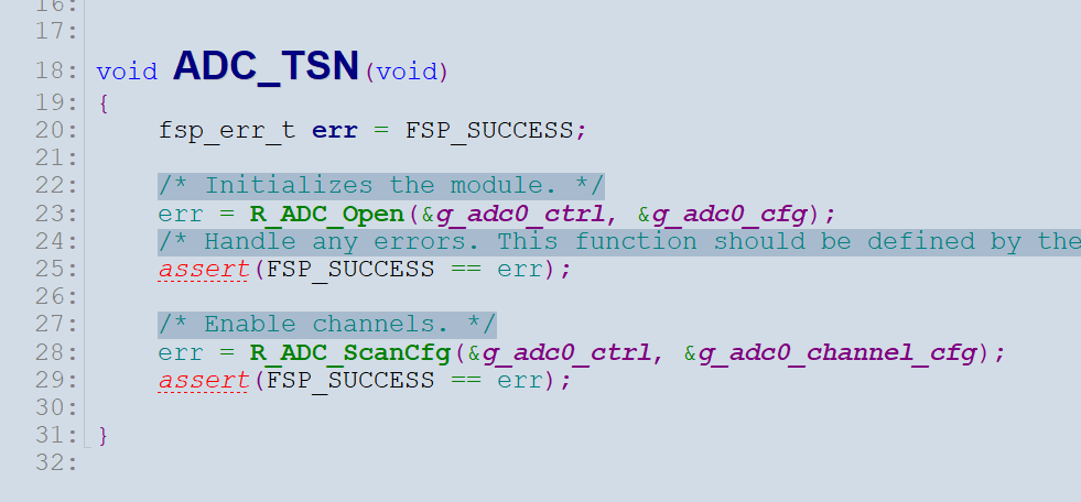

void ADC_TSN(void)
fsp_err_t err = FSP_SUCCESS;
err = R_ADC_Open(&g_adc0_ctrl, &g_adc0_cfg);
assert(FSP_SUCCESS == err);
err = R_ADC_ScanCfg(&g_adc0_ctrl, &g_adc0_channel_cfg);

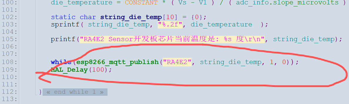

while(esp8266_mqtt_publish("RA4E2", string_die_temp, 1, 0));
HAL_Delay(100);

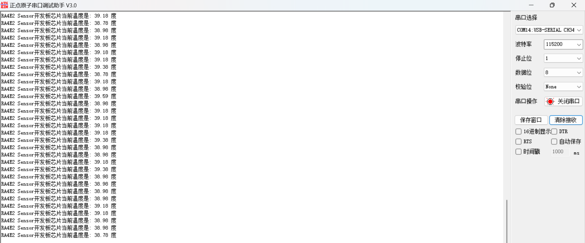

编译代码,烧录板子

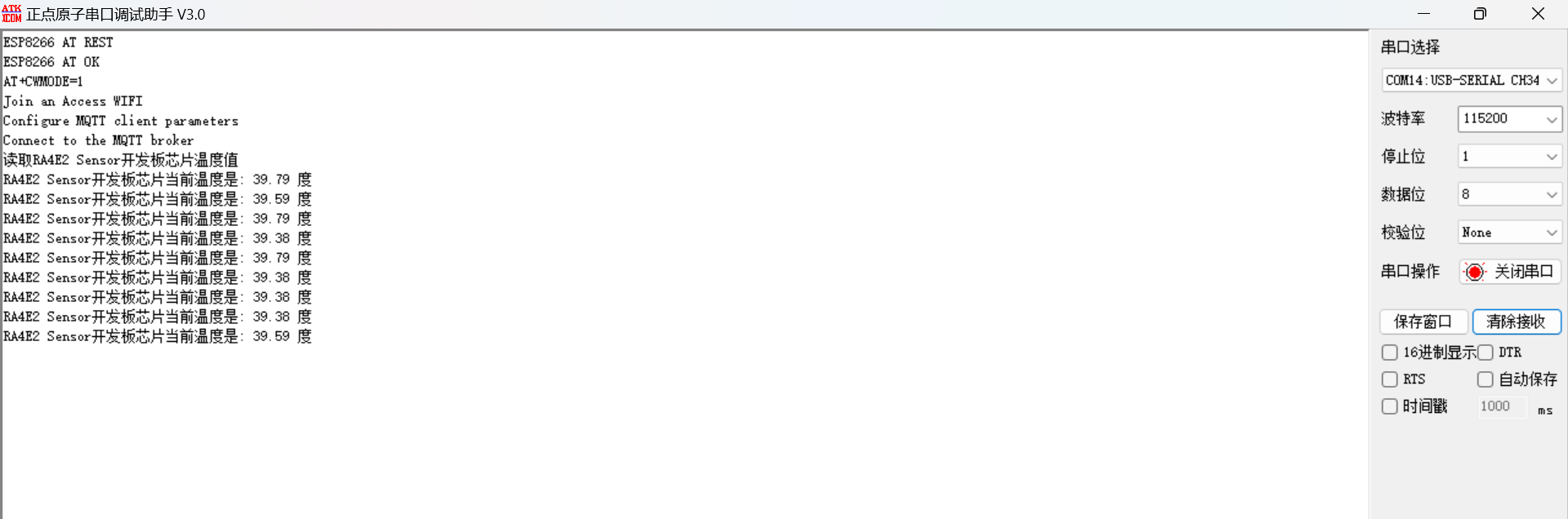

打开串口助手
可以看到
RA4E2 Sensor开发板芯片当前温度是: 39.59 度

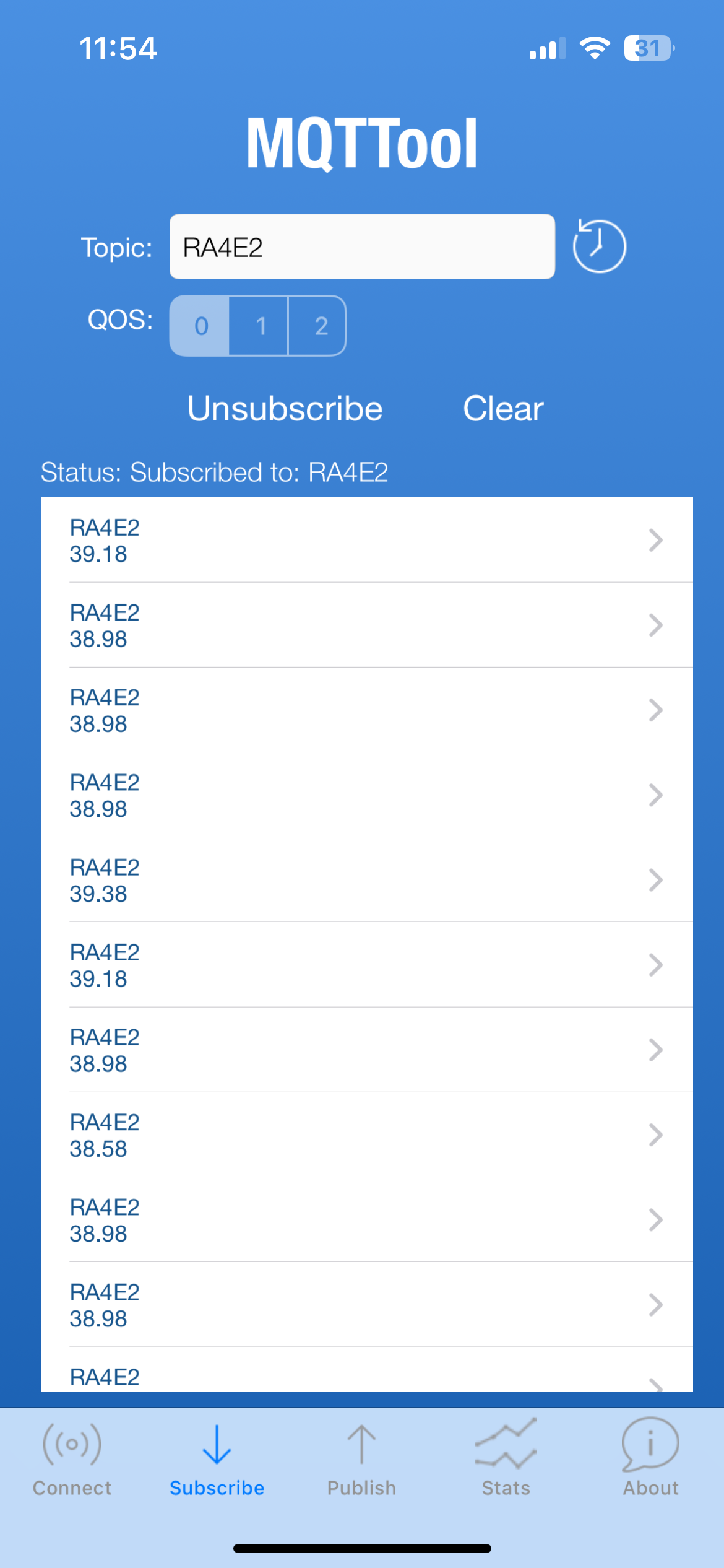

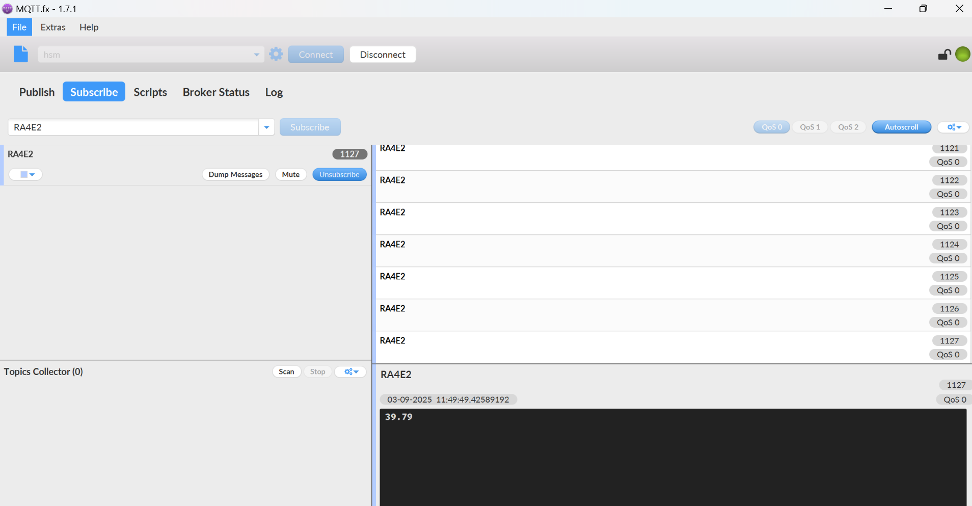

在代码中,我已经把温度上传到MQTT云端了,可以打开MQTT.fx
软件或者手机,接收RA4E2温度数据
顶部是手机,底部是MQTT.fx软件
