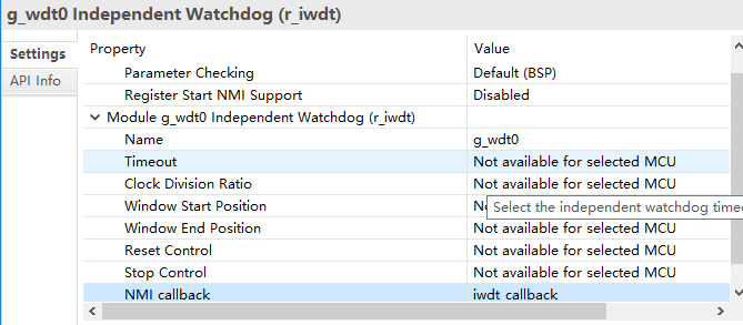

独立看门狗定时器配置
在Stacks项中 点击Stacks->New Stack->Monitoring -> Independent Watchdog(r_iwdt)。
独立看门狗定时器 IWDT属性配置
在下面配置中:
NMI callback : iwdt_callback

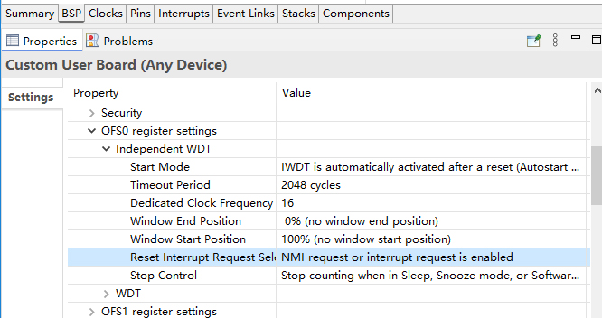

然后点击 BSP 的属性settings界面,找到 OFS0 register settings-> Independent WDT 去设置 IWDT 的属性。
Start Mode: IWDT is automatically activated after a reset (Autostart mode)
Timeout Period: 2048 cycles
Dedicated Clock Frequency Divisor: 16
Reset Interrupt Request Select: NMI request or interrupt request is enabled
独立看门狗超时时间计算:
首先,独立看门狗的输入时钟频率为 15000hz
时钟分频比等于 16
将循环周期设为 2048 cycles
那么,可以得到独立看门狗的时钟频率 15000Hz / 16 = 937.5hz
周期时间等于 1/937.5hz = 1 ms
最终计算出设置的超时时间 = 1 ms x 2048 cycles = 2 秒左右
Tips: cycles :配置的循环周期次数,此数值越大,超时时间越长。

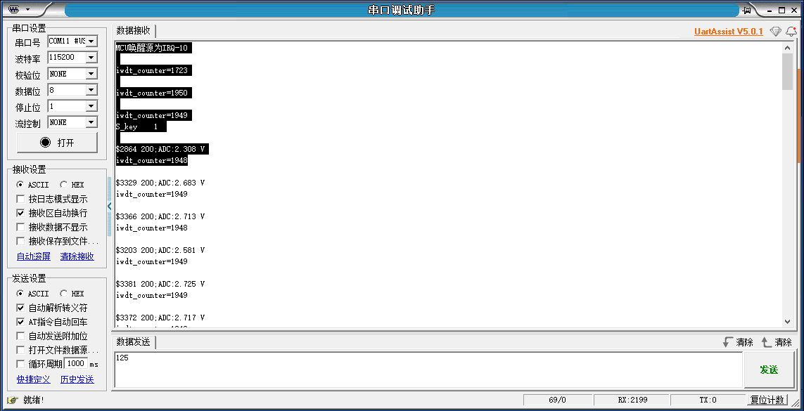

uint32_t iwdt_counter;
err = R_IWDT_CounterGet(&g_iwdt0_ctrl, &iwdt_counter);
/* Refresh before the counter underflows to prevent reset or NMI. */
(void) R_IWDT_Refresh(&g_iwdt0_ctrl);
assert(FSP_SUCCESS == err);
tx_mutex_get(&AppPrintfSemp, TX_WAIT_FOREVER);
printf("iwdt_counter=%d\\\\n",iwdt_counter);
tx_mutex_put(&AppPrintfSemp);

com显示:
iwdt_counter=1725
iwdt_counter=1950
iwdt_counter=1949
S_key 1
$2905 200;ADC:2.341 V
iwdt_counter=1950
$3347 200;ADC:2.697 V
tick : 60569
OS CPU Usage = 3.45% OSCPUUsage = (100uL - (float)OSIdleCtrRun / OSIdleCtrMax);
OS CPU OSIdleCtrRun = 803275
OS CPU OSIdleCtrMax = 8320
????????? ???????С ??????? ??????? ?????? ????? ??????д???
Prio StackSize CurStack MaxStack Taskname thread_state thread_count
30 512 259 536874407 App Task STAT 4 683
31 256 83 536873719 App Task IDLE 0 8575
2 256 107 536872207 KeySwitch 0 2016
2 1024 251 536871951 ADC_Voltage 0 606
1 1024 275 536873231 printF 0 5995
iwdt_counter=1891
$530 200;ADC:0.427 V
tick : 427955
OS CPU Usage = 3.32% OSCPUUsage = (100uL - (float)OSIdleCtrRun / OSIdleCtrMax);
OS CPU OSIdleCtrRun = 804407
30 512 259 536874407 App Task STAT 0 4764
31 256 83 536873719 App Task IDLE 0 57457
2 256 107 536872207 KeySwitch 0 14196
2 1024 251 536871951 ADC_Voltage 0 4278
1 1024 275 536873231 printF 0 41935
iwdt_counter=1869
MCU进入深度软件待机状态
MCU唤醒源为IRQ-10
iwdt_counter=1723
iwdt_counter=1950
S_key 1
$2864 200;ADC:2.308 V
iwdt_counter=1948
在串口调试助手中看见独立看门狗定时器唤醒信息,唤醒成功。所有信息包括系统tick 独立看门狗定时器都从复位状态开始平均100ms喂狗操作。
