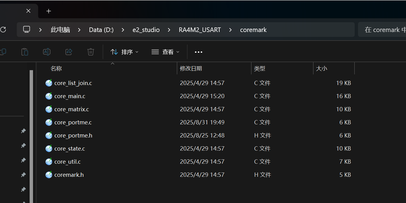

2。将下载来的coremark源码放在一个文件夹里
我的如下所示:

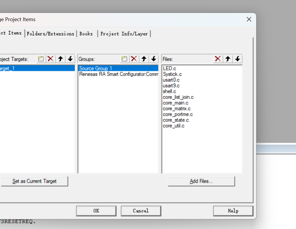

3。将coremark添加到KEIL工程

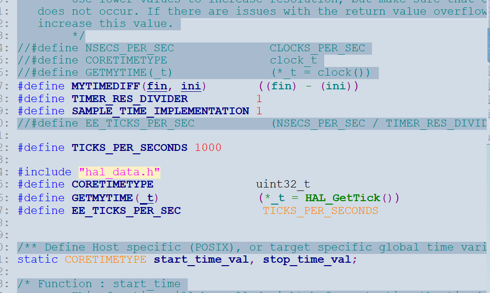

4。修改coremark里面的宏定义
#define MYTIMEDIFF(fin, ini) ((fin) - (ini))
#define TIMER_RES_DIVIDER 1
#define SAMPLE_TIME_IMPLEMENTATION 1
//#define EE_TICKS_PER_SEC (NSECS_PER_SEC / TIMER_RES_DIVIDER)
#define TICKS_PER_SECONDS 1000
#include "hal_data.h"
#define CORETIMETYPE uint32_t
#define GETMYTIME(_t) (*_t = HAL_GetTick())
#define EE_TICKS_PER_SEC TICKS_PER_SECONDS

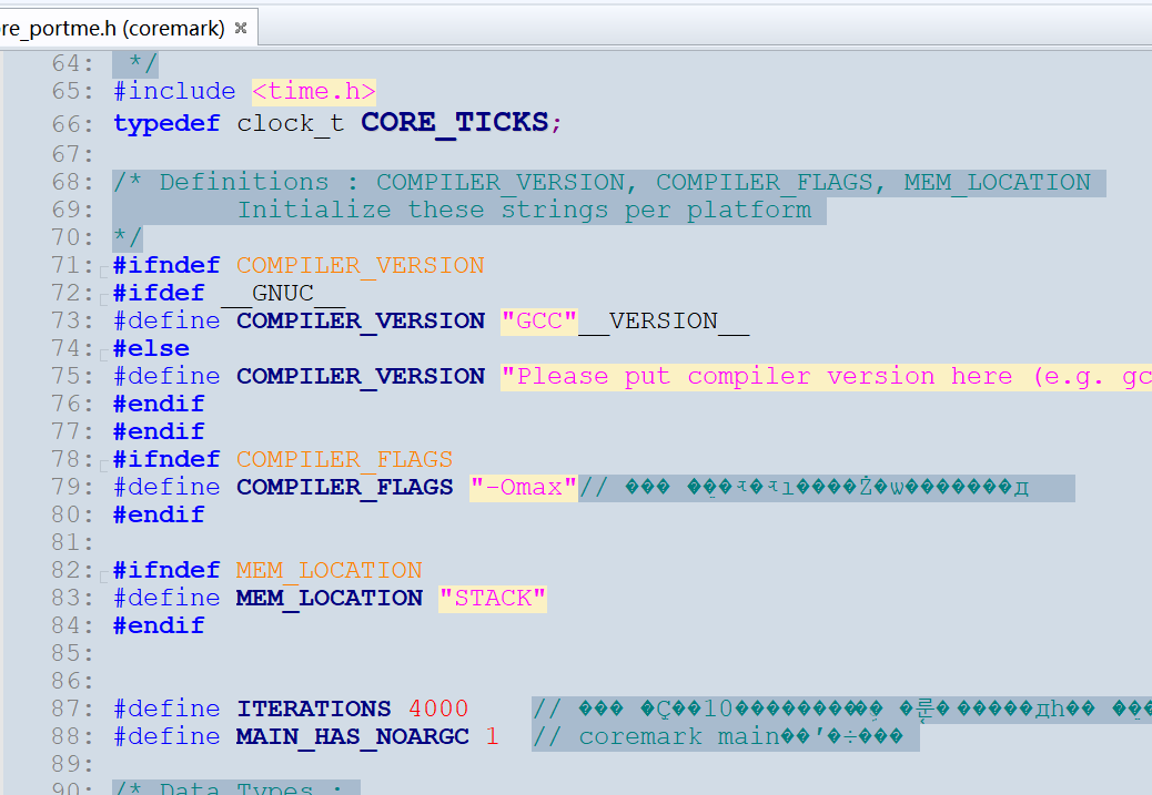

#ifndef COMPILER_VERSION
#ifdef GNUC
#define COMPILER_VERSION "GCC"VERSION
#else
#define COMPILER_VERSION "Please put compiler version here (e.g. gcc 4.1)"
#endif
#endif
#ifndef COMPILER_FLAGS
#define COMPILER_FLAGS "-Omax"// ���ֵ����ʵ�ʵı����Ż�ѡ�������д
#endif
#ifndef MEM_LOCATION
#define MEM_LOCATION "STACK"
#endif

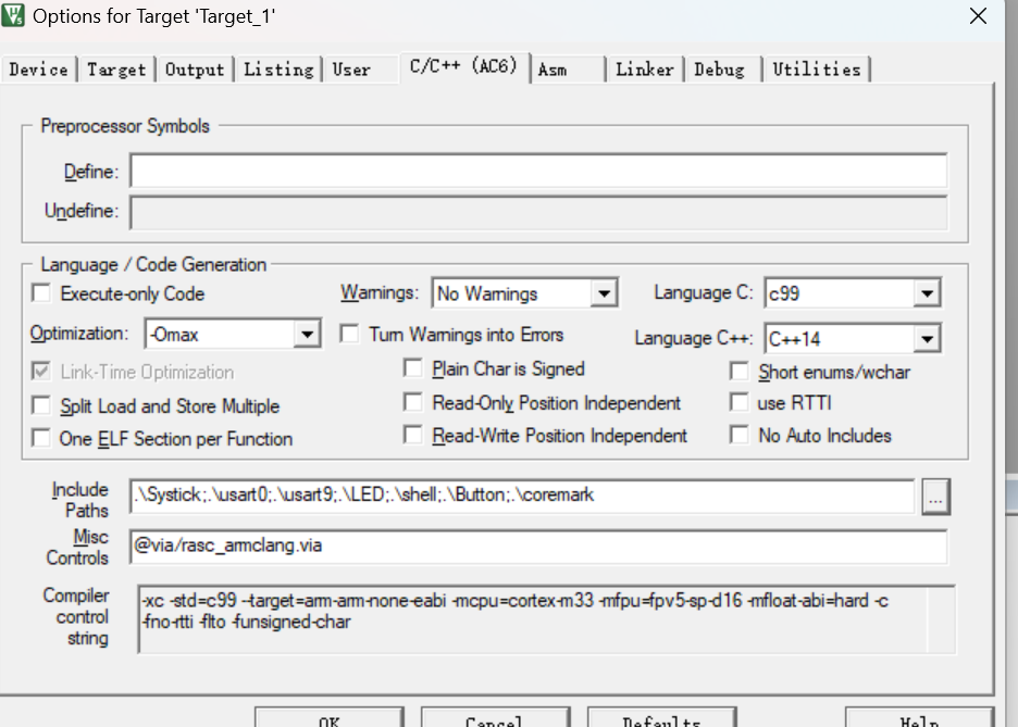

#define ITERATIONS 4000 // ���ֵ��Ҫ��֤�ܹ���������10�룬������дһ��ֵ�����в���10��ᱨ����ٻ�����
#define MAIN_HAS_NOARGC 1 // coremark main��ʹ�÷���ֵ
只需要修改上面两处宏定义既可以了。

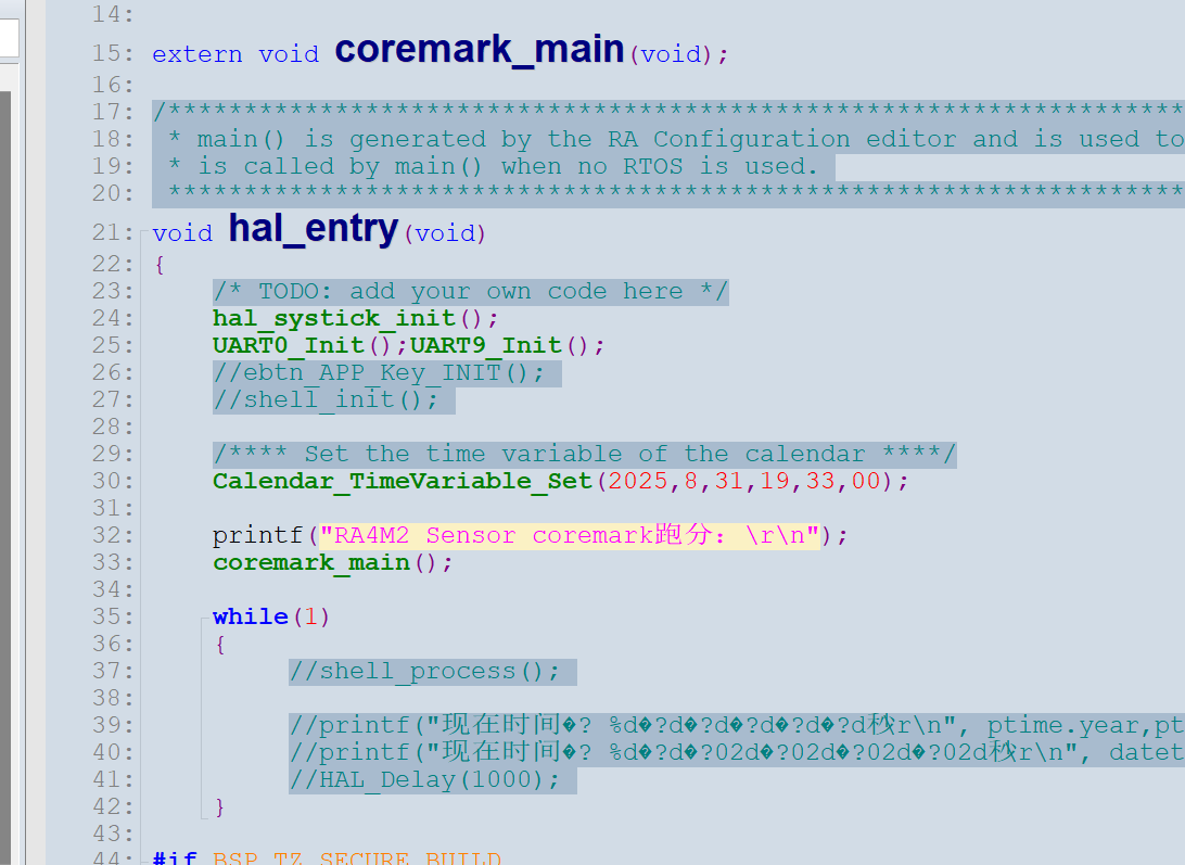

5。主函数添加核心代码
#include "LED.h"
#include "Systick.h"
#include "usart0.h"
#include "usart9.h"
#include "shell.h"
//#include "ebtn_app.h"
#include "coremark.h"
FSP_CPP_HEADER
void R_BSP_WarmStart(bsp_warm_start_event_t event);
FSP_CPP_FOOTER
extern void coremark_main(void);
main() is generated by the RA Configuration editor and is used to generate threads if an RTOS is used. This function
is called by main() when no RTOS is used.
void hal_entry(void)
/ TODO: add your own code here */
hal_systick_init();
UART0_Init();UART9_Init();
//ebtn_APP_Key_INIT();
//shell_init();
/**** Set the time variable of the calendar ****/
Calendar_TimeVariable_Set(2025,8,31,19,33,00);
printf("RA4M2 Sensor coremark跑分:\r\n");
coremark_main();

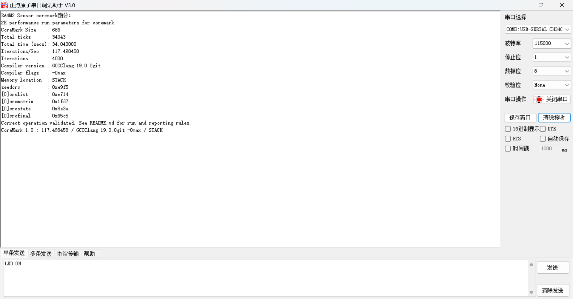

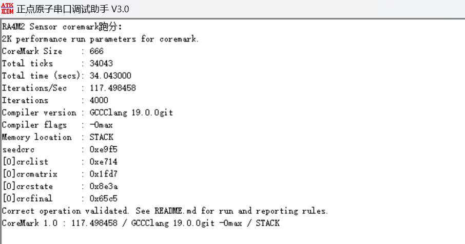

5。打开串口助手
CoreMark 1.0 : 117.498458 / GCCClang 19.0.0git -Omax / STACK
可以看到RA4M2 的coremark最终跑分为117分
非常的强劲!!!!
