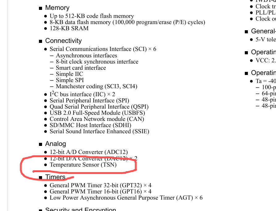

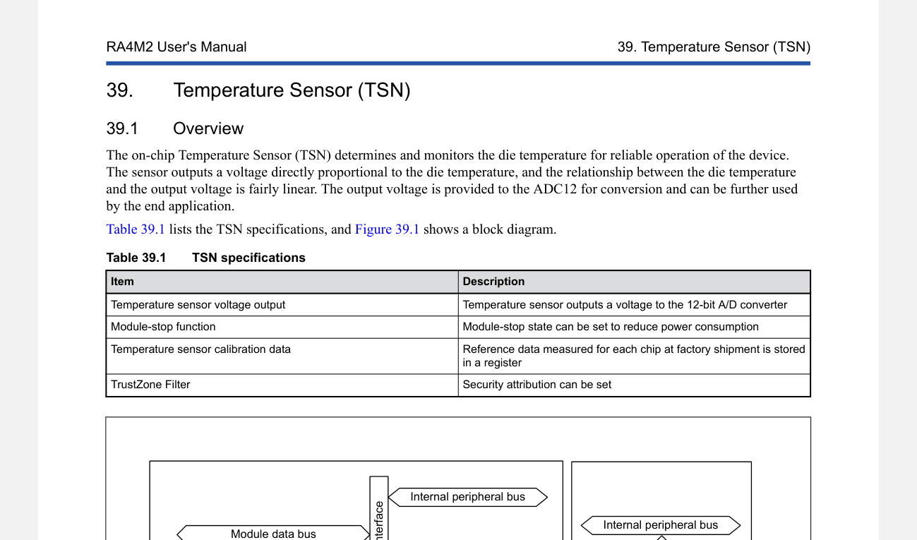

根据数据手册,可知,RA4M2 & SENSOR内部有一个温度传感器,叫做TSN,是一个特殊的ADC通道。论坛里的人都不知道这个东西,除了我和RA的版主,所以这篇帖子就是来给这些人扫盲的。
TSN的计算算法入下:

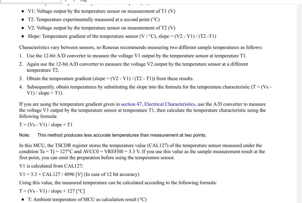

Characteristics vary between sensors, so Renesas recommends measuring two different sample temperatures as follows:
Use the 12-bit A/D converter to measure the voltage V1 output by the temperature sensor at temperature T1.
Again use the 12-bit A/D converter to measure the voltage V2 output by the temperature sensor at a different
temperature T2.
Obtain the temperature gradient (slope = (V2 - V1) / (T2 - T1)) from these results.
Subsequently, obtain temperatures by substituting the slope into the formula for the temperature characteristic (T = (Vs -
V1) / slope + T1).
If you are using the temperature gradient given in section 47, Electrical Characteristics, use the A/D converter to measure
the voltage V1 output by the temperature sensor at temperature T1, then calculate the temperature characteristic using the
following formula:
T = (Vs - V1) / slope + T1
Note:
This method produces less accurate temperatures than measurement at two points.
In this MCU, the TSCDR register stores the temperature value (CAL127) of the temperature sensor measured under the
condition Ta = Tj = 127°C and AVCC0 = VREFH0 = 3.3 V. If you use this value as the sample measurement result at the
first point, you can omit the preparation before using the temperature sensor.
V1 is calculated from CAL127:
V1 = 3.3 × CAL127 / 4096 [V] (In case of 12 bit accuracy)
Using this value, the measured temperature can be calculated according to the following formula:
T = (Vs - V1) / slope + 127 [°C]
● T: Ambient temperature of MCU as calculation result (°C)
● Vs: Voltage output by the temperature sensor when the temperature is measured (V)
● V1: Voltage output by the temperature sensor when Ta = Tj = 127°C and AVCC0 = VREFH0 = 3.3 V (V)

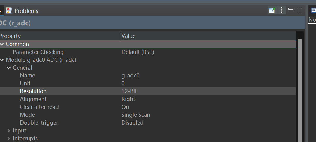

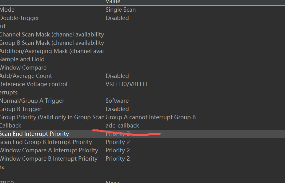

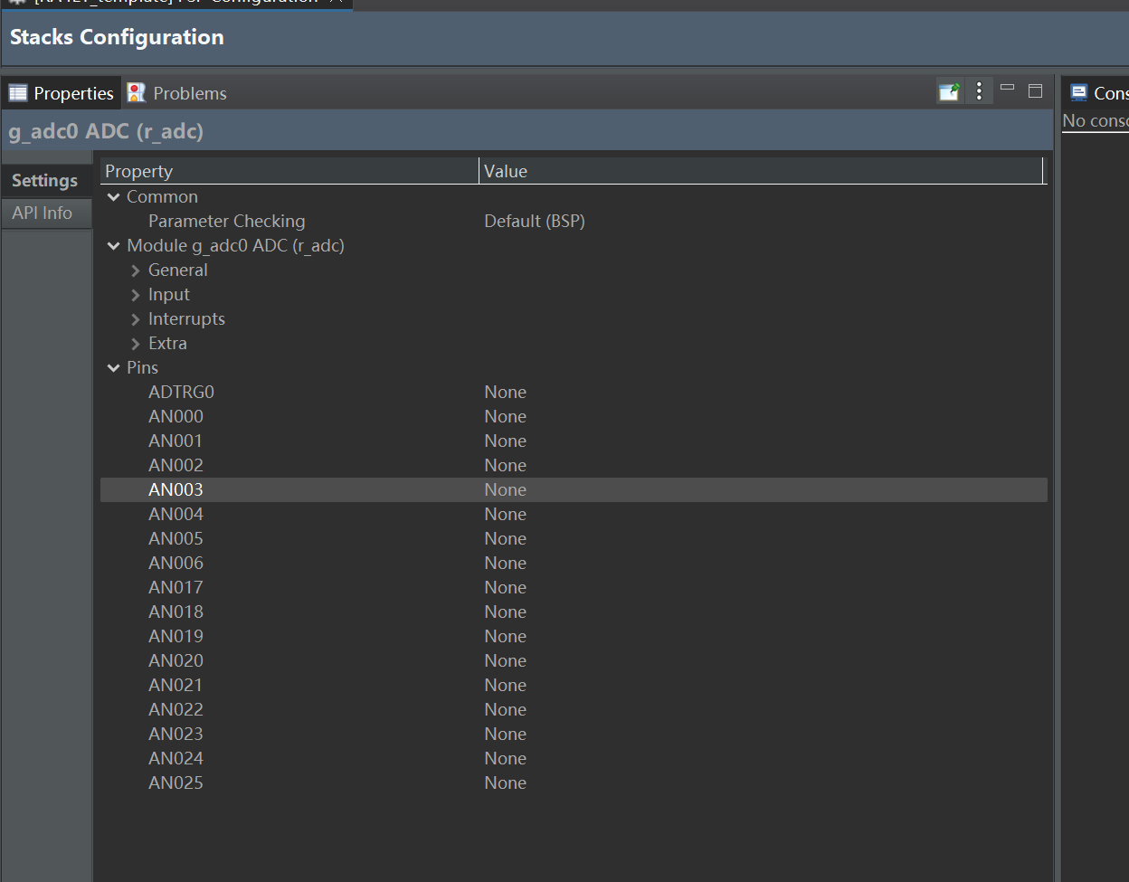

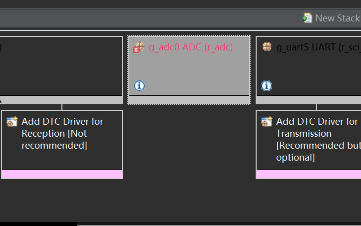

1。打开瑞萨的RA smart配置软件
配置TSN的ADC

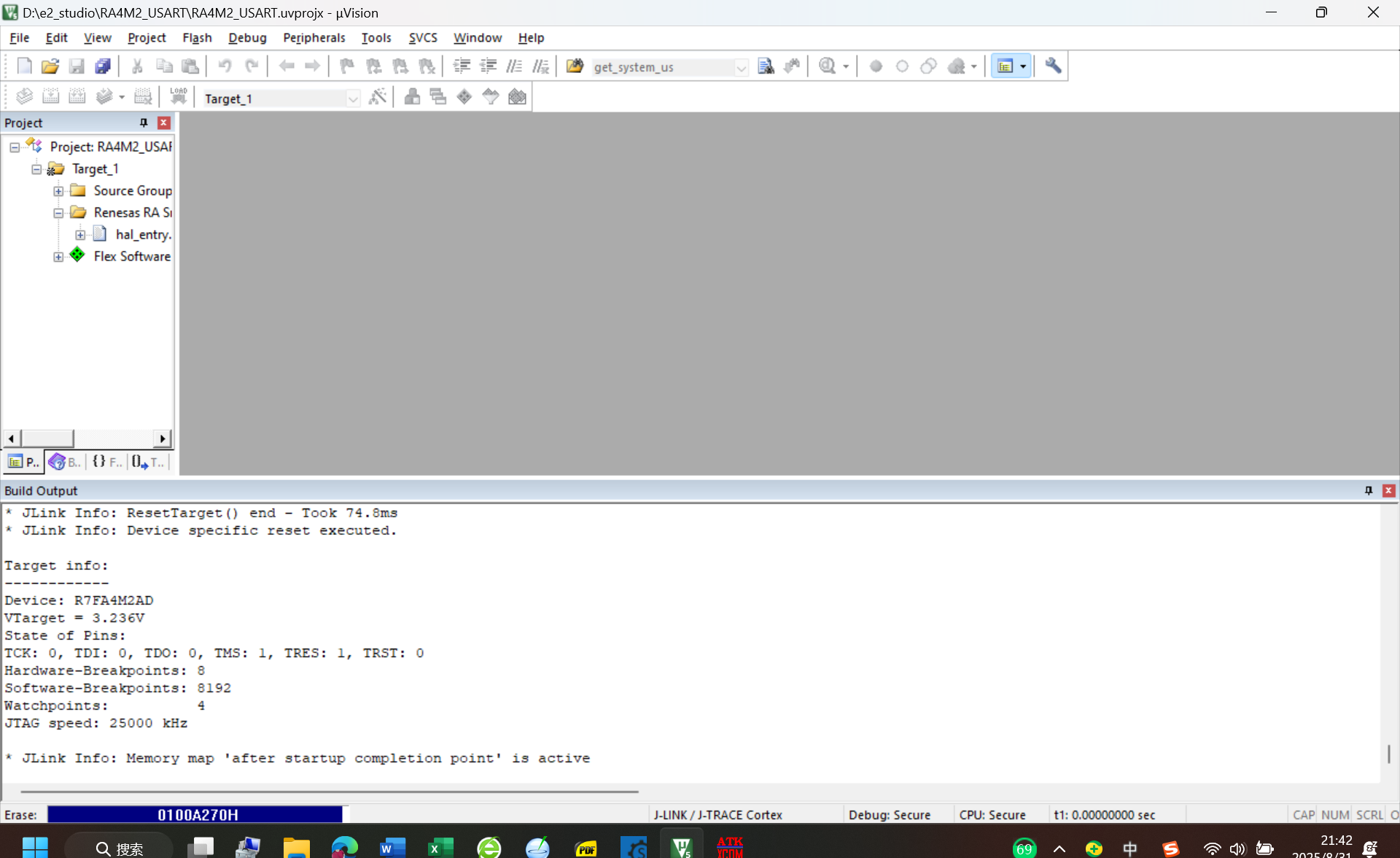

2。生成代码,打开KEIL工程
添加核心代码,计算TSN的温度

void adc_callback (adc_callback_args_t * p_args)
//宏将告知编译器回调函数不使用参数 p_args,从而避免编译器发出警告,
FSP_PARAMETER_NOT_USED(p_args);
scan_complete_flag = true;

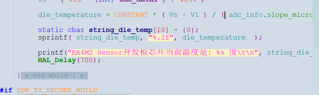

V1 = ( 3300 * (int) adc_info.calibration_data ) / 4096 ;
Vs = ( 3300 * (int) adc_data1 ) / 4096 ;
die_temperature = CONSTANT * ( Vs - V1 ) / ( adc_info.slope_microvolts ) + 127.0;
static char string_die_temp[10] = {0};
sprintf( string_die_temp, "%.2f", die_temperature );
printf("RA4M2 Sensor开发板芯片当前温度是: %s 度\r\n", string_die_temp);

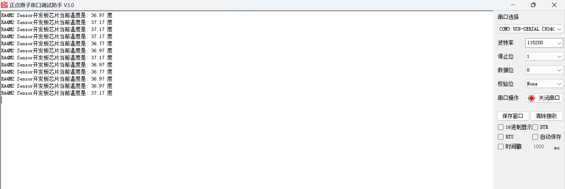

编译工程,烧录代码到板子
打开串口助手
RA4M2 Sensor开发板芯片当前温度是: 36.97 度
可以看到板子温度为36。97度
非常的准确。
