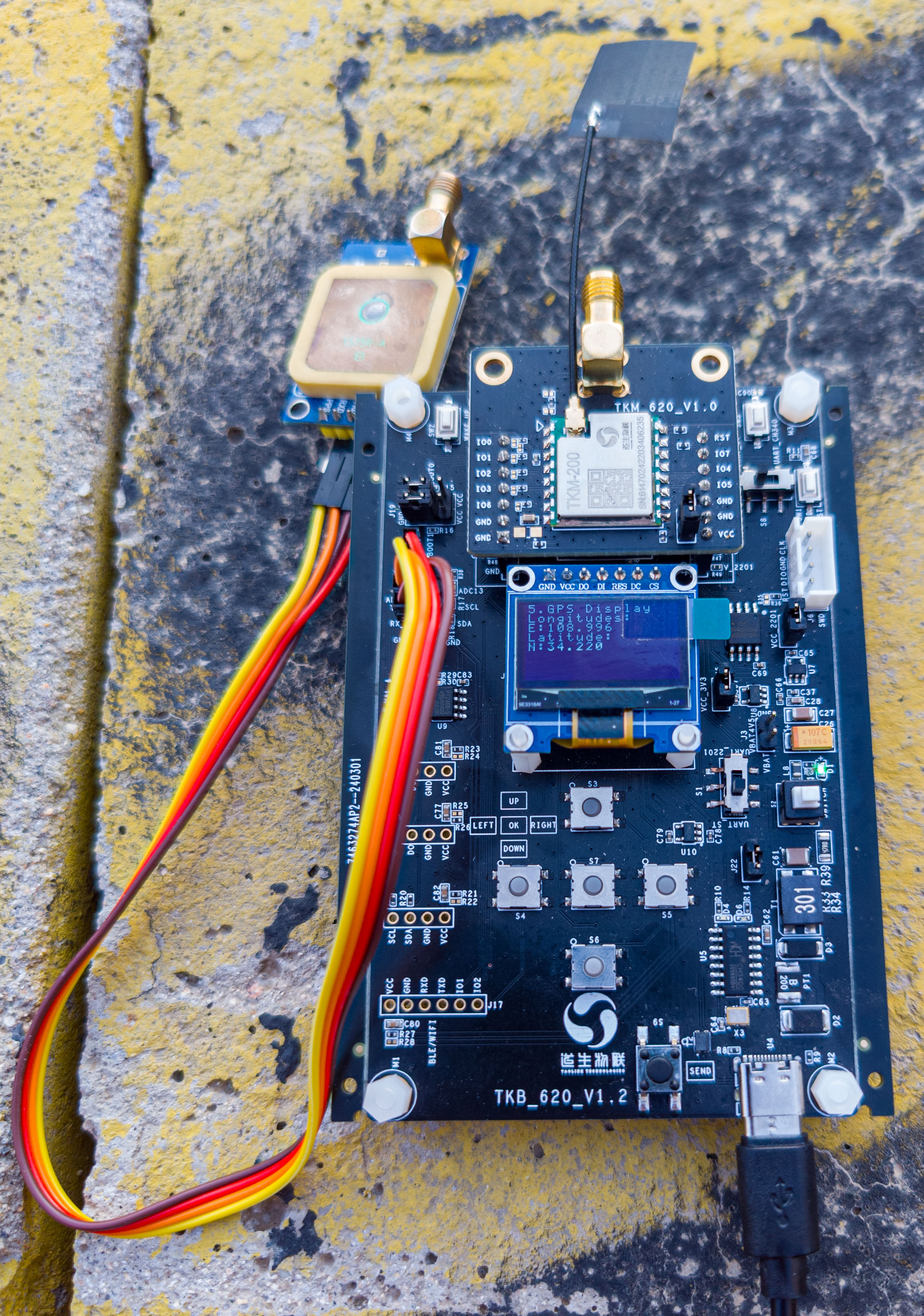

2.准备材料
TKB-620开发板*2
Ulox neo-7n8*1 ,支持nmea-183输出,使用$GPRMC定位信息
3.代码实现

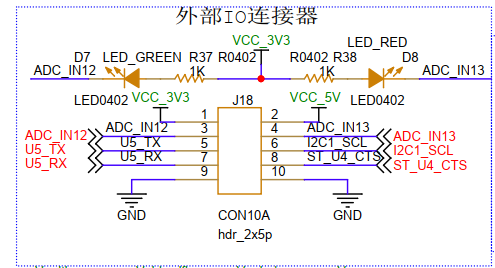

GPS模块使用开发板上STM32F103RC的UART5接口(对应开发板上的J18),注意此接口不支持DMA。

OLED菜单代码:
show_param_t show_param[] =
.screenIdx = 0,
.screen_param =
{.x_base = 0, .y_base = 0, .string = "1.Rate Mode: 6", .modifyPos = 12, .modify = 1},
{.x_base = 0, .y_base = 1, .string = " Freq:473100000", .modifyPos = 7, .modify = 1},
{.x_base = 0, .y_base = 2, .string = " Txp:15", .modifyPos = 6, .modify = 1},
{.x_base = 0, .y_base = 3, .string = " Tx Count:100", .modifyPos = 11, .modify = 0},
{.x_base = 0, .y_base = 4, .string = " WakeOnRadio:N ", .modifyPos = 14, .modify = 1},
{.x_base = 0, .y_base = 5, .string = " ", .modifyPos = 11, .modify = 0},
{.x_base = 0, .y_base = 6, .string = " ", .modifyPos = 14, .modify = 0},
{.x_base = 0, .y_base = 7, .string = " ", .modifyPos = 14, .modify = 0},
.screenIdx = 1,
.screen_param =
{.x_base = 0, .y_base = 0, .string = "2.Tx Count:100", .modifyPos = 11, .modify = 0},
{.x_base = 0, .y_base = 1, .string = " Send:0", .modifyPos = 7, .modify = 1},
{.x_base = 0, .y_base = 2, .string = " Rate Mode:13", .modifyPos = 12, .modify = 1},
{.x_base = 0, .y_base = 3, .string = " Freq:473100000", .modifyPos = 7, .modify = 1},
{.x_base = 0, .y_base = 4, .string = " Txp:15", .modifyPos = 6, .modify = 1},
{.x_base = 0, .y_base = 6, .string = " ", .modifyPos = 11, .modify = 0},
{.x_base = 0, .y_base = 7, .string = " ", .modifyPos = 11, .modify = 0},
.screenIdx = 2,
.screen_param =
{.x_base = 0, .y_base = 0, .string = "3.Rssi:-80 ", .modifyPos = 7, .modify = 0},
{.x_base = 0, .y_base = 1, .string = " Snr:20 ", .modifyPos = 6, .modify = 0},
{.x_base = 0, .y_base = 2, .string = " Rx Count:100", .modifyPos = 11, .modify = 0},
{.x_base = 0, .y_base = 3, .string = " Loss:100%", .modifyPos = 7, .modify = 0},
{.x_base = 0, .y_base = 4, .string = " Rate Mode:13", .modifyPos = 12, .modify = 1},
{.x_base = 0, .y_base = 5, .string = " Freq:473100000", .modifyPos = 7, .modify = 1},
{.x_base = 0, .y_base = 6, .string = " Txp:15", .modifyPos = 6, .modify = 1}
.screenIdx = 3,
.screen_param =
{.x_base = 0, .y_base = 0, .string = "4.RF Ver:2.0.0 ", .modifyPos = 9, .modify = 0},
{.x_base = 0, .y_base = 1, .string = " McuVer:2.0.3 ", .modifyPos = 9, .modify = 0},
{.x_base = 0, .y_base = 2, .string = " ", .modifyPos = 8, .modify = 0},
{.x_base = 0, .y_base = 3, .string = " ", .modifyPos = 9, .modify = 0}
.screenIdx = 4,
.screen_param =
{.x_base = 0, .y_base = 0, .string = "5.GPS Display ", .modifyPos = 0, .modify = 0},
{.x_base = 0, .y_base = 1, .string = "Longitudes: ", .modifyPos = 0, .modify = 0},
{.x_base = 0, .y_base = 2, .string = "Invalid", .modifyPos = 0, .modify = 0},
{.x_base = 0, .y_base = 3, .string = "Latitude:", .modifyPos = 0, .modify = 0},
{.x_base = 0, .y_base = 4, .string = "Invalid", .modifyPos = 0, .modify = 0},
