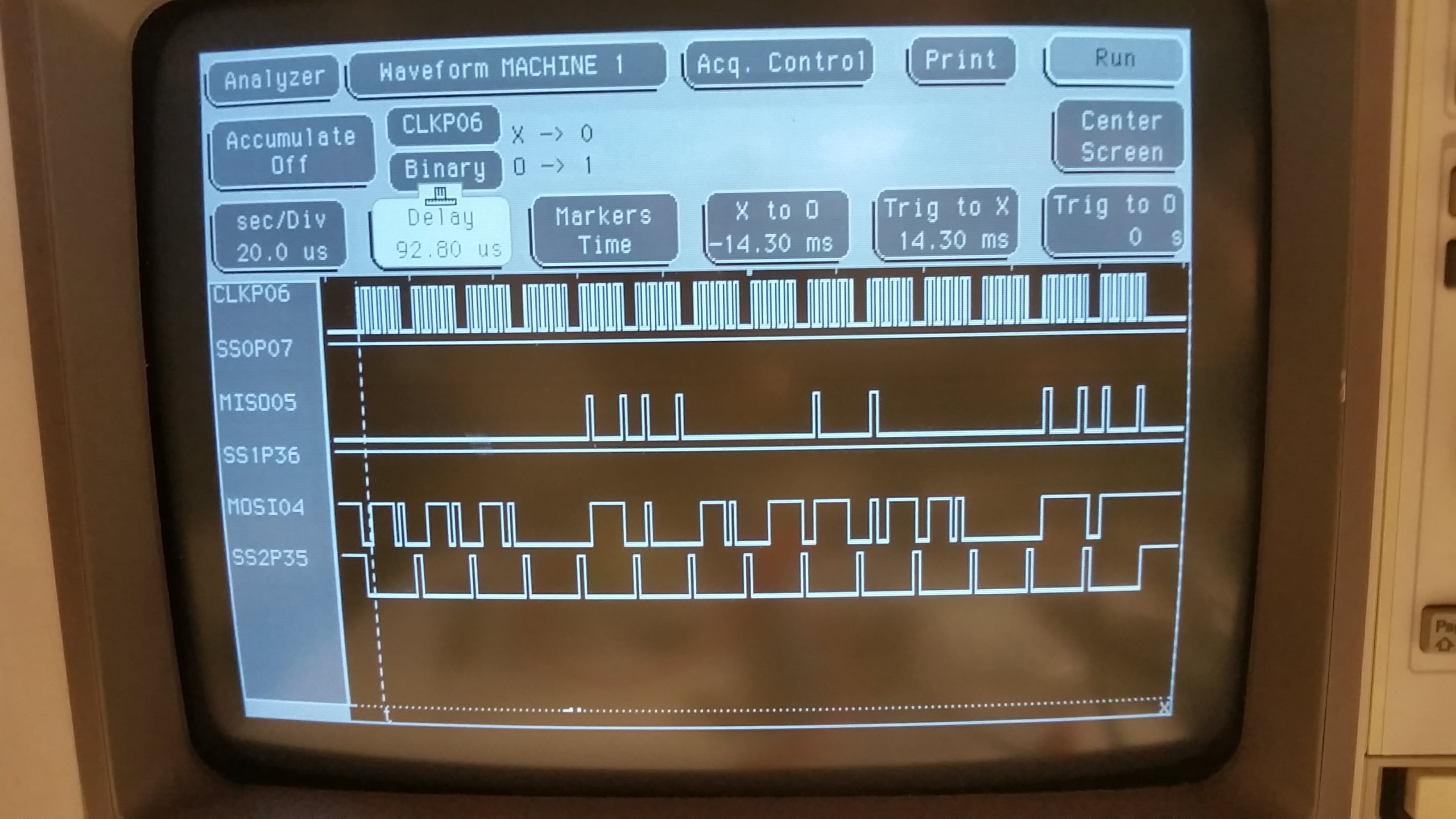

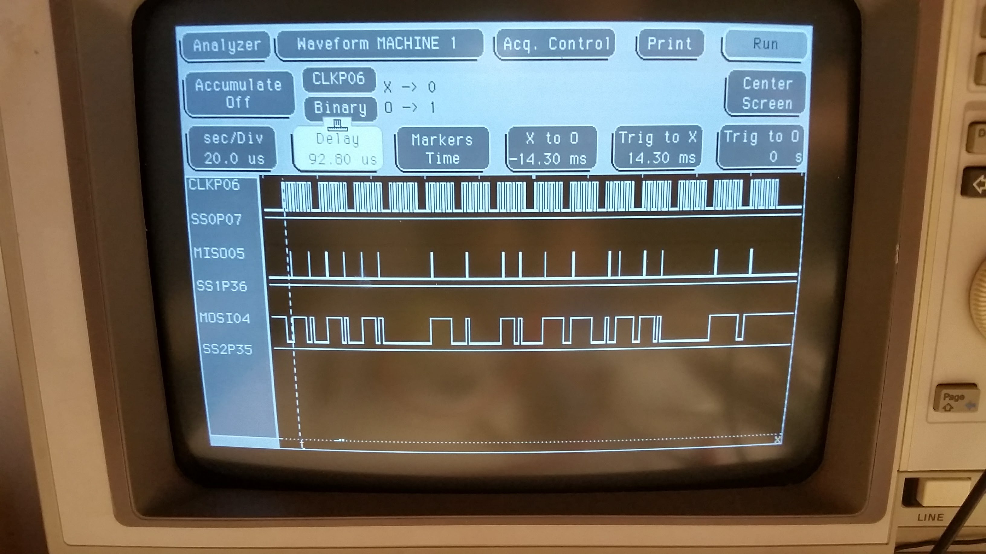

嗨,Ralf,我终于回到了一个简单的项目中,演示了SCB组件的SPI功能异常。我有三个SS线路,我的代码与CAP1128电容式感测装置对话,在SS1和SS2上碰巧有两个。在附加的项目中,我可以选择SS2上的设备,并且得到适当的通信,但是它不是SS2上的设备,而是SS1上的设备。当选择SS1时,SS波形不会发生,并且不可能进行通信。为了证明没有硬件问题防止SS1拉低,我还尝试了物理倒换硬件,以便当选择SS2时,相反的CAP1128设备连接到SS1。它也能正确通信。我还附上每个场景的波形照片(逻辑分析仪)。 20180330091127.JPG 563.5 K 20180330009065 0.JPG 576.7 K Cab-OnLo.01B.Cyrj.CaseVo.01.Zip 1.5兆字节 以上来自于百度翻译 以下为原文 Hi Ralf, I'm finally back with a simple project that demonstrates dysfunction in the SPI functionality of the SCB component. I have three SS lines and my code talks to a CAP1128 capacitive sensing device, which there happen to be two of, on SS1 and SS2. In the attached project, I can select the device on SS2 and I get proper communication, however it's not with the device on SS2, it's with the device on SS1. When I select SS1 the SS waveform does not happen, and no communication is possible. Just to prove that there is no hardware problem preventing the SS1 from pulling low, I have also tried physically reversing the hardware, so that the opposite CAP1128 device is connected to SS1 when SS2 is selected. It also communicates correctly. I'm also attaching photos of the waveforms in each scenario (on logic analyzer).

嗨,鲍伯, 问题是,CAP1128是8位,而Max 7221是16位。我猜你的想法让我怀疑我是否可以使用16位模式的上限,他们将不会看到最重要的字节。一个尝试…在此之前,我想我将建立一个我现有项目的副本,但是这次,制作Max SS2。我看到了一些其他的特点与现有的项目,它不再回应交换引脚上的上限。现在奇怪的是,CAP1128YB(U5)总是工作,尽管交换SS引脚,而CAP1128A A(U11),这原本是一个工作(在SS1),现在从来没有工作。所以我想从头开始建立起来。 再次感谢。 以上来自于百度翻译 以下为原文 Hi Bob, Problem with that is, the CAP1128's are 8-bit and the MAX7221's are 16-bit. I guess your thought makes me wonder if I can use 16-bit mode with the CAPs and they would just not see the most significant byte. One experiment to try... Before that, I think I'll build up a duplicate of my existing project, but this time, make the MAX SS2. I'm seeing some other peculiarities with the existing project, where it no longer responds to swapping the pins on the CAPs. Weird thing now is, the CAP1128_B (U5) ALWAYS works, despite swapping SS pins, and the CAP1128_A (U11), which was originally the one that worked (on SS1), now never works. So I guess a from-scratch build-up is called for. Thanks again. |
子璇ALICE 发表于 2018-11-26 18:40 OnEdAsHeTwite8TeNeNe148511SrReEB: 嗨,鲍伯, 谢谢。我更新到当前的创建者4.1,并做了组件更新,将SCB从3.2到4。虽然没有快乐。 我不熟悉你在哪里看到和看到无序的SS值。我没能找到那样的东西。听起来像是我控制之外的东西……?如果我有办法把它们整理好,我需要一些辅导。 再次感谢。 戴夫 如果你指的是我的帖子,我是Ralf =) 关于更新,可能需要删除生成的SCB API文件,因为即使更新,也可能保留SS行的值。 我在SPimySPixUART.H文件中找到了非顺序SS值: /*SPI从属选择常数*/ 定义SpimthSPILSLaveE.StReT0(SPIM1) 定义SpimthSPixSLaveSeLt1(SPIM1) 定义SpimthSPixSLaveSeLeT2(SPIM1) 定义SpimthSPixSLaveSeLeT3(SPIM1) 现在,如果您检查SPIMYSCBS*SS0PosiScript的值到SPimyScBysSS3PosiPosits,您将看到值是0, 3, 1,2。如果我正确地理解了寄存器手册,SS0到SS3的值应该是0, 1, 2和3的顺序。 在CyFiter中定义了SPIM1 SCBSH SSX定位。 在您的项目中,它们定义如下: 定义SpimaScBasys0-π0 0U 定义SpimaScbs1β3U 定义Spima Scbs2β1U 定义SpimsCbs3S3-位2U 我清理了你的项目,更新了组件,重新构建,然后检查了Cyfter。现在,结果是: 定义SpimaScBasys0-π0 0U 定义SpimsCbs1β1U 定义SpimsCbs2S2a定位2U 定义SpimsCbs3S3-π3U 当做 以上来自于百度翻译 以下为原文 onedashtwoeightone_1448511 schrieb:If you're referring to my post, I'm Ralf =) Regarding the update, maybe it's needed to delete the generated SCB API files, because even with the update it might be that the values for SS lines might be preserved. I found the non-order SS values in the SPIM_SPI_UART.H file: /* SPI slave select constants */ #define SPIM_SPI_SLAVE_SELECT0 (SPIM_SCB__SS0_POSISTION) #define SPIM_SPI_SLAVE_SELECT1 (SPIM_SCB__SS1_POSISTION) #define SPIM_SPI_SLAVE_SELECT2 (SPIM_SCB__SS2_POSISTION) #define SPIM_SPI_SLAVE_SELECT3 (SPIM_SCB__SS3_POSISTION) Now, if you check the values for SPIM_SCB__SS0_POSISTION to SPIM_SCB__SS3_POSISTION, you'll see that the values are 0, 3, 1, 2. If I understand the register manual correctly, the values for SS0 to SS3 should be 0, 1, 2 and 3 in order. SPIM_SCB__SSx_POSISTION are defined in cyfitter.h. In your project, they're defined as follows: #define SPIM_SCB__SS0_POSISTION 0u #define SPIM_SCB__SS1_POSISTION 3u #define SPIM_SCB__SS2_POSISTION 1u #define SPIM_SCB__SS3_POSISTION 2u I cleaned your project, updated the components, build again and then checked cyfitter.h. Now, the result is: #define SPIM_SCB__SS0_POSISTION 0u #define SPIM_SCB__SS1_POSISTION 1u #define SPIM_SCB__SS2_POSISTION 2u #define SPIM_SCB__SS3_POSISTION 3u Regards |
734747535qwe 发表于 2018-11-26 19:24 拉尔夫 再次感谢大家的帮助。看来你是个很好的嫌疑犯,但我现在更新了Cyfter。H按正确的顺序阅读。改变的是现在SS2确实有一个波形,但是SS1丢失了它的波形。在逻辑分析仪上再次检查。看到了一组涉及SS2的传输的漂亮波形,但不是SS1。我正在上传我的最新版本,顺便说一下,它已经不再是可引导的了。如前所述,我现在正在使用一个059工具箱调试器。 戴夫 CAP+LeDS01K.Cyrj.CaseVo.01.Zip 2.2兆字节 以上来自于百度翻译 以下为原文 Ralph, Thanks again for the help on this. Seemed like a good suspect you had, but I've now updated and cyfitter.h reads POSISTION in the right order. What changed is that now ss2 does have a waveform, but ss1 is missing its waveform. Checked it all again on the logic analyzer. Saw a beautiful set of waveforms for a transfer involving ss2, but not ss1. I'm uploading my latest, which, by the way is no longer a bootloadable. As mentioned before, I'm using an 059 kit debugger now. Dave |
