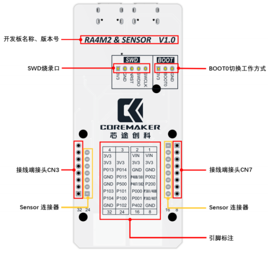

开发板正面如图:
背面如图:

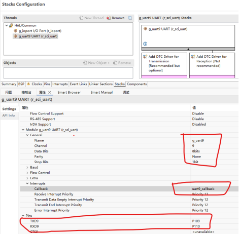

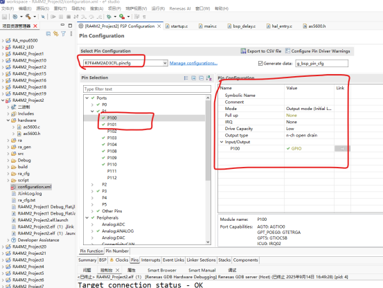

选择P100、P101为磁编码器AS5600的I2C接口的SCL与SDA引脚,选择P109与P110作为串口txd引脚和rxd引脚,新建工程选择R7FA4M2AD3CFL作为平台芯片,再进行IO和串口设置,设置串口通道9与引脚要对应,回调名以及波特率等等都需要在对话框中设置,如图:

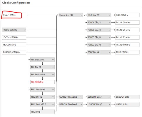

还要设置正确的时钟源,晶振要和开发板上参数一致:

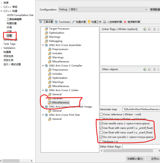

还要在编译设置中完成如下配置,右键项目进入属性界面,选择 C/C++ 构建 - 设置 - GNU Arm Cross C Linker - Miscellaneous,勾选 printf 、scanf 以及syscalls 选项:
打开串口即可使用printf函数将数据从串口发送出去:

配置I2C引脚:

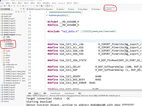

代码主要在as5600.h中进行修改:
#include "hal_data.h"
#define Sim_I2C1_SCL_LOW R_IOPORT_PinWrite(&g_ioport_ctrl, BSP_IO_PORT_01_PIN_00, BSP_IO_LEVEL_LOW)
#define Sim_I2C1_SCL_HIG R_IOPORT_PinWrite(&g_ioport_ctrl, BSP_IO_PORT_01_PIN_00, BSP_IO_LEVEL_HIGH)
#define Sim_I2C1_SDA_LOW R_IOPORT_PinWrite(&g_ioport_ctrl, BSP_IO_PORT_01_PIN_01, BSP_IO_LEVEL_LOW)
#define Sim_I2C1_SDA_HIG R_IOPORT_PinWrite(&g_ioport_ctrl, BSP_IO_PORT_01_PIN_01, BSP_IO_LEVEL_HIGH)
#define Sim_I2C1_SDA_STATE R_BSP_PinRead(BSP_IO_PORT_01_PIN_01)
#define Sim_I2C1_DELAY R_BSP_SoftwareDelay (100, BSP_DELAY_UNITS_MILLISECONDS);
#define Sim_I2C1_NOP R_BSP_SoftwareDelay (1, BSP_DELAY_UNITS_MILLISECONDS);

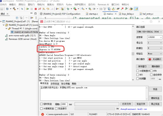

在主函数中调用以下函数测量磁编码器数据并通过串口发送:
void PrintMenu(void)
printf("AS5600 Serial Interface Programe----SC-electronic\r\n");
printf\("1 \- Set start position\\t| "\); printf\(" 6 \- get MPOS\\r\\n"\);
printf("2 - Set end position\t| "); printf(" 7 - get raw angle\r\n");
printf("3 - Set max angle range\t| "); printf(" 8 - get scaled angle\r\n");
printf("4 - Get max angle range\t| "); printf(" 9 - detect magnet\r\n");
printf("5 - Get ZPOS \t\t| "); printf("10 - get magnet strength\r\n");
printf("\r\n");
printf("Number of burns remaining: "); printf("%d\r\n",(3 - getBurnCount()));
printf("96 - Burn Angle\r\n");
printf("98 - Burn Settings (one time)\r\n");
MenuChoice = PrintInFromConsole\(\);
printf\("You choice NO\.%d programe\\r\\n",MenuChoice\);
调试结果如下:

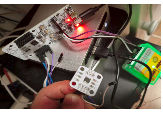

硬件实物接线如下:
