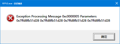

- 安装后打开
出错
- 查看安后目录有rfp-cli.exe命令行工具

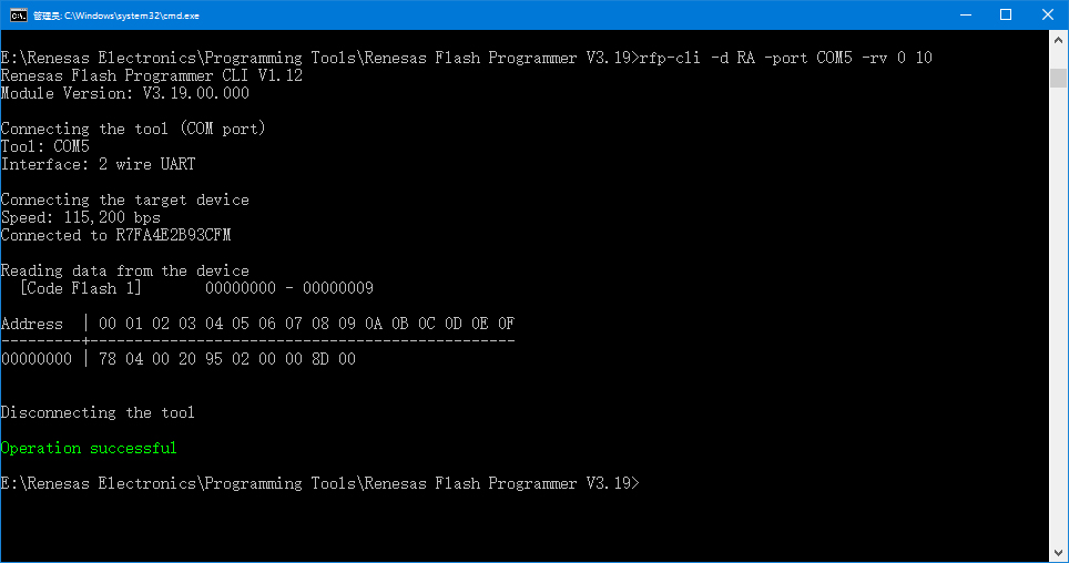

命令rfp-cli -d RA -port COM5 -rv 0 10 读取目标地址 数量数据
Renesas Flash Programmer CLI V1.12
Module Version: V3.19.00.000
Connecting the tool (COM port)
Tool: COM5
Interface: 2 wire UART
Connecting the target device
Speed: 115,200 bps
Connected to R7FA4E2B93CFM
Reading data from the device
[Code Flash 1] 00000000 - 00000009
Address | 00 01 02 03 04 05 06 07 08 09 0A 0B 0C 0D 0E 0F
00000000 | 78 04 00 20 95 02 00 00 8D 00
Disconnecting the tool
Operation successful
- 文件前16字节:78040020950200008D00000089000000
烧录数据正确,成功
