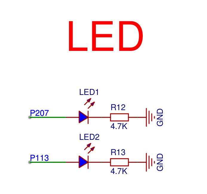

1。打开原理图,查看LED引脚
可以看到
LED1 对应P207
LED2 对应P113

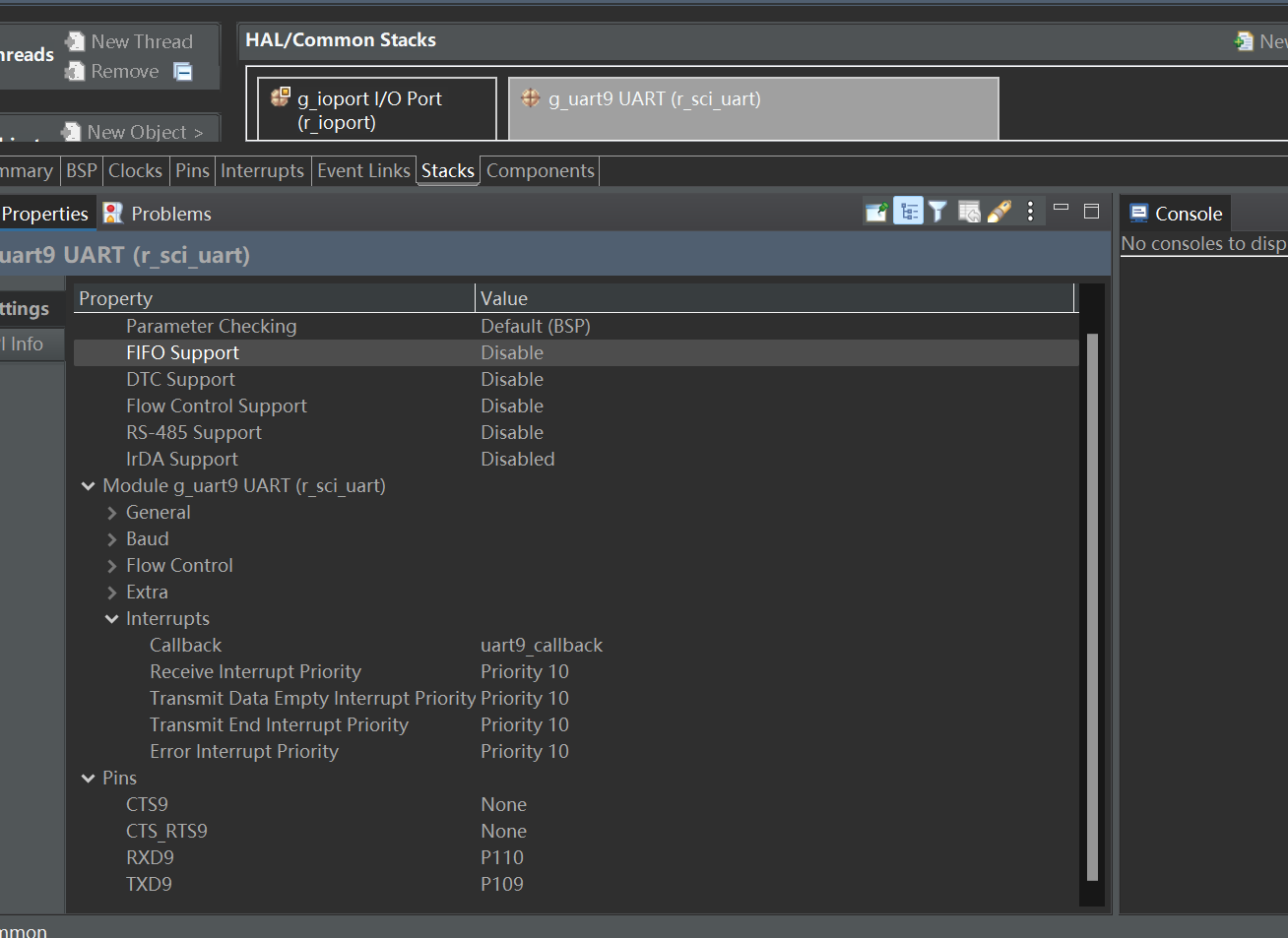

2。查看串口引脚
可以看到
RX对应P110
TX对应P109

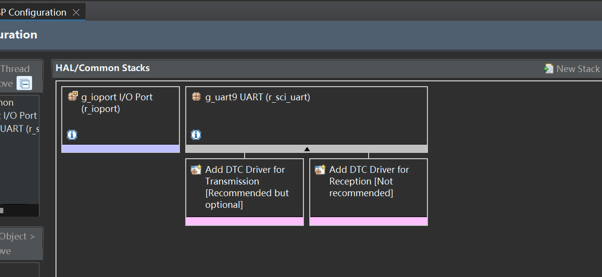

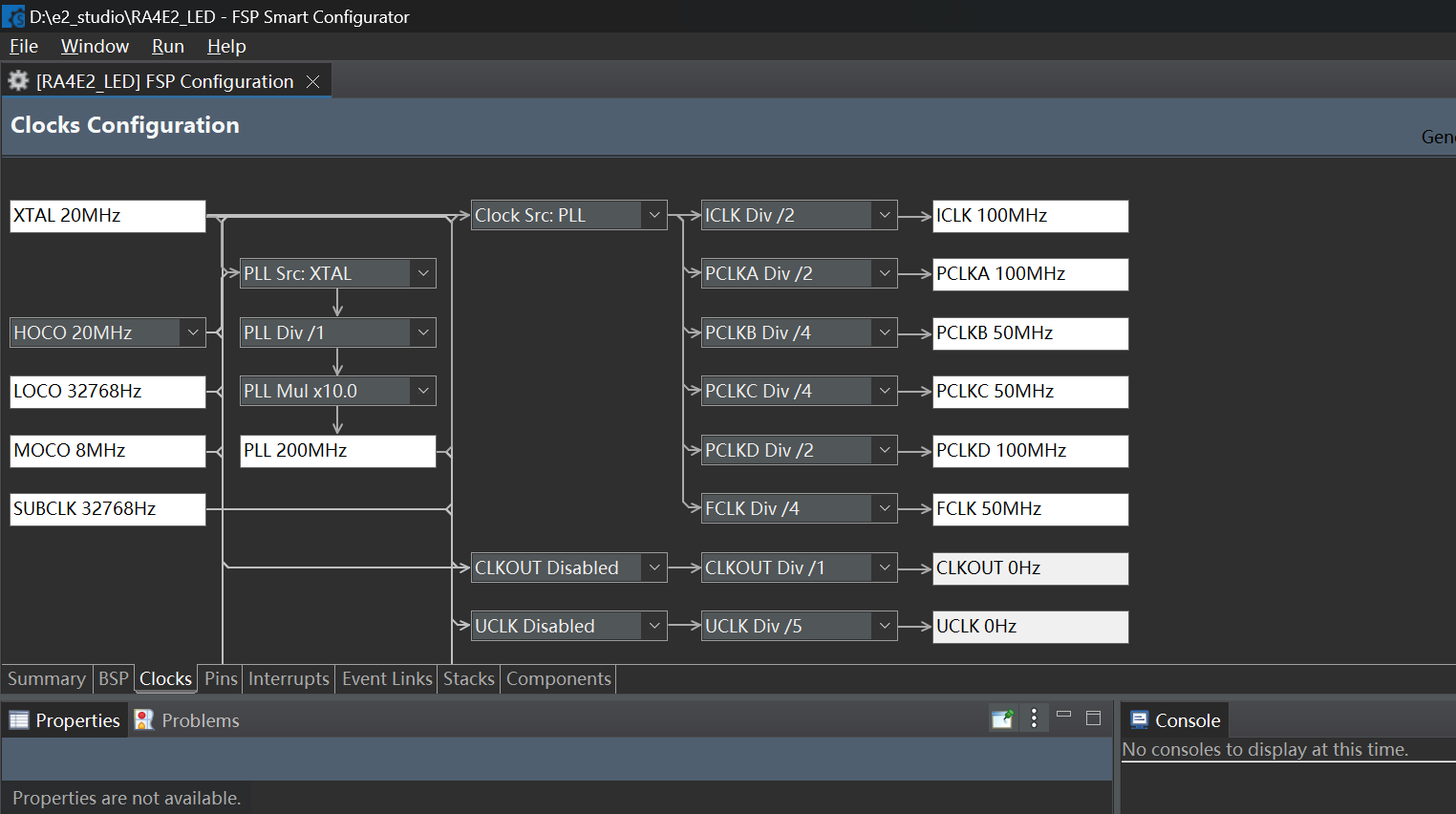

3。打开RA smart配置软件
设置时钟
4。设置usart9 串口9

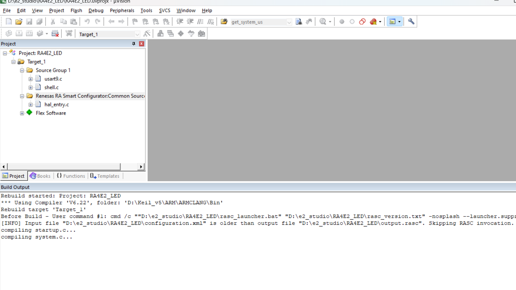

5。生成代码,打开KEIL

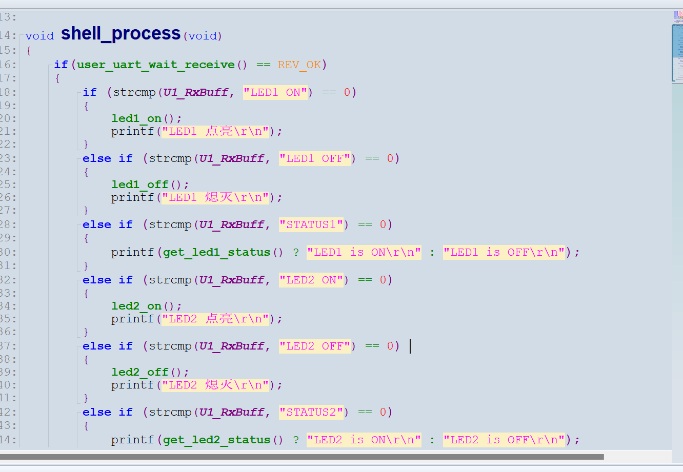

为了实现串口点灯操作,这里我实现了一个串口shell库
#include "shell.h"
#include "usart9.h"
#include <string.h>
#include <stdio.h>
#include <stdint.h>
#define CMD_LEN 64
static char cmd[CMD_LEN];
static uint8_t cmd_index = 0;
void shell_init(void) {
printf("\r\n[Embedded Shell Ready]\r\n> ");
void shell_process(void)
if(user_uart_wait_receive() == REV_OK)
if (strcmp(U1_RxBuff, "LED1 ON") == 0)
led1_on();
printf("LED1 点亮\r\n");
else if (strcmp(U1_RxBuff, "LED1 OFF") == 0)
led1_off();
printf("LED1 熄灭\r\n");
else if (strcmp(U1_RxBuff, "STATUS1") == 0)
printf(get_led1_status() ? "LED1 is ON\r\n" : "LED1 is OFF\r\n");
else if (strcmp(U1_RxBuff, "LED2 ON") == 0)
led2_on();
printf("LED2 点亮\r\n");
else if (strcmp(U1_RxBuff, "LED2 OFF") == 0)
led2_off();
printf("LED2 熄灭\r\n");
else if (strcmp(U1_RxBuff, "STATUS2") == 0)
printf(get_led2_status() ? "LED2 is ON\r\n" : "LED2 is OFF\r\n");
else if (strcmp(U1_RxBuff, "LED ON") == 0)
led1_on();led2_on();
printf("LED1 LED2 全部点亮\r\n");
else if (strcmp(U1_RxBuff, "LED OFF") == 0)
led1_off();led2_off();
printf("LED1 LED2 全部熄灭\r\n");
else if (strcmp(U1_RxBuff, "HELP") == 0)
printf("命令: LED ON, LED OFF, STATUS, HELP\r\n");
else
printf("未知命令\r\n");
user_uart_clear();
HAL_Delay(10);

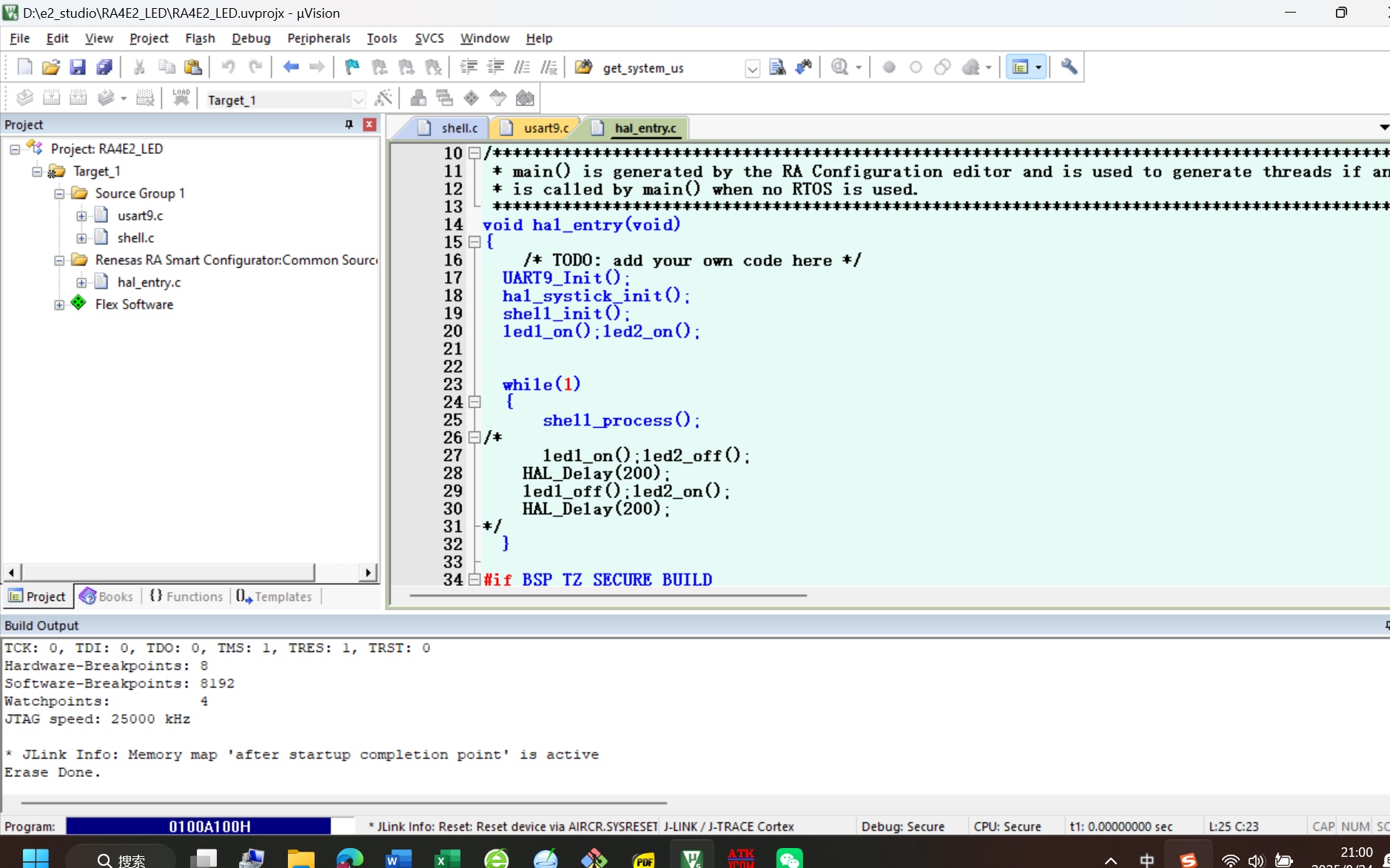

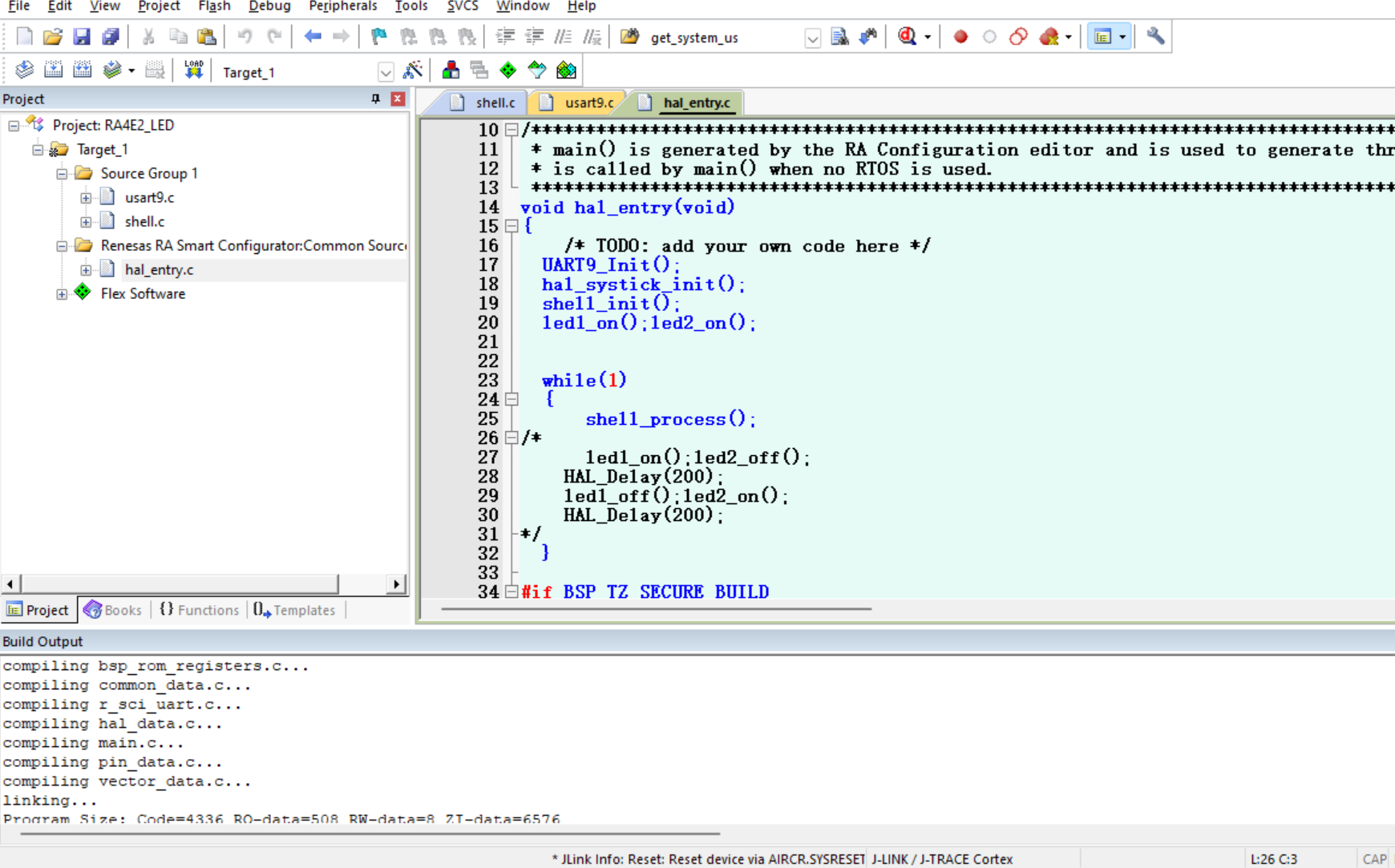

主函数如下
#include "hal_data.h"
#include "usart9.h"
#include "shell.h"
FSP_CPP_HEADER
void R_BSP_WarmStart(bsp_warm_start_event_t event);
FSP_CPP_FOOTER
main() is generated by the RA Configuration editor and is used to generate threads if an RTOS is used. This function
is called by main() when no RTOS is used.
void hal_entry(void)
/ TODO: add your own code here */
UART9_Init();
hal_systick_init();
shell_init();
while(1)
shell_process();
led1_on();led2_off();
HAL_Delay(200);
led1_off();led2_on();
HAL_Delay(200);

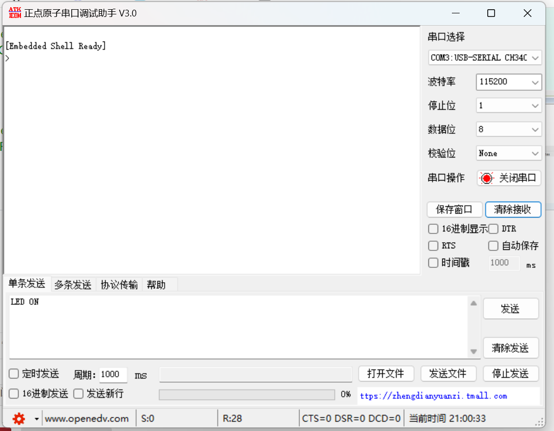

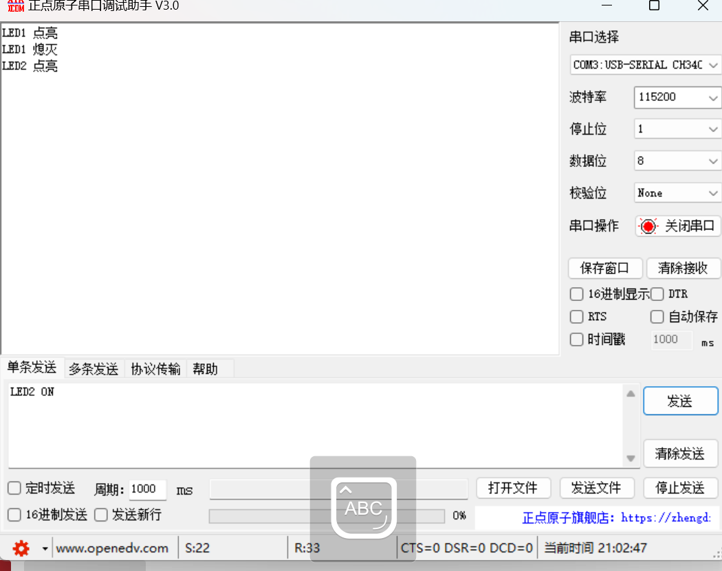

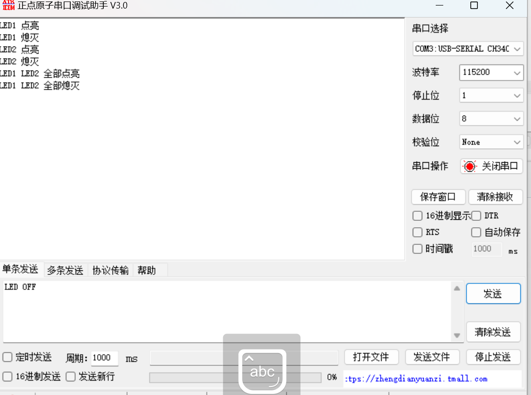

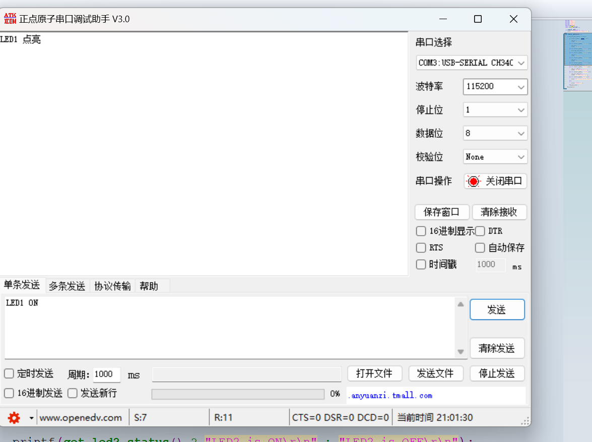

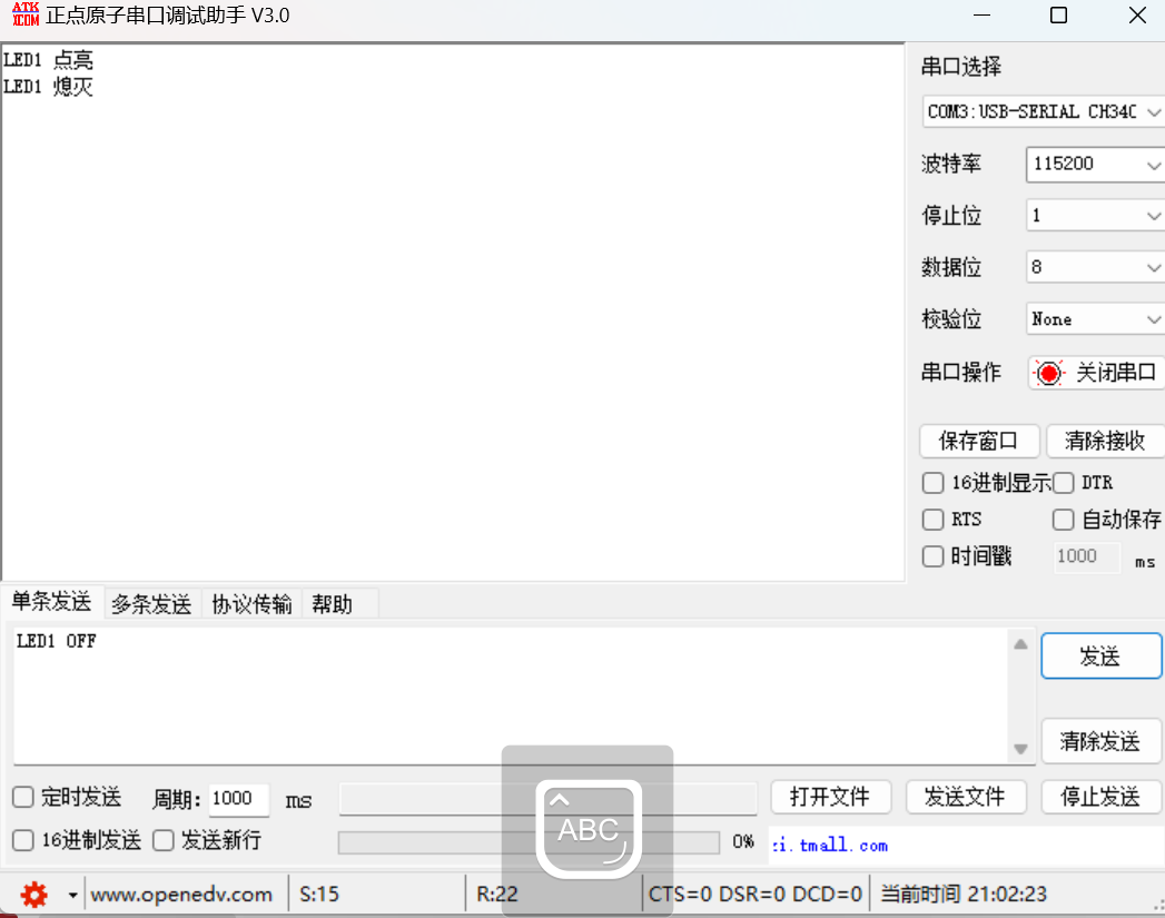

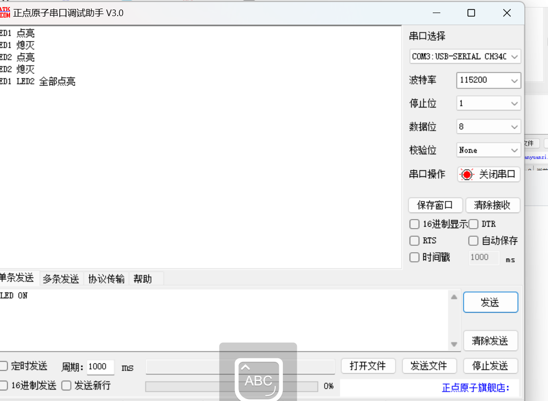

烧录代码
打开串口助手
串口shell准备完毕

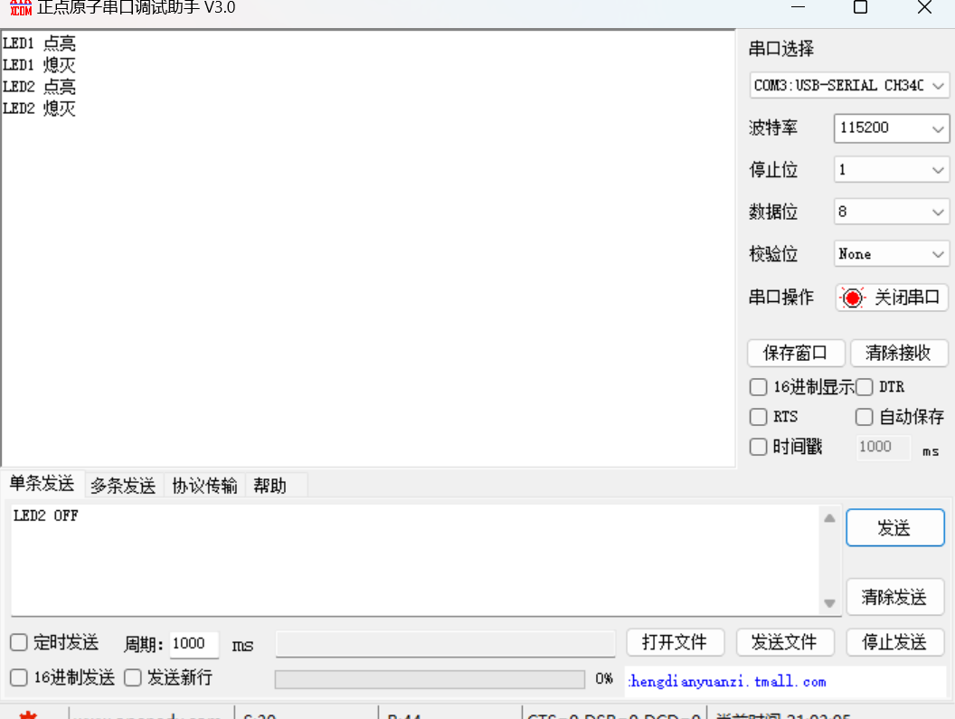

根据功能代码
1.点亮LED1
2.熄灭LED1
3.点亮LED2
4.熄灭LED2
5.点亮LED1 LED2
6.熄灭LED1 LED2
详情见视屏
