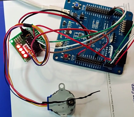

硬件连接
接线方式如下
| ULN2003 驱动板 |
RA4E2 |
说明 |
| IN1 |
P100 |
步进脉冲 A |
| IN2 |
P101 |
步进脉冲 B |
| IN3 |
P104 |
步进脉冲 C |
| IN4 |
P112 |
步进脉冲 D |
| VCC |
5V |
驱动板电源 |
| GND |
GND |
共地 |
串口通信使用板载 USB 转 TTL 工具,对应 P109 (TXD9) 和 P110 (RXD9) 引脚。

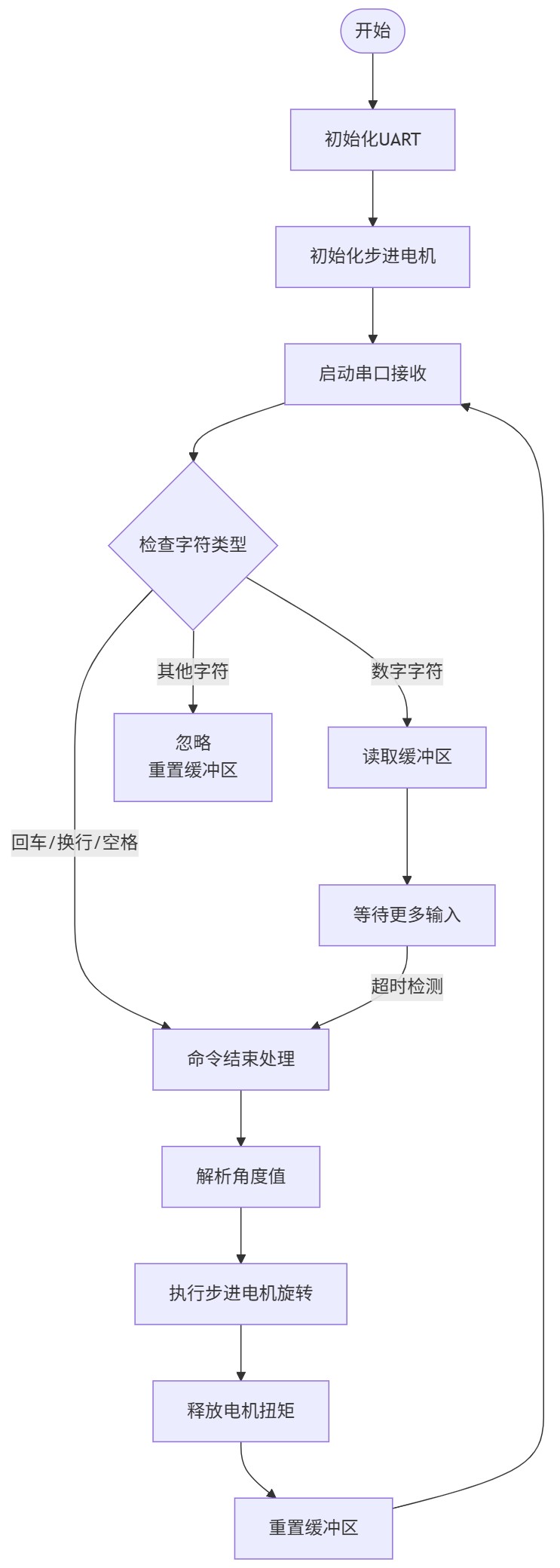

流程图

if (received_char == '\r' || received_char == '\n') {
if (g_uart_buffer_index > 0) {
g_uart_buffer[g_uart_buffer_index] = '\0';
g_uart_received = true;
g_uart_buffer_index = 0;
else if (g_uart_buffer_index < UART_BUFFER_SIZE - 1) {
g_uart_buffer[g_uart_buffer_index++] = received_char;
else {
float parse_angle_command(const char *command) {

- 28 BYJ-48 步进电机、ULN2003 驱动板、RA4E2 开发板接线硬件连接完成;
- TypeC - USB 数据线连接开发板串口和电脑;

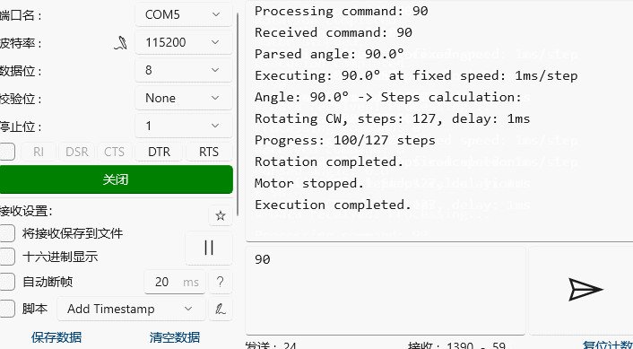

- 打开串口调试助手,配置对应的波特率等参数;
- 打开串口,即可接收芯片发送的字符串;
同时串口打印输出步进电机状态
» 90
« Data received! Processing...
Processing command: 90
Received command: 90
Parsed angle: 90.0°
Executing: 90.0° at fixed speed: 1ms/step
Angle: 90.0° -> Steps calculation:
Rotating CW, steps: 127, delay: 1ms
Progress: 100/127 steps
Rotation completed.
Motor stopped.
Execution completed.
