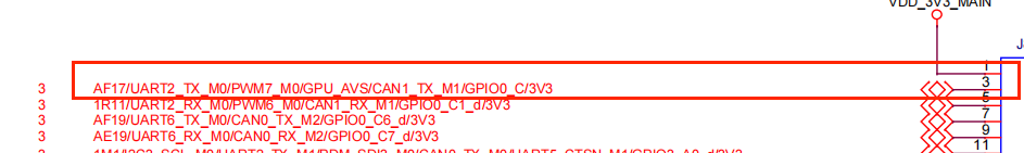

2 pwm控制

即使用pwm7m0_pins引脚配置,它在rk3562-pintrl.dtsi中定义如下
pwm7 {
/omit-if-no-ref/
pwm7m0_pins: pwm7m0-pins {
rockchip,pins =
<0 RK_PC0 2 &pcfg_pull_none_drv_level_1>;
/omit-if-no-ref/
pwm7m1_pins: pwm7m1-pins {
rockchip,pins =
<1 RK_PD4 4 &pcfg_pull_none_drv_level_1>;
即使用GPIO0_C0引脚,正好与原理图的J8_3相对应

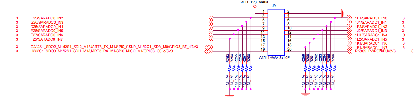

3 adc控制
3.1 配置
默认支持8通道10位的saadc,配置如下
saradc0: saradc@ff730000 {
compatible = "rockchip,rk3562-saradc";
reg = <0x0 0xff730000 0x0 0x100>;
interrupts = <GIC_SPI 40 IRQ_TYPE_LEVEL_HIGH>;
clocks = <&cru CLK_SARADC>, <&cru PCLK_SARADC>;
clock-names = "saradc", "apb_pclk";
resets = <&cru SRST_P_SARADC>;
reset-names = "saradc-apb";
status = "disabled";
对的J9如下所示
3.2 控制
root@RK3562-Tronlong:~# cd /sys/bus/iio/devices/iio
iio:device0/ iio:device1/ iio_sysfs_trigger/
root@RK3562-Tronlong:~# cd /sys/bus/iio/devices/iio:device0
root@RK3562-Tronlong:/sys/bus/iio/devices/iio:device0# ls
buffer in_voltage2_raw in_voltage6_raw of_node trigger
dev in_voltage3_raw in_voltage7_raw power uevent
in_voltage0_raw in_voltage4_raw in_voltage_scale scan_elements
in_voltage1_raw in_voltage5_raw name subsystem

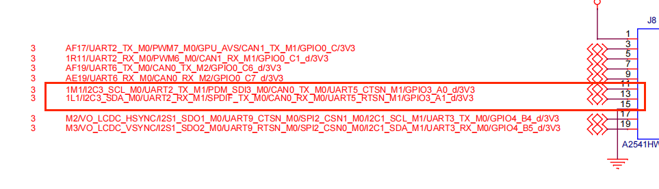

即使用i2c3m0_xfer引脚配置,它在rk3562-pintrl.dtsi中定义如下
i2c3 {
/omit-if-no-ref/
i2c3m0_xfer: i2c3m0-xfer {
rockchip,pins =
<3 RK_PA0 1 &pcfg_pull_none_smt>,
<3 RK_PA1 1 &pcfg_pull_none_smt>;
/omit-if-no-ref/
i2c3m1_xfer: i2c3m1-xfer {
rockchip,pins =
<4 RK_PA5 5 &pcfg_pull_none_smt>,
<4 RK_PA6 5 &pcfg_pull_none_smt>;
即使用GPIO3_A0和GPIO3_A1引脚,正好与原理图的J8_13/J8_15相对应
但这里有个问题,纵观整个原理图,i2c没有硬件上位,故需要修改引脚配置
/omit-if-no-ref/
rockchip,pins =
<3 RK_PA0 1 &pcfg_pull_up>,
<3 RK_PA1 1 &pcfg_pull_up>;
