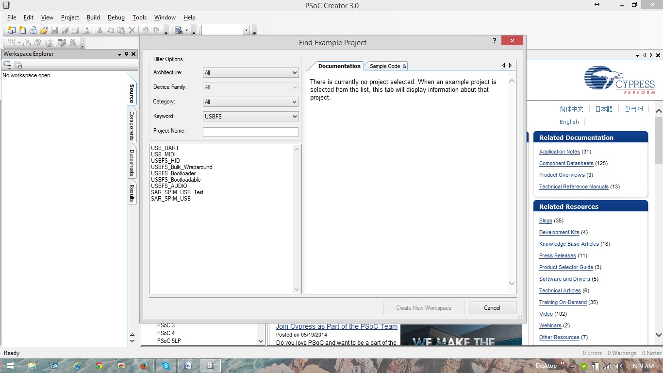

我正在尝试一个非常基本的USB实现并运行。我打算只是做一些基本的供应商特定的转移,但目前我似乎不能让USB设备枚举超过几秒钟的分数。
我的主要循环非常简单: int main(空隙){int i;CyGalAcActuabess;UBSJESTART(0,UBSJDWRYVDDDX操作);i=0;而(!)UBJGETCONtiONTION()){Pt2ReGrimeWrrad(1 & lt;& lt;i);WaIT100();I++;IF(i=8){i=0;}}Pt2ReGueRead(0);/*…*/} 现在,UBJGETCONTIONTION()永远不会返回非零,所以我坐下旋转。计算机(OSX,还尝试在Windows和Linux)显示USB设备枚举然后消失,一遍又一遍的。如果我足够快,我可以看到我的制造商名称和产品名称字符串显示在lsu***输出如此而已。 我错过了一些基本的东西吗?我研究过的例子,他们似乎做同样的事情,事实上如果我加载另一个psoc5lp演示(如PSoC 4先锋程序员源)它做同样的事情,我相信有些事不在我的船上也许是正确的。 以上来自于百度翻译 以下为原文 I'm trying to get a very basic USB implementation up and running. I intend on just doing some basic vendor-specific transfers but at the moment I can't seem to get the USB device to enumerate for more than a few fractions of a second. My main loop is very straightforward: int main(void) { int i; CyGlobalIntEnable; USB_Start(0, USB_DWR_VDDD_OPERATION); i = 0; while (! USB_GetConfiguration()) { Port2Reg_Write(1 << i); wait100(); i++; if (i == 8) { i = 0; } } Port2Reg_Write(0); /* ... */ } Right now, USB_GetConfiguration() never returns nonzero so I sit and spin. The computer (OSX, also tried on Windows and Linux) shows the USB device enumerating and then disappearing, over and over again. If I am quick enough I can see that my manufacturer name and product name strings show up in lsu*** output but that's it. Is there something basic I'm missing? I have studied the examples and they seem to do the same thing, and in fact if I load one of the other PSoC5LP demos (such as the PSoC 4 Pioneer programmer source) it does the same thing, leading me to believe that something isn't correct perhaps on my board. |

您知道创建者起始页面上的示例项目链接吗?
“查找示例项目” 问候,Dana。 以上来自于百度翻译 以下为原文 You are aware of the example projects link on Creator Start page ? "Find Example Project" Regards, Dana. |

我已经看过例子项目,尝试了一些,他们做了同样的事情,这就是为什么我怀疑我忘记了从硬件方面的东西,但我不知道它是什么。USB D+/D -通过22欧姆电阻,PSoC5LP是从它自己的3.3V电源供电的VDDD和VDDA,其他PSoC功能工作精细(I/O,定时器等),但我似乎不能得到USB枚举和保持枚举。 以上来自于百度翻译 以下为原文 The while (1) { ... }; was left out (it was after the while (! USB_GetConfiguration()) { ... }; loop that never exits. I've looked at the example projects and tried a few, they do the same thing, which is why I'm suspecting that I'm forgetting something from the hardware side of things, but I'm at a loss as to what it is. USB D+/D- through 22 ohm resistors, PSoC5LP is powered from its own 3.3V supply on both VDDD and VDDA, other PSoC functions work fine (I/O, timers, etc.) but I can't seem to get USB to enumerate and stay enumerated. |
