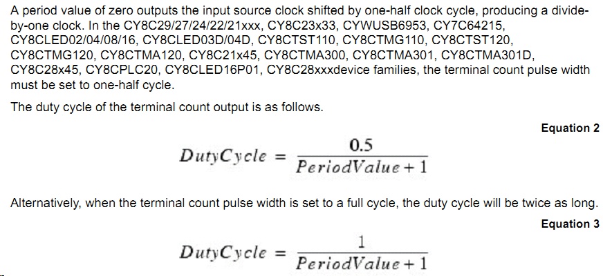

我对此表示纠正,RJVB是正确的。它需要一个周期=0和TC=1/2个时钟。
产生50%/1波形。只发生在TC输出上,比较是 无关紧要。 数据表在将TC置于1时钟的部分中有点误导性,导致一个 相信/ 1个话题仍然是相关的。 问候,Dana。 以上来自于百度翻译 以下为原文 I stand corrected on this, rjvb is correct. It takes a Period = 0 and Tc = 1/2 clock to produce a 50% /1 waveform. That occurs only on Tc output, compare out is irrelevant. Datasheet is a tad misleading in the section of placing Tc at 1 clock, leads one to believe /1 topic still relevant. Regards, Dana. |
我读这篇文章越多,就越困惑。
0的周期值将输入源时钟移位半个时钟周期,产生一个分频时钟。/ 27/24/22/21xxx,CYWSb6953,CYWS6C6215,CY8CYD02/03/04D,CY8CYD03/04D,CY8CTM110,CY8CTM110,CY8CTM120,CY8CTMA120,CY8C21X45,CY8CTMA300,CY8CTMA301,CY8CTMA301D,CY8CXX45,CY8CPLC20,CY8CYLD16P01,CY8C28 XXX设备系列,终端计数脉冲W在CY8C29中IDTH必须设置为半个周期。 这是否意味着,因为它列出了特定的部分,Tc必须设置为1/2,TC可以是1个时钟的部分吗? 问候,Dana。 以上来自于百度翻译 以下为原文 The more I read this section, the more confusing it is - A period value of zero outputs the input source clock shifted by one-half clock cycle, producing a divide- by-one clock. In the CY8C29/27/24/22/21xxx, CY8C23x33, CYWUSB6953, CY7C64215, CY8CLED02/04/08/16, CY8CLED03D/04D, CY8CTST110, CY8CTMG110, CY8CTST120, CY8CTMG120, CY8CTMA120, CY8C21x45, CY8CTMA300, CY8CTMA301, CY8CTMA301D, CY8C28x45, CY8CPLC20, CY8CLED16P01, CY8C28xxxdevice families, the terminal count pulse width must be set to one-half cycle. Does that mean, since it listed specific parts, Tc had to be set to 1/2, that there are parts that Tc can be 1 clock ? Regards, Dana. |
