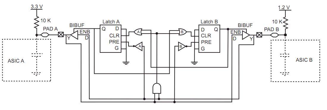

它是可能的实施与本岗位上PSoC3双向移位电路?如果是,我们将能够建立一个组件在它周围的创造者。 该组件将起翻译的水平双向信号线(SDA和SCL线I2C I2C实例)从一个电压等级的其他消除在设计一个电平转换芯片的需要。(翻译水平可以达到这个路由双向线从一个象限其他象限不同电压供电) 当做, 库里安波兰干 BigRealStudialLealTraceTracel.JPG 40.1 K 以上来自于百度翻译 以下为原文 All, Is it possible to implement the bidrectional shift circuit attached with this post in PSoC3 ?. If yes, we will be able to build a component around it in Creator. This component will faciliate level translating bidrectional signal lines (example I2C SDA and I2C SCL lines) from one voltage level to the other eliminating the need for a level translator chip in the design. (level translation can be acheived by routing the bidrectional lines from one quadrant to the other, quadrants powered at different voltage) Regards, Kurian Polachan |

在某种程度上,“水平翻译”对于PSoC 3来说并不难。
既然所有的VDDIOs都可以被赋予不同层次的能量,你就可以“翻译水平”,如果你想,或者消除所有需要的话。 以上来自于百度翻译 以下为原文 well,"level translation" isnt that difficult with the PSoC 3,in a way. Since all VDDIOs can be indiviually powered to different levels,you can always "translate levels" if you want to,or eliminate that need all together. |
是的虽然水平过渡是容易使用vddios PSoC3,双向线绝对是棘手的。
他们确实需要从两个引脚的三态控制。这可以通过两个双向引脚相连的数字逻辑控制他们的状态来实现的。逻辑将保持类似于第一岗位说明。 以上来自于百度翻译 以下为原文 Yeah though level transistion is easy on PsoC3 using the Vddios, the Bidirectional lines are definetely tricky. They do require a tristate control from either pins. This can be achieved by having two bidirectional pins connecting each other with digital logic to control thier states. The logic would remain similar to the one explained in the first post. |
“是的,虽然在PSoC3上使用VDDIOS很容易实现水平转换,但是双向线是非常棘手的。
他们确实需要从两个引脚的三态控制。这可以通过使两个双向引脚与数字逻辑相互连接来控制它们的状态来实现。逻辑将与第一篇文章中解释的逻辑相似。 我同意以上观点。我们为什么不想想给这个逻辑作为一个PSoC Creator元件,这肯定会帮助客户。 这有什么输入吗? 当做, 库里安波兰干 以上来自于百度翻译 以下为原文 "Yeah though level transistion is easy on PsoC3 using the Vddios, the Bidirectional lines are definetely tricky. They do require a tristate control from either pins. This can be achieved by having two bidirectional pins connecting each other with digital logic to control thier states. The logic would remain similar to the one explained in the first post." I agree with the above. Why don't we think about giving this logic as a PSoC Creator component, this will definitely help customers. Any inputs on this ? Regards, Kurian Polachan |
