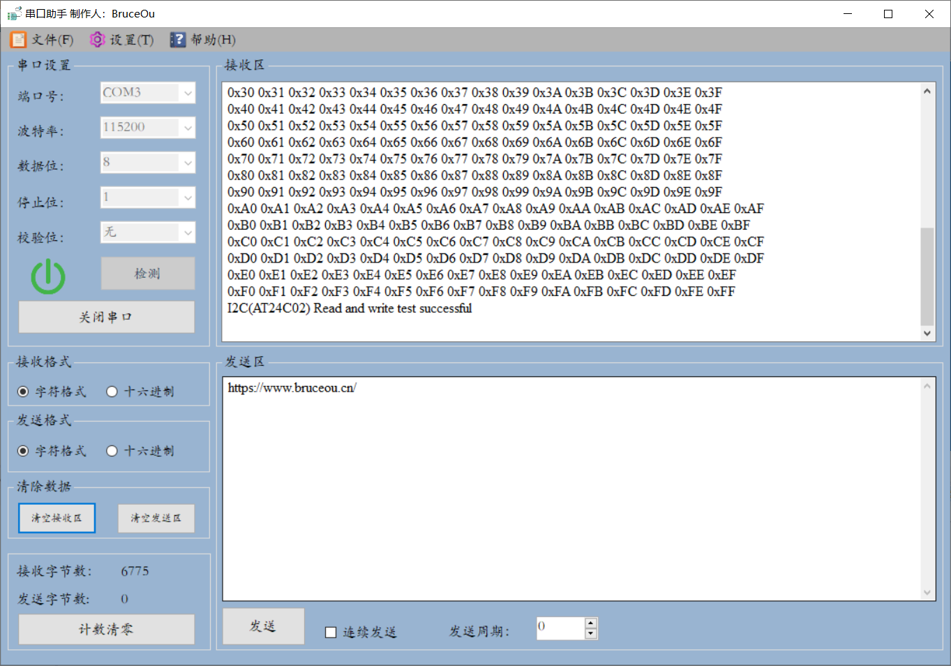

很简单,往AT24C02中写入数据,然后再读取数据,读写测试的函数如下:
  * @brief  I2C(AT24C02)读写测试
  * @param  无
  * @retval 无
void I2C_Test(void)
    uint16_t i;
    printf("Write data\r\n");
    for ( i=0; i<=255; i++ ) //填充缓冲
        I2c_Buf_Write[i] = i;
        printf("0x%02X ", I2c_Buf_Write[i]);
        if(i%16 == 15)
            printf("\n\r");
    //将I2c_Buf_Write中顺序递增的数据写入EERPOM中
    I2C_EE_BufferWrite( I2c_Buf_Write, EEP_Firstpage, 256);
    printf("\r\nWrite success\r\n");
    printf("\r\nRead data\r\n");
    //将EEPROM读出数据顺序保持到I2c_Buf_Read中
    I2C_EE_BufferRead(I2c_Buf_Read, EEP_Firstpage, 256);
    //将I2c_Buf_Read中的数据通过串口打印
    for (i=0; i<256; i++)
        if(I2c_Buf_Read[i] != I2c_Buf_Write[i])
            printf("0x%02X ", I2c_Buf_Read[i]);
            printf("Error: Inconsistent data between I2C EEPROM writing and reading\n\r");
            return;
        if(i%16 == 15)
            printf("\r\n");
    printf("I2C(AT24C02) Read and write test successful\r\n");
4.2 实验现象
下载好程序后,打开串口助手,可以看到如下信息。
Figure 4‑5 硬件I2C实现现象
