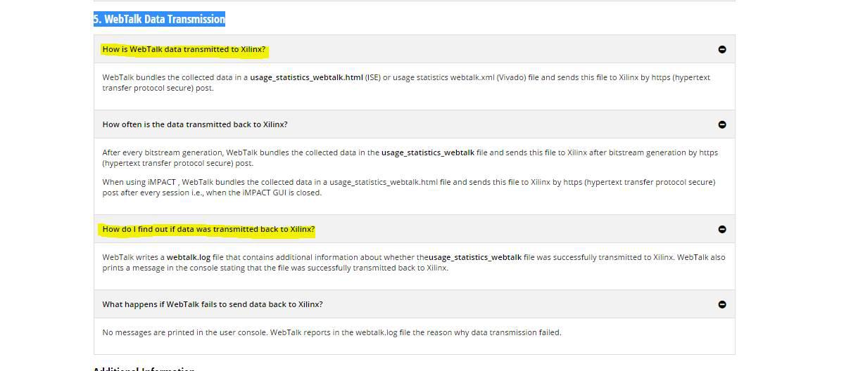

Hello @eml,
Vivado normally produces an INFO with something like this:"WebTalk data collection is mandatory when using a WebPACK part without a full Vivado license. To see the specific WebTalk data collected for your design, open the usage_statistics_webtalk.html or usage_statistics_webtalk.xml file in the implementation directory."
So, if you are targeting a WebPACK device and don’t actually have a full license, the data transmission is always turned on for the Vivado WebPACK tools, no matter what setting you have in your case, as these would be ignored (see the table below). As this is a free software, that is how it works in this environment, as it is a part of terms and conditions that are set by marketing.
“No data is sent if you disable WebTalk, except for the use of the WebPACK license to generate a bit
stream”.
Here is some info in relation to WebTalk that can be found here:
https://www.xilinx.com/products/design-tools/webtalk.html
One of the points on this page is this one:
Is WebTalk always enabled for WebPACK license?
Yes. WebTalk makes decisions on data transmission based on the license used for bitstream generation, and data transmission is always turned on for the free ISE and Vivado WebPACK tools. However, please note that WebTalk will not interfere with or prevent design compilation on a machine that is not connected to the internet.

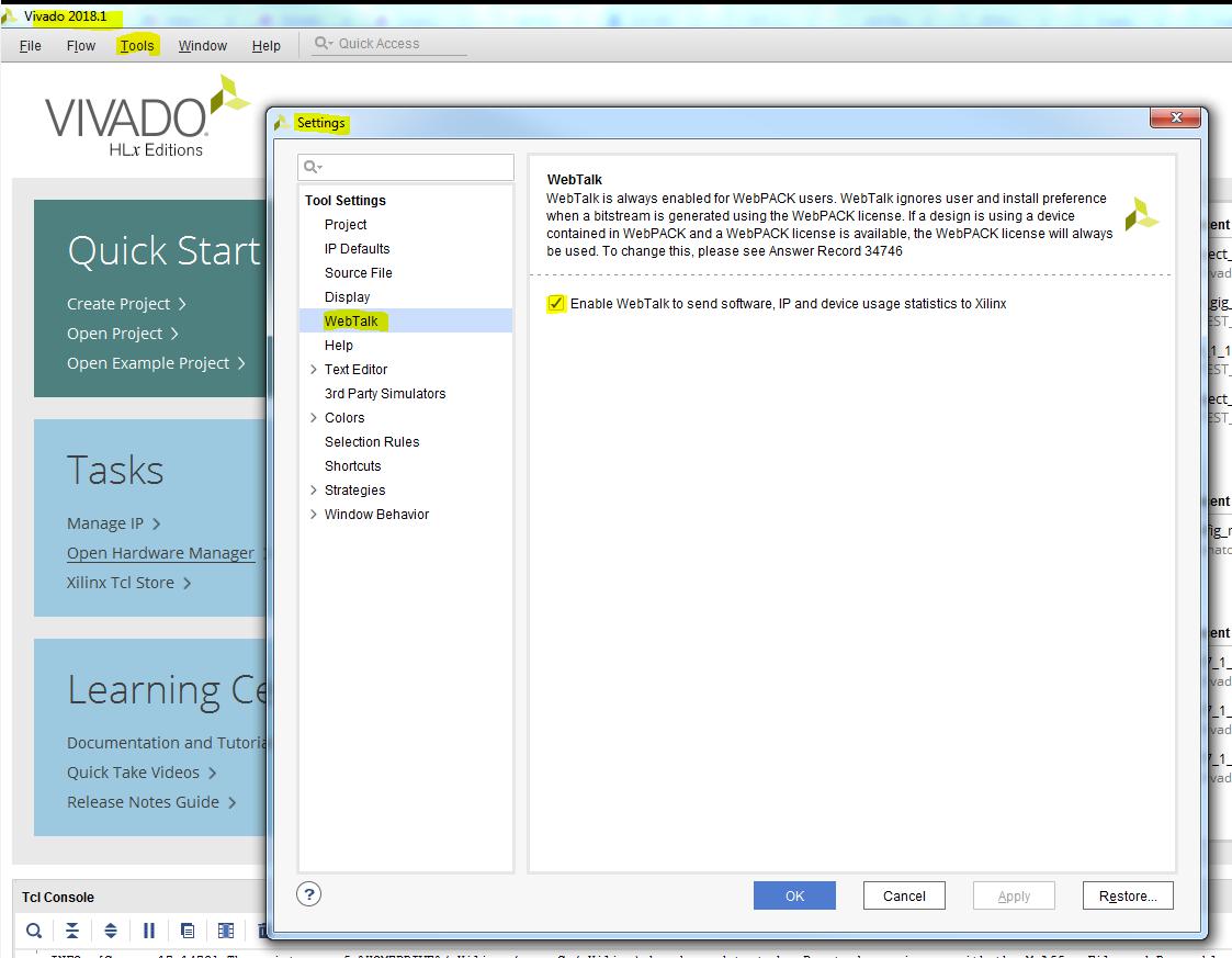

Hello @eml,
For any other Vivado flow (apart from Bitstream Generation or Route Design Flow), then you can disable the WebTalk Install Preference or the WebTalk User Preference (see Chapter4: 'WebTalk' of UG973: https://www.xilinx.com/support/documentation/sw_manuals/xilinx2018_1/ug973-vivado-release-notes-install-license.pdf on how to set or unset these) and that way the webtalk data won't get sent out.
In Vivado tool, if you open the GUI, then Tools->Settings, in here WebTalk can be selected/unselected that way:
For more info, please see UG973 (v2018.1).
Hope this helps.
