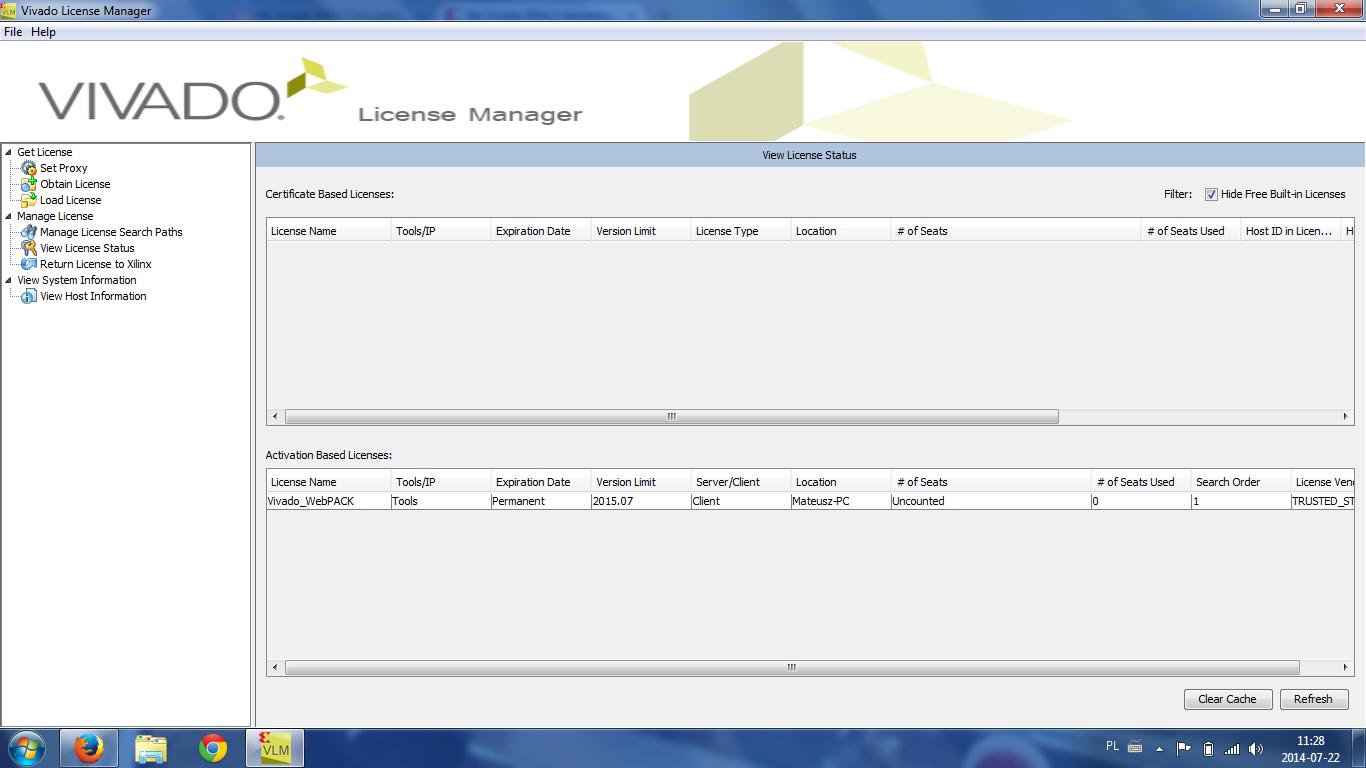

你能发布显示许可功能的VLM截图吗?
看到你的许可证文件也很好。

Can you post the screenshot of VLM which shows the licensing features?
It's also good to see your license file.

您好,感谢您的快速回复。
@gszakacs
不,我从未在此主机上获得任何评估许可。
下面是VLM的截图,现在只有一个许可证(之前还有来自Vivado Webpack的“认证”窗口中的ISE包),其“搜索顺序”值为1。
@graces
以下是VLM的截图和我的许可文件作为附件。

Hello, thank you for your quick reply.
@gszakacs
No, i have never had any evaluation license on this host. Below there is a screenshot from VLM, now there is only one license (earlier there was also ISE pack, in "certified" window) from Vivado Webpack with "search order" value 1.
@graces
Here is screenshot from VLM and my license file as attachment.

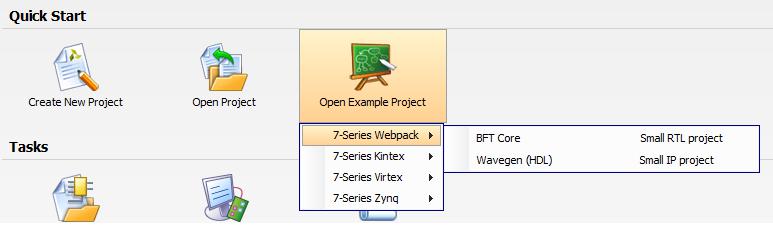

嗨,你能在webpack设备上运行模拟吗?
您可以通过在任何示例设计上运行模拟来确认,如下所示:谢谢,Vinay

Hi,
Are you able to run simulation on webpack devices. You can confirm by running simulation on any example design as shown below:
Thanks,
Vinay
