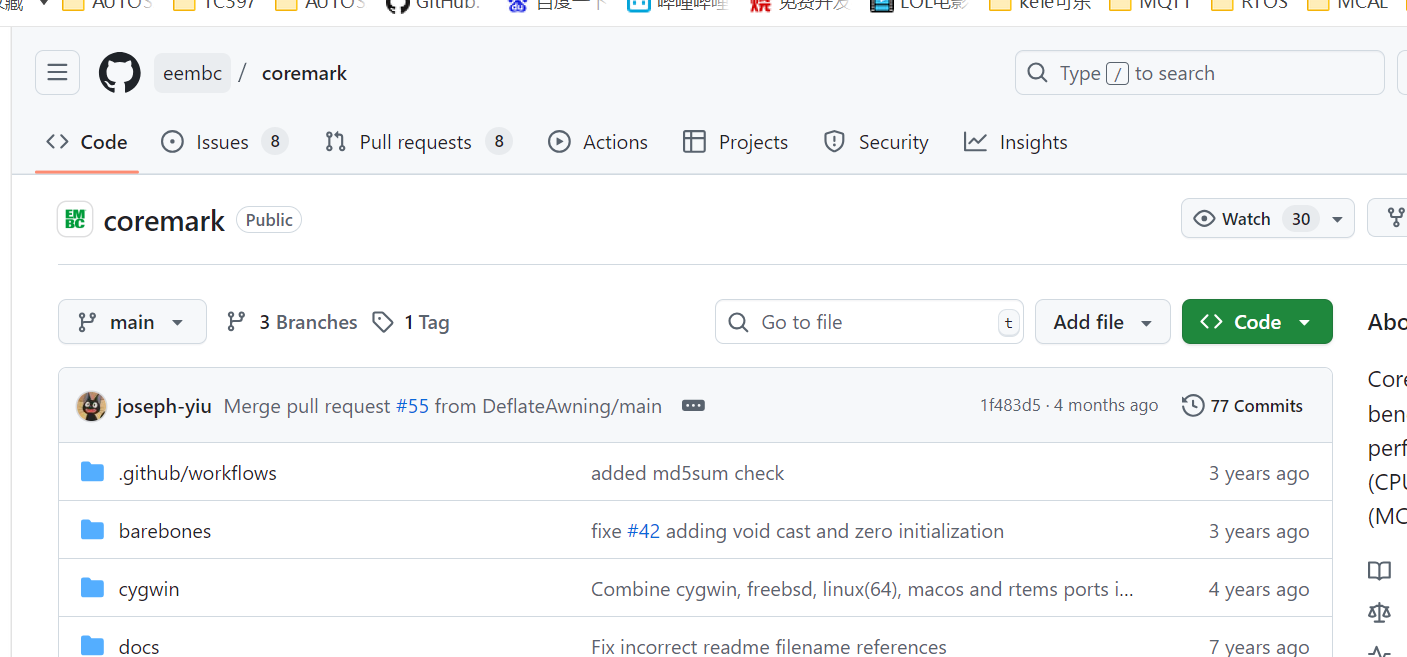

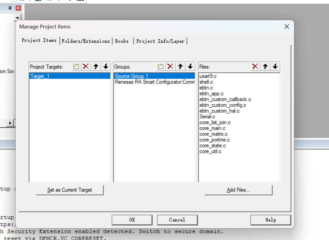

1。首先从coremark官网下载coremark源码。

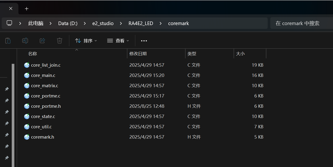

2。下载后,复制下面文件到一个文件夹内

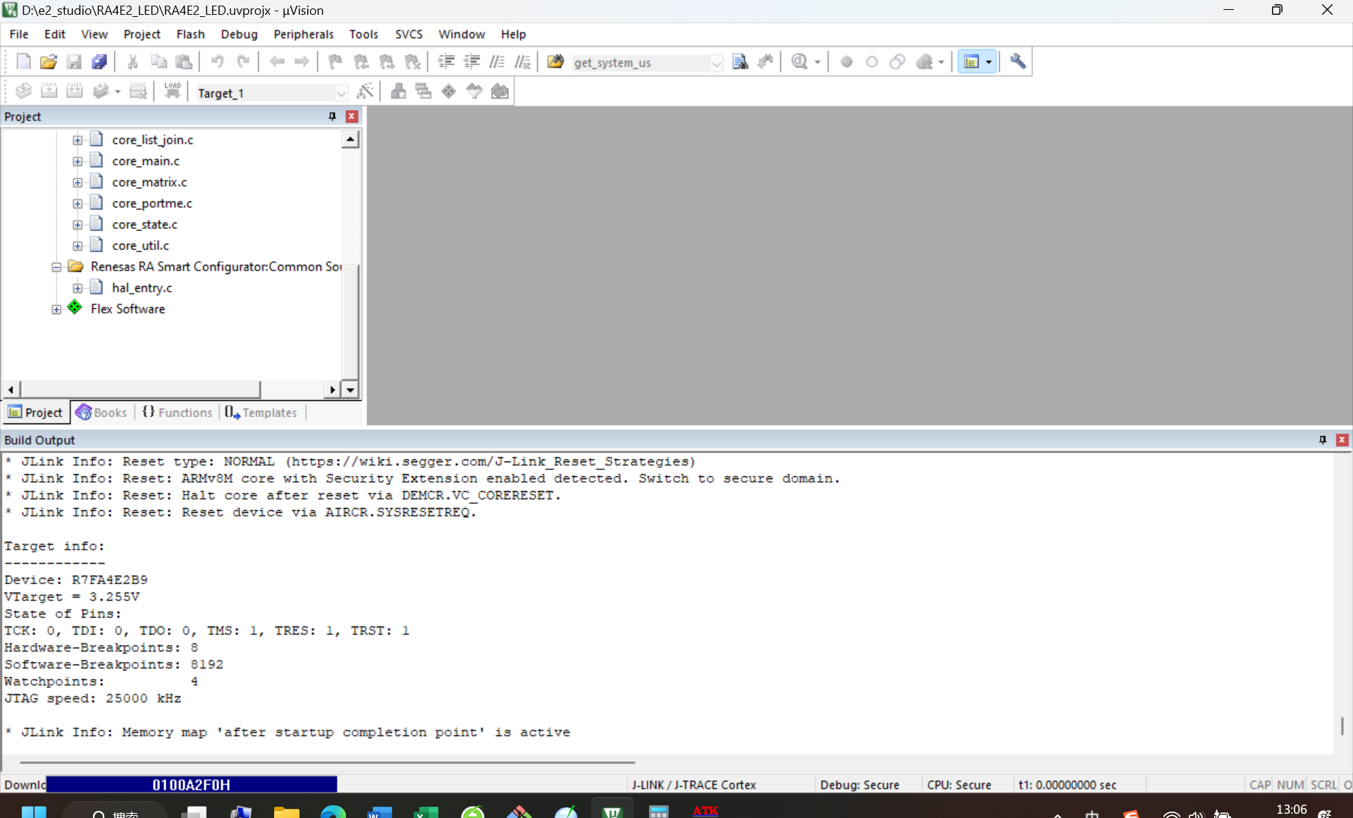

3。打开之前创建好的串口工程,将coremark添加到KEIL工程里

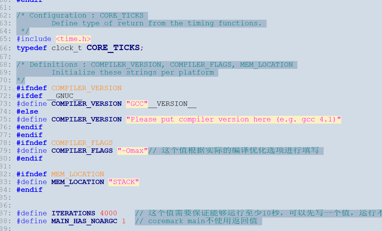

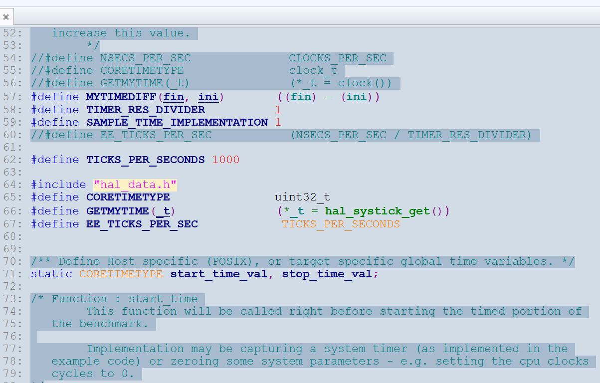

4。修改主要核心代码
#ifndef COMPILER_VERSION
#ifdef GNUC
#define COMPILER_VERSION "GCC"VERSION
#else
#define COMPILER_VERSION "Please put compiler version here (e.g. gcc 4.1)"
#endif
#endif

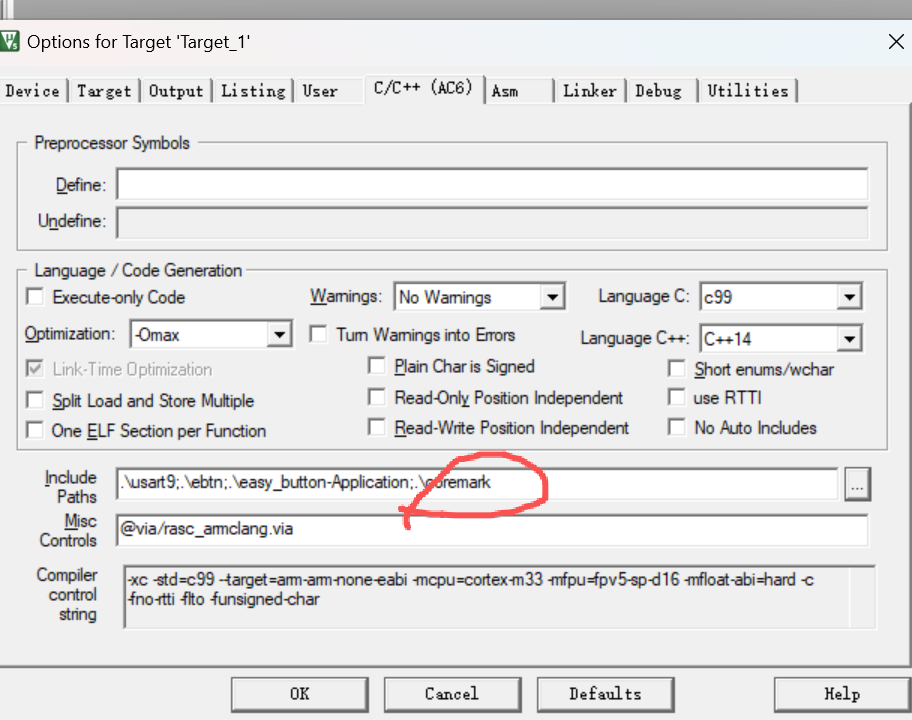

#ifndef COMPILER_FLAGS
#define COMPILER_FLAGS "-Omax"// 这个值根据实际的编译优化选项进行填写
#endif
#ifndef MEM_LOCATION
#define MEM_LOCATION "STACK"
#endif

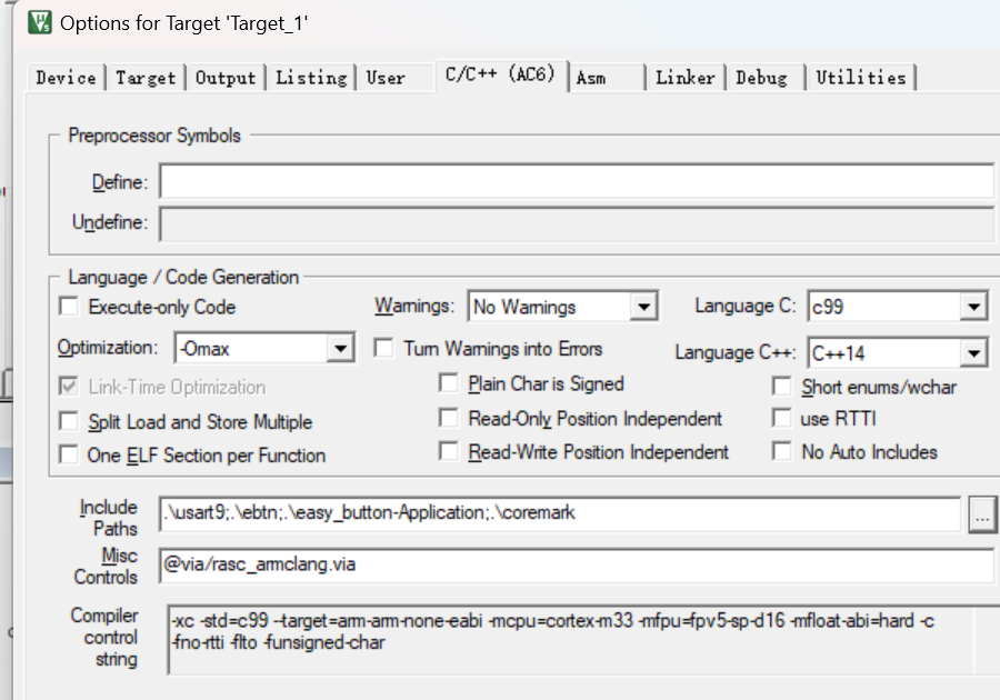

选取最大优化等级,Omax,对应KEIL里

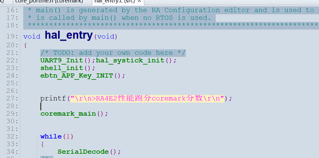

#include "hal_data.h"
#include "usart9.h"
#include "shell.h"
#include "ebtn_app.h"
#include "Serial.h"
#include "coremark.h"
FSP_CPP_HEADER
void R_BSP_WarmStart(bsp_warm_start_event_t event);
FSP_CPP_FOOTER
extern void coremark_main(void);
main() is generated by the RA Configuration editor and is used to generate threads if an RTOS is used. This function
is called by main() when no RTOS is used.
void hal_entry(void)
/ TODO: add your own code here */
UART9_Init();hal_systick_init();
shell_init();
ebtn_APP_Key_INIT();
printf("\r\n>RA4E2性能跑分coremark分数\r\n");
coremark_main();
while(1)

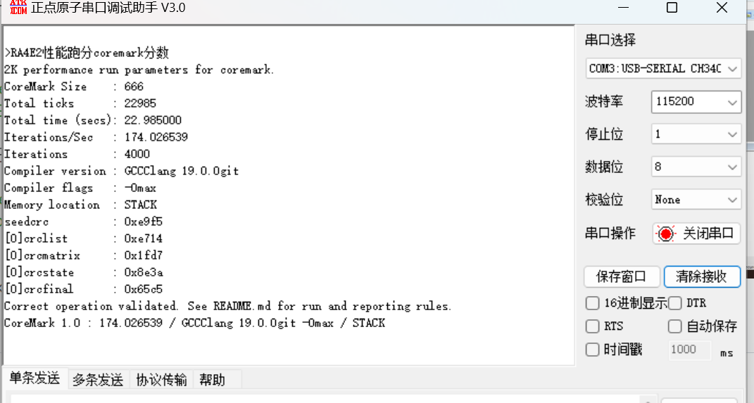

烧录代码到板子
打开串口助手
查看coremark分数
可以看到RA4E2最终跑分为CoreMark 1.0 : 174.026539
174分,中规中矩!!!!!!
