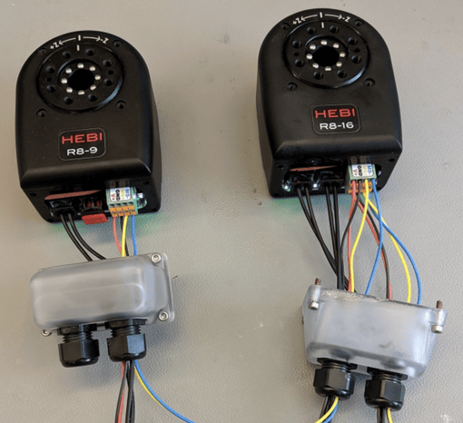

Time to use AI to find the parts should I use for the ethernet switch, and the optical transceivers. Here's the prompt: I want to design a daisy-chained communications layer for a motor driver, using 100M optical Ethernet. Each motor controller will have a microcontroller that interfaces to the Ethernet network over RGMII. It needs to be compact, robust to mechanical vibration and shock, and handle temperatures up to 60 degrees Celsius. Please help me choose parts for the optical connectors, transceivers, and Ethernet networking device.
Here I'm pulling more prompt engineering tricks to boost the performance of the model, and being careful in detailed specifications to really get this to work. My initial guess for these parts would be:
It would be amazing to get new suggestions for parts and architectures here. Something going beyond superficial advice into something practical would have huge impact! Instead, performance across all models was uniformly bad and no amount of prompting or follow ups could fix it. It felt a lot like trying to get AI to solve a variant of the wolf, sheep, cabbage problem. It's got the answer locked in, and it's hard to get out of that basin. Here's a representative conclusion from Gemini 1.5: Example Part Selection
Digital Cookie Time! ? I hope this detailed breakdown helps you choose the right parts for your daisy-chained motor control system. Please let me know if you have any other questions. Grading this:
Overall the generative models don't demonstrate a solid grasp on what the motor controller communication network is, or what application-specific considerations need to be made. Without that the part selections are way off. This is a consistent experience. The LLMs will always suggest something, but it will be the 'average' application and miss a lot of the important subtlety. i.e. fiber optic ethernet happens in the mostly in the datacenter, so an average application for fiber optic means a datacenter device. Trying to get them to choose an ADC, or sensor, or connector, shows similar 'average' results. Maybe this speaks to the difficulty of the domain. If you're not within 10% or so of the global optimal performance in EE, your suggestions have near-zero value. Parsing datasheetsSadly, most of the data you need to design a circuit board is baked away in PDF datasheets, instead of being available via APIs. Directly trying to parse PDFs with python tends to not go well, but LLMs should be pretty good at pulling data from these human-structured documents. I tested three different way of pulling information out:

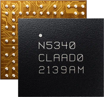

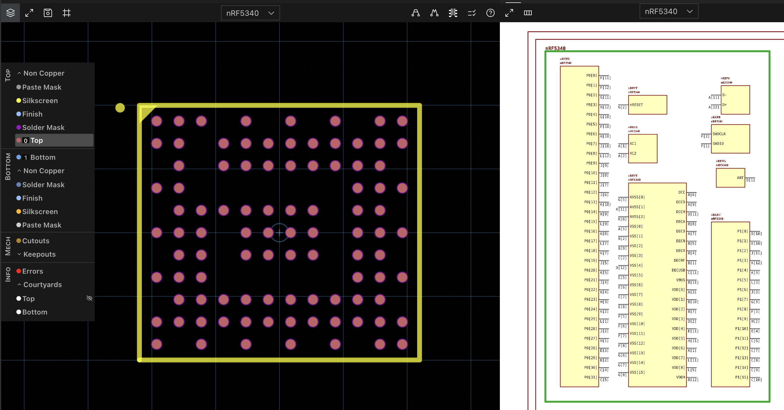

I'll be using the data available for the Nordic nRF5340 WLCSP for the experiment. A little 4.0 x 4.4 mm Bluetooth chip, with an 820 page datasheet.
Observations on this part:

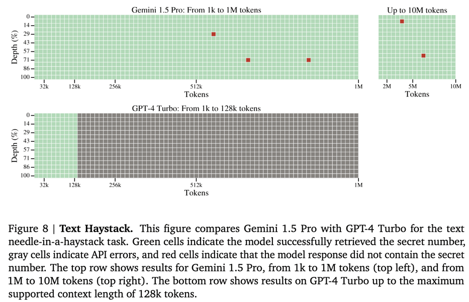

Make a symbol and footprintFirst step is a to make a linked symbol and footprint (landpattern) for our component. The most effective method here was to load the entire datasheet into the LLM via the chat file upload mechanism, and then query it interactively to get the details right. Gemini 1.5 was the most reliable for this task. Here's the prompt to get the pin table (after uploading the datasheet): Please write the the pin table for the wlcsp version of the nRF5340 as code using the following format:
The AI then returns a block of text with our pin list in a usable format:
It got this list exactly correct, impressive for 95 rows of data buried in an 820 page datasheet. Usually I have to get a model to write a little code to reach that level of accuracy, but that was unnecessary here. Next I gave it some example code for a BGA footprint and had it generate a new version based on the datasheet information. Here's the resulting code:
A few more misses here than in the pin table, but close overall. I have to go in and separately prompt for the depopulated balls in the grid, as well as correct the dimensions in the PackageBody. (Note that I'm generating JITX code because it has a text-native representation. I bet that you could get the model to emit something like a Kicad symbol/footprint with a little more nudging in the prompt.) Running the generated code (which you can find here), we get our footprint and symbols:
I really like the combination of code and scraped data here because of precision and flexibility. I would much rather trust a hand-coded BGA footprint generator for the details, and have the LLM tell me which pads to omit. The backstop of the LLM generating the list of pins and the missing pins , then forcing them both to line up to line up in the code is a nice touch. I can also dig in and edit parameters directly if I want to customize. Past the standard component model with a symbol and footprint, the LLM can also pull most of the useful data from the PDF. e.g. here is a generated parameterization for the IO pin levels for checking correctness of connections in a design:
If you don't have the AI return an answer as code, it tends to spread the data you want across multiple paragraphs, and it is easier to get the answer you want by just reading the datasheet instead. It can even read a bit of the reference schematic and turn it into a netlist:
It hallucinated this task a little bit, inventing resistors here and there. Using LLMs to pull data from challenging sources and turn it into useful code was a helpful automation technique (and personally the one I use most). Accuracy can be boosted further by using extraction techniques to cross-reference the data. Designing circuitsWe've seen that LLMs can understand an image of a schematic well enough to (mostly) turn it into a netlist. Can they take on a much more challenging task and design the circuit itself? As shown earlier, LLMs generated kinda-right, but actually very wrong suggestions for key components. To avoid that dependency, we tested our AIs on an analog circuit design task. This test is more about doing some math, and correctly arranging resistors and capacitors. The task is to design an pre-amplifier for an electret microphone -- boosting and filtering an audio signal for sampling by an ADC. We start with a basic architecture exploration. Here's the prompt: I want to design a microphone pre-amp where I need to bias the electret microphone and create a single-ended signal out to drive the ADC of a microcontroller. Include a bandpass filter with a gain of 20dB, corner frequencies at 100Hz and 20kHz. Help me select an architecture for this amplifier. Propose different filter architectures and describe their pros and cons for this application.

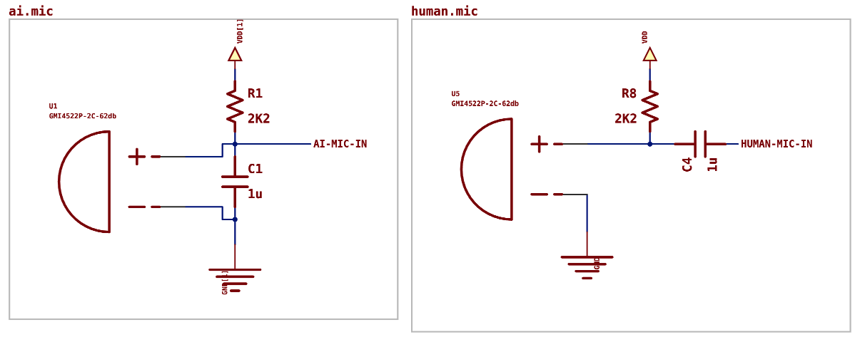

The decoupling cap in the bias circuit here really hampers the high-frequency performance of the circuit. What the circuit actually needs is a coupling cap , shown in the
Presumably in the training corpus, many articles and datasheets write extensively about decoupling caps. Maybe the "average" recommendation wins out here, and once it sees a positive and negative pin it slaps a capacitor across them right away. In our tests (and most product demos), LLMs loved to give naive advice about decoupling, which usually isn't as actively harmful as it is here. Moving on to the amplifier:

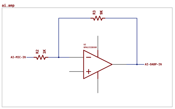

The AI describes the amplifier as non-inverting, but then feeds the signal into the inverting input. It's also missing a few other parts and nets that would make for a working circuit. Easier to see in the generated schematic:

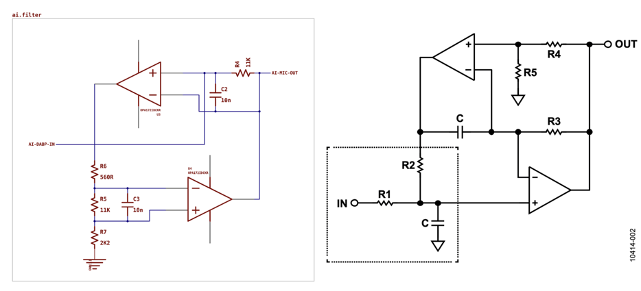

Moving on to the DABP filter implementation:

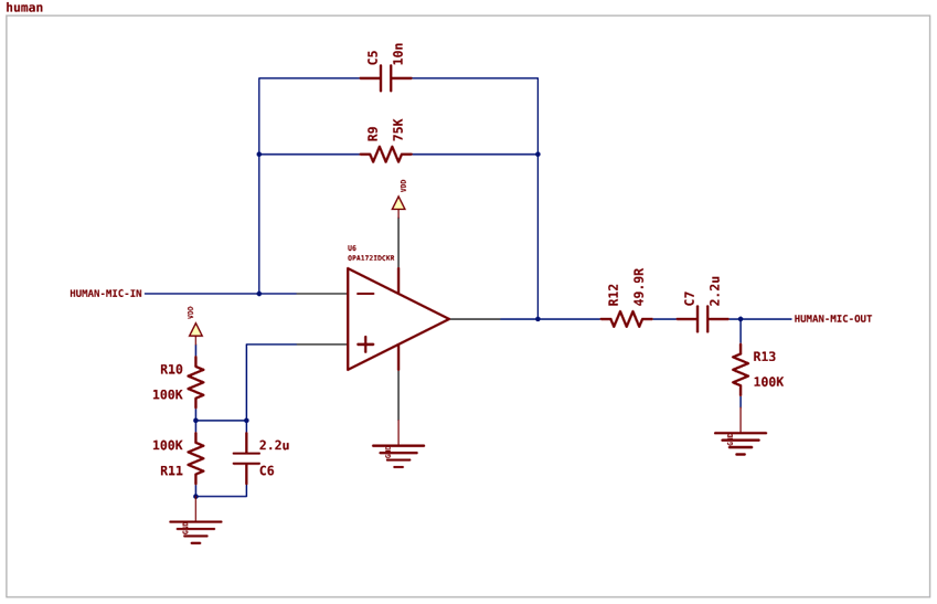

A few more misses on the netlist here, and about as correct as the amplifier (which is to say, not very). We also see the weirdly strong default of attaching capacitors across positive and negative pins. I guess LLMs are high decouplers. And to round it off, we've got another reminder to add decoupling caps, and a reasonable note about what to watch out for: The output of op2 is the final output of the pre-amp circuit. This should give you a good starting point. Remember to add decoupling capacitors and power supply connections as needed. Also, the actual component values may need to be adjusted based on the real specs of your chosen op-amp and the exact requirements of your ADC. Let me know if you have any other questions! Comparing against ground truthThis reference design from Texas Instruments is a good implementation of the requirements we asked these LLMs to design to. It uses passive RC filters (which the AI considered and avoided), and a single op-amp. I did a quick implementation of this in JITX (code here) to compare the AI generated circuit (code here) to the TI version.
The AI generated circuit was three times the cost and size of the design created by that expert engineer at TI. It is also missing many of the necessary connections. I found this breakdown surprising - it had no problems generating code in general, and was able to generate a syntactically correct netlist. The code runs! It's just that the pins are not in the right net statements and the resulting circuit is not correct. Testing higher level codeIn fairness, it's rare to write code like this to design a circuit board. In practice you're primarily calling higher level functions, e.g. selecting an op-amp, configuring a filter with parameters, then using a parametric pre-amp circuit:
