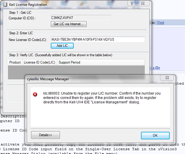

我购买了2个新的CY8C01B套件。与旧版本不同的是,它不支持KEIL的试用期30天,在Internet上可以获得许可证,并且当从因特网上获得许可时,它显示了添加错误(无效许可)的错误。我的同事也面临这个问题……该怎么办?? 以上来自于百度翻译 以下为原文 hi.. i purchased 2 new cy8c001b kits. unlike older one, it does not support 30 initial days of trial license of keil within which license can be obtained fron internet.As well as when license is obtained from internet, it shows error in adding(invalid license).my colleague also facing this problem ...what to do?? |

嗨,萨西,史雷姆!
没有KNO为什么UV4没有安装CD。但是我下载和安装它。它显示成功添加。但是STIL程序在创建者中没有被编译。更名为TOOLS.INI工具,并为LIK0添加了一行。问题持续存在。添加快照 2.PNG 89.3 K 以上来自于百度翻译 以下为原文 hi saashi, srim! Dont kno why UV4 was not installed with CD.However i downloaded and installed it.it shows successfully added. But stil programs in creator are not compiled. Renamed _TOOLS to TOOLS.INI as well and added line for LIC0. problem persist.Adding a snapshot
嗨,Neha,
我希望你想使用Keil的免费版本。它安装在“C:程序文件 CyPress PSoC创建者 2 PSoC创建者导入 Keil PK51”文件夹中。如果您通过创建者注册,即帮助& GT;注册-Ge:Keil,则使用以下过程。 1。编辑“C:程序文件 CyPress PSoC创建者 2 PSoC创建者导入Keil PK51 9.03 Too.ini” 2。在KEIL网站注册到最后一行后,通过邮件添加LIC。 “LIK0=lt;许可证ID代码& Gt; 三。编辑“C:程序文件 CyPress PSoC创建者 2 PSoC创建者导入 keil PK51 9.03 工具.ini”,并按照步骤2。 如果上述过程不起作用,请重新安装创建者并尝试它。即使重新安装后,上述程序也不起作用,然后提交一个案例。 阿努里达哈 以上来自于百度翻译 以下为原文 Hi Neha, I hope you want to use the free version of Keil. It is installed in "C:Program FilesCypressPSoC Creator2.0PSoC Creatorimportkeilpk51" folder. Use the following procedure if you get issue while registering through Creator i.e. Help -> Register -> Keil. 1. Edit "C:Program FilesCypressPSoC Creator2.0PSoC Creatorimportkeilpk519.03TOOLS.INI" 2. Add the LIC obtained through mail after registering on Keil website to this file on the last line. "LIC0= 3. Edit "C:Program FilesCypressPSoC Creator2.0PSoC Creatorimportkeilpk519.03_TOOLS.INI" and follow the step 2. If above procedure does not work, then please re-install the Creator and try it. Even after reinstallation, the above procedure does not work then file a case. ~ Aniruddha |
你好,Aniruddha!
我已经做了建议。我就此提出了一个案子。唯一可行的方法是从CyPress和UK4从Keil下载PSoC创建者2组件包。我注册了在电子邮件上安装的LISESESEI,安装在IDE上。现在情况很好…但是规定的CD与套件仍然不能工作! 以上来自于百度翻译 以下为原文 Hi Aniruddha! I already did what has been suggested. I filed a case regarding this. The only way to make it work out was to download PSoC creator 2.0 component pack from cypress and uv4 from keil.I registered the license i obtained on e-mail and it was installed on that IDE .now things are fine...but stipulated CD with the kit is still not working! |
