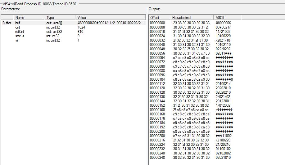

大家好,我是学位学生,我目前正在从事T& M项目,该项目涉及编写VEE程序以自动化测量过程。
我在使用Direct I / O与仪器通信时遇到问题。 我使用的是非安捷伦仪器,我使用的是Rigol DS1102E数字示波器。 问题:我尝试通过Direct I / O使用SCPI命令从仪器读取跟踪数据,只能使用Read Text x作为str来获取完整的返回数据。 当我尝试在Array1D中使用Read Binblock x作为二进制时,我将遇到超时问题或数据数据解码不完整或者每次按下模拟都没有找到数据并且结果不一致,我应该从返回的数据中得到600点。 当我使用Agilent Interactive I / O和I / O监视器来了解返回的数据时,读取过程是正确的,返回的数据是HEX并转换为ASCII。 返回的消息请参见附件IO Montor Result.png。 根据我对IO Monitor结果的理解,我知道返回的数据是在无符号Int8中,因此,我首先使用ToFile对象使用Read Text x作为str保存数据,并使用FromFile Object将Read Binblock x作为Binary读回数据 在Array 1 D中,返回的数据能够完全解码。 问题:为什么Direct BinBlock x作为直接I / O事务中的二进制Array1D无法完全解码返回的数据? 是否需要对缓冲区大小进行任何设置或者我缺少哪一步? 请指教。 谢谢你,Jeremy Tan 以上来自于谷歌翻译 以下为原文 Hi all, I am a degree student and I currently working on a T&M project which involved in writing VEE program to automate a measurement process. I face a problem on using Direct I/O to communicate with the instrument. I am using non Agilent Instrument, I am using Rigol DS1102E Digital Oscilloscope. Problem: I try to Read the trace data from the instrument using the SCPI command via Direct I/O, the was only able to use Read Text x as str to get the full returned data. When I tried to use Read Binblock x as Binary in Array1D, I will have a timeout issue or data data decoded incomplete or no data found every single time I pressed simulate and the result was not consistent , I should get 600points from the returned data. When I use the Agilent Interactive I/O and the I/O monitor to understand the returned data, the reading process was correctly and the returned data is in HEX and converted into ASCII. The returned message see attachement IO Montor Result.png. From my understanding through the IO Monitor result, I know the returned data is in unsigned Int8, therefore, I first save the data by using Read Text x as str using ToFile object and read the data back using FromFile Object with Read Binblock x as Binary in Array 1 D and the returned data was able to completely decode. Question: Why the Read BinBlock x as Binary Array1D in the Direct I/O transaction cannot completely decode the returned data? Is it I need to do any setting on the buffer size or what step I am missing? Please advise. Thanks Regards, Jeremy Tan 附件

返回的数据在uint8中有600pts我只能读取文本字符串格式的完整数据,并使用文件中的Read BinBlock手动将其转换回uint8。 非常有趣的是找出为什么Direct IO不允许我在Binary中读取BinBlock。 看到附件,WAVefromData.txt是使用Direct IO读取的返回数据,并使用ReadTraceData.vee使用Binblock二进制加载数据,这是我想要的600pts的返回值。 有关您的信息,返回值为0-255数据,不是实际格式。 不管怎样,谢谢你的分享。 :-)编辑:jeremytcw于2012年11月5日上午7:27 ReadTraceData.vee3.8 KB 以上来自于谷歌翻译 以下为原文 YES, I know what you said, but I tried it also, and the instrument I use is non Agilent product. The returned data is in uint8 with 600pts I only able to read the full data in text string format and manually convert it back to uint8 using Read BinBlock from file. Very interesting to find out why with the Direct IO not allow me to read BinBlock in Binary. See the attachment, WAVefromData.txt was the returned data read using Direct IO and use the ReadTraceData.vee to load the data using Binblock binary and that is the returned value in 600pts I want. For your information, the returned value is in 0-255 data and is not in real format. Anyway, thanks for your sharing here. :-) Edited by: jeremytcw on Nov 5, 2012 7:27 AM 附件

哎呀。 第一行和第二行是我在发现期间故意写入的,以便我知道何时收集数据。 我已经尝试了所有可能的方式d,但严重的是我找不到任何最好的答案来解释它。 因为通过IO监视器,缓冲区中的总线消息显示它正在读取一个字符并重复600次,我认为这是仪器响应的特性。 因此,我继续编写我的程序,添加了额外的对象,即ToFIle和FromFile对象。 也许有人可能会给我解释原因。 感谢@ ulf.jakobsson的分享。编辑:jeremytcw于2012年11月6日下午9:02 以上来自于谷歌翻译 以下为原文 Opps. The first row and the second row was I purposely write in during my finding so that I know when the data was collected. I already tried all the possible way d, but seriously I can't found any best answer to explain it. Because through the IO Monitor, the Bus message in buffer shows it is reading a character and repeated for 600times, and I think that is the instrument respond in character. Therefore, I continue to write my program by added in extra object which is ToFIle and FromFile object. Perhaps someone may give me explanation why. Thank you @ulf.jakobsson for your sharing. Edited by: jeremytcw on Nov 6, 2012 9:02 PM |

我忙于考试。 通过获得RIGOL公司技术支持的帮助,我能够以正确的垂直显示值获得正确的返回跟踪数据。 我觉得我应该在这里分享我的发现。 出于某种原因,RIGOL示波器不直接将实际跟踪数据转换为直接io对象的binblock读取。 Agilent VEE仅允许直接I / O以TEXT格式读取返回的数据。 之后,使用修复转换公式读取binblock_bin,以使用正确的垂直显示值返回原始数据。 abit很奇怪,但它能够在转换后获得实际数据。 该方法修改了LabView的仪器演示程序。 以上来自于谷歌翻译 以下为原文 I was busy with my exam. I able to get the correct returned trace data with the correct vertical display value by getting help from the RIGOL company tech support. I feel that I should share my findings here. For some reason, the RIGOL Oscilloscope doesn't directly convert the actual trace data into binblock read from the direct io object. Agilent VEE only allow the direct I/O to read the returned data in TEXT format. After that read binblock_bin with a fix conversion formula to get back it original data with the correct vertical display value. Is abit weird, but it is able to get back the actual data after conversion. This method was modified the LabView's demo program for the instrument. |
