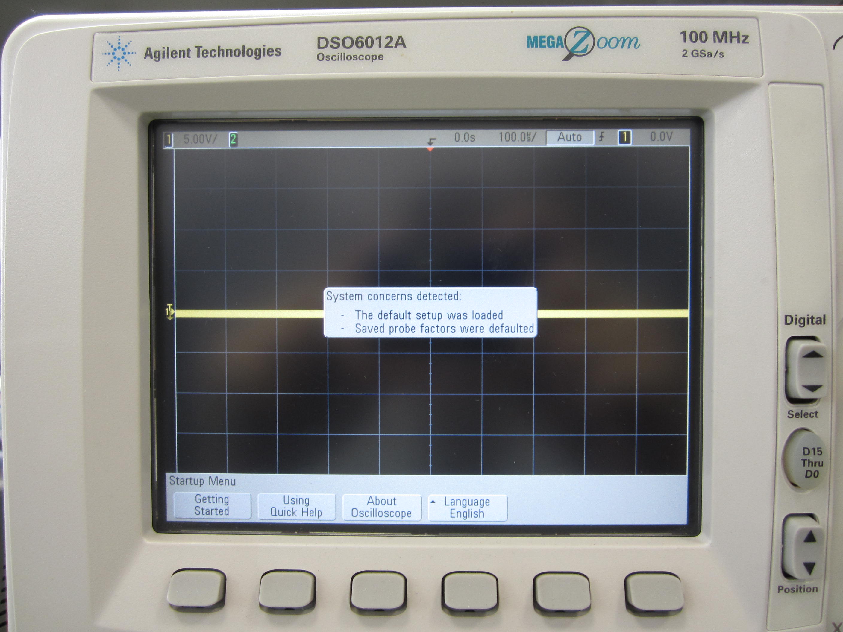

我是这个论坛的新手。 我想在这里提一个关于DSO6012A在早上开机时出现的错误的问题。 它给我的信息是:检测到系统问题: - 默认设置已加载 - 保存的探测因子默认我将示波器更新到最后的软件版本并打开它,我测量了电池内部,看起来没问题。 会发生什么事? 只有在开机时才会出现错误。 有什么我可以检查来解决这个问题? 我附上了这个错误的照片。 在此先感谢您的帮助。 问候,Devis 以上来自于谷歌翻译 以下为原文 Hi all !!! I'm new on this forum. I'd like to make here a question about an error that appear on my DSO6012A time to time just when turned on in the morning. It gives me the message: System concerns detected: - The default setup was loaded - Saved probe factors were defaulted I updated oscilloscope to last software version and opened it, I measured battery inside and it seems ok. What can be happened ? Error appears randomly only at power on. Is there something I can check to resolve this problem ? I attach photo of this error. Thanks in advance for any help. Greetings, Devis 附件

按此顺序重新下载最新固件:http://www.home.agilent.com/agilent/editorial.jspx?cc = US& cs = eng& ckey = 666864& nid = -536902766.0.00& id = 666864确保
你抓住5000和6000的文件,而不是7000系列...按顺序执行:sys lib gsp lpk如果它仍然返回,运行自检...如果slef测试失败,再次运行它。 如果自我保持失败 - >在安捷伦服务中心维修。 你也可以做一个自我...如果我通过,范围采集硬件(应该)是好的...那么你只需要担心每次都从defualt开始......你可以在内部保存设置或者 USB记忆棒... 以上来自于谷歌翻译 以下为原文 relaod the latest firmware in this order: http://www.home.agilent.com/agilent/editorial.jspx?cc=US&lc=eng&ckey=666864&nid=-536902766.0.00&id=666864 Make sure you grab the files for the 5000 and 6000, not the 7000 series… do in order of: sys lib gsp lpk If it still comes back, run a self test... if the slef test fails, run it again. If the self est keeps failing -> repair at Agilent service center. You could also do a self cal... if i passes, the scope acquisition hardware is (should be) good... then you just have to worry about starting from defualt every time... you can save setups internally or to a USB stick... |
