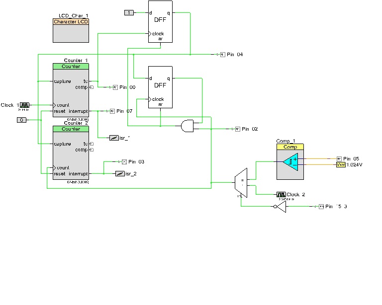

努力营造良好的频率计,我发现捕捉功能不能工作在外部测量信号的情况下使用。
我使用计数器捕获终端计数器1的终端计数。然后计算相邻两FIFO值之间的差值。 见附件安装。 如果我使用测试信号的内部generatedclock2一切工作正常。 但在任何情况下使用外部信号从端口引脚(无关紧要或模拟与数字输入比较器)导致FIFO状态位零。 这对于PSoC3和PSoC5来说是完全相同的。在CY8KIT-03和CY8KIT-014上进行了试验。 设置程序 55.8 K 以上来自于百度翻译 以下为原文 Trying to build fine frequency meter I discover that capture function fail to work in case of external measuring signal used. I use sequential capturing on terminal count of Counter_1. Then I calculate difference between two neighbor FIFO values. See attached setup. If I use as test signal internally generated Clock2 everything works fine. But in any case of using external signal from the port pin(doesn't matter as digital input or analog with comparator) lead to zeroes in FIFO status bits. This is absolutely the same for PSOC3 and PSOC5. Tests were done on CY8KIT-003 and CY8KIT-014.
1个回答
与Jibin Thomas合作解决(多谢!).
这个错误存在于计数器的1.50版本中,并且将在V2.0中被固定。直到使用V1.20。 以上来自于百度翻译 以下为原文 Solved in collaboration with Jibin Thomas (many thanks!). This bug exists in version 1.50 of Counter and will be fixed in v2.0. Till this use v1.20. |
