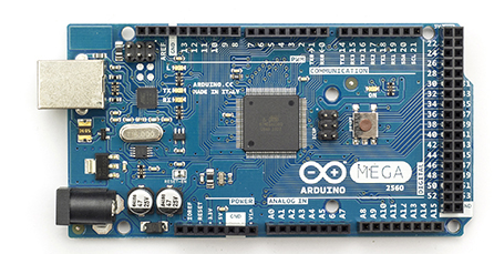

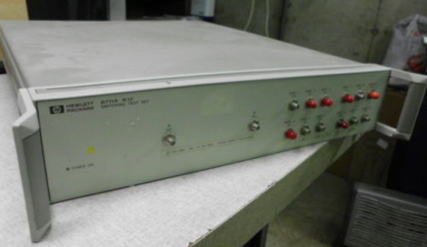

我从eBay购买了上述测试装置之一,我收集的是为了配合8711A VNA。
我相信它基本上是Joel在他的书的图2.25(第94页)中描述的“简单切换树测试集”。 测试集似乎由某种并行接口控制。 我还没有,但我被告知里面有一对SP6T 20 GHz继电器。 *(更新:我购买了其中三个,并且都有4 GHz继电器,所以我猜惠普使用的是20 GHz继电器,当时只有4 GHz的低库存)*我买它是为了将它连接到我的8720D, 所以我还买了一个Arduino Mega 2560微控制器,所以我可以通过GPIB控制继电器,希望能够制造一款可靠的12端口VNA! 有人在测试装置和/或8711A VNA上有手册吗? 我似乎无法在安捷伦网站上找到任何内容,并且询问HP / Agilent Yahoo组也未获得任何结果。 我想尽可能地了解我可以如何控制它,特别是它需要什么样的电源电压。 8711A是否具有能够使用此测试装置进行适当校准的固件? 测试集是由8711A直接控制还是其他用途? 有关在8720D上使用它的实用性的任何想法? Dave编辑:drkirkby于2014年3月22日下午8:45 Arduino-Mega-2560.png184.9 KB 以上来自于谷歌翻译 以下为原文 I purchased one of the above test sets from eBay, which I gather was designed to go with the 8711A VNA. I believe it is basically what Joel describes as a "Simple switch tree test set" on figure 2.25 (page 94) of his book. The test set appears to be controlled by some sort of parallel interface. I don't have it yet, but I'm told there are a pair of SP6T 20 GHz relays inside. *(UPDATE: I bought three of these, and all had 4 GHz relays, so I guess HP used 20 GHz relays when stocks were low on 4 GHz ones only)* I bought it with the intention of connecting it up to my 8720D, so I also bought an Arduino Mega 2560 microcontroller, so I can control the relays via GPIB with the hope of making a poor mans 12 port VNA !! Does anyone have a manual on the test set, and/or 8711A VNA? I can't seem to find anything on the Agilent web site, and asking on the HP/Agilent Yahoo group has not get any results either. I'd like to try to understand best I can how that was controlled, and in particular what supply voltages it needs. Did the 8711A have firmware able to do a proper calibration with this test set? Was the test set controlled by an 8711A directly, or was something else used? Any thoughts about the practicalities of using this on an 8720D? Dave Edited by: drkirkby on Mar 22, 2014 8:45 PM 附件

我想我们会在某个地方有一个原理图...可能在我们的特殊处理小组中。
如果我记得,我可以在星期一查看。 不保证! 以上来自于谷歌翻译 以下为原文 I would think we would have a schematic somewhere...probably in our Special Handling group. I can check on Monday if I remember. No guarantees! |
> {quote:title = jvall写道:} {quote}>我想我们会在某个地方有一个原理图...可能在我们的特殊处理小组中。 如果我记得,我可以在星期一查看。 不保证! 谢谢Jvall。 我在8711A上买了一本服务手册,但其中没有太多内容 - 没有电路图,所以没那么有用。 我可以看到后面有一个带3个引脚的电源连接器。 我怀疑这些可能是地,5V和24V,但我不知道。 我的任务并不容易,因为继电器上只有一个选件100,它用焊接连接取代了带状电缆。 电源电压没有选项,尽管继电器上的手册表示选项xyz是默认值,即24V。 所以我猜这些是24V,虽然24V的选项不在继电器上。 它们是由集电极开路器件驱动的,因此无法根据电路板的布局确定电压是多少。 我怀疑电路板也需要5V,因为有一些TTL逻辑,没有电压调节器。 如果我可以将这个东西用于GPIB并发现它很有用,我会将继电器改为20或26.5 GHz型号,但现在我将使用4 GHz的型号。 戴夫 以上来自于谷歌翻译 以下为原文 > {quote:title=jvall wrote:}{quote} > I would think we would have a schematic somewhere...probably in our Special Handling group. I can check on Monday if I remember. No guarantees! Thank you Jvall. I bought a service manual on the 8711A, but that did not have much in it - no circuit diagrams, so not really that helpful. I can see there is a power connector on the rear with 3 pins. I suspect these might be ground, 5V and 24V, but I don't know. My task is not made easier the fact there is only an option 100 on the relays, which replaces the ribbon cable with solder connections. There is not an option for the supply voltage, though the manual on the relays says option xyz is the default, and that is 24V. So I am guessing these are 24V, though the option for 24V is not on the relays. They are driven from open-collector devices, so its impossible to determine from the layout of the board what the voltage would be. I suspect the board needs 5V too, as there is some TTL logic and there is no voltage regulator. If I can get this thing working on GPIB and find it useful, I will change the relays to 20 or 26.5 GHz models, but for now I will use the 4 GHz ones. Dave |
60user7 发表于 2019-1-25 13:08 对不起,我没有找到任何相关信息。 我问过我们的特殊处理组,他们也没有任何东西......它太老了。 如果我找到任何东西,我会告诉你的。 以上来自于谷歌翻译 以下为原文 Sorry, I have had no luck finding any information on this. I have asked our Special Handling group and they have nothing either...it is just too old. If I find anything, I will let you know. |
不管怎样,谢谢你。 我或许可以在HP / Agilent Yahoo小组中找到一位有8711A可以测量电压的人。 此外,我可以澄清SP6T继电器的电压,因为这些是当前的安捷伦产品。 获得一本手册会很有用,但内部非常简单,所以如果我只是撕掉大部分电子设备,并从头开始设计我自己的GPIB控件,那就不难了。 这些测试装置在eBay上很有价值,因为tedtvsets的售价低于内部继电器的成本! 我为测试装置支付了70美元,每个测试装置有两个SP6T 4 GHz继电器。 继电器的价格超过35美元! 戴夫 以上来自于谷歌翻译 以下为原文 Thank you anyway. I might be able to find someone on the HP/Agilent Yahoo group who has an 8711A who could measure the voltages. Also I can probably clarify the voltage of the SP6T relays as those are current Agilent products. It would have been useful to get a manual, but they are pretty simple inside so if I just rip out most of the electronics, and design my own GPIB control from scratch it should not be hard. These test sets are good value on eBay, as the tedtvsets sell for less than the cost of the relays inside! I paid $70 for the test sets which has two SP6T 4 GHz relays each. The relays fetch more than $35! Dave |
