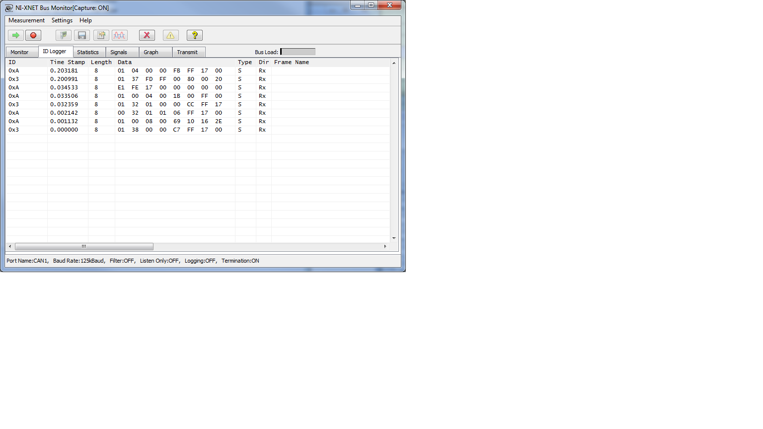

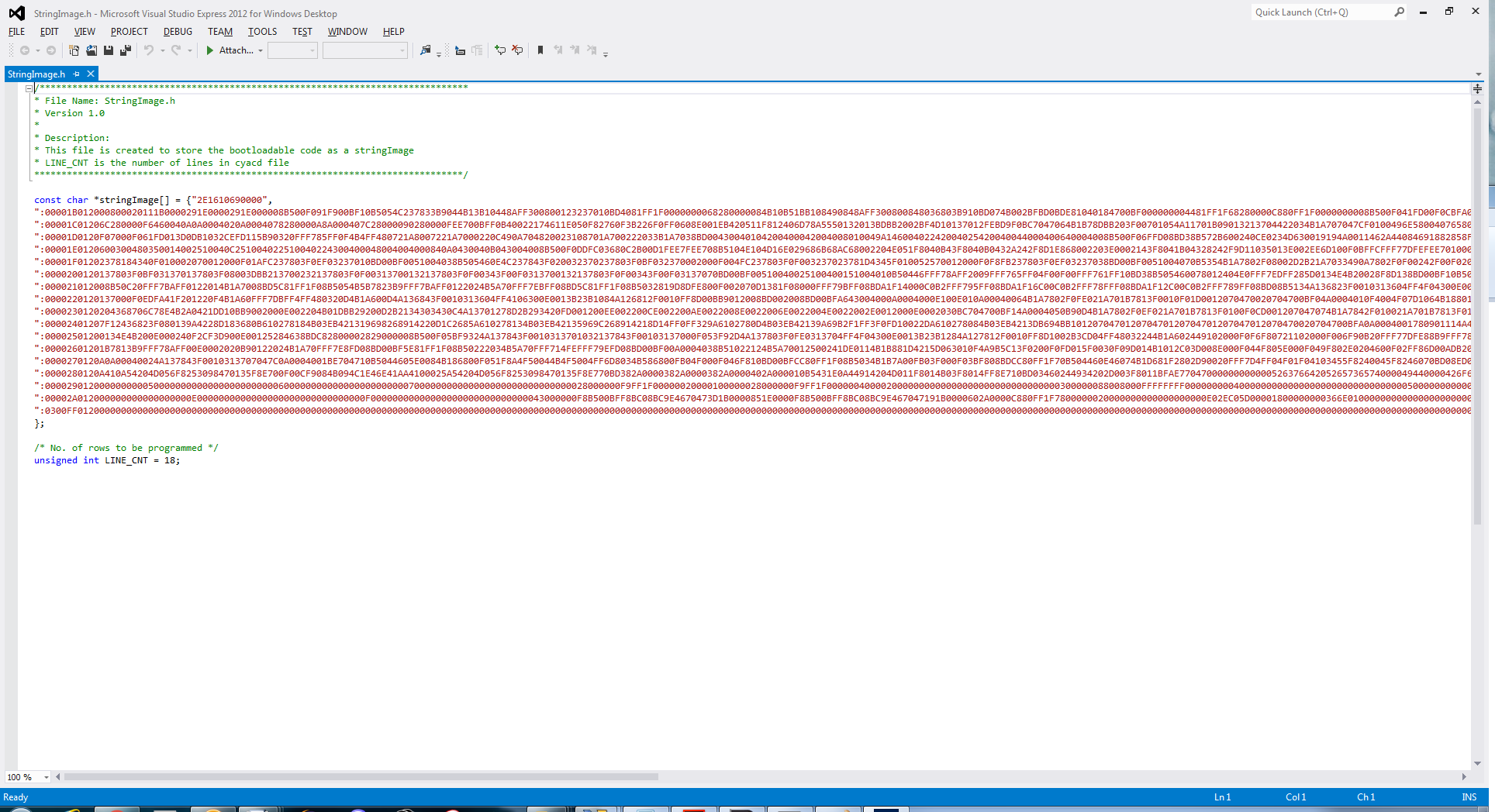

我成功地修改了UART Bootloader示例项目(AN68,227)中的通信协议。现在我可以发送数据到目标并接收响应。但是当我发送0x37命令(发送数据)时,我得到0x4错误(数据不在支持器表单中)。我使用CYACD字符串图像工具来转换字符串数组中生成的CYACD文件。请参阅下面的图片(0x3来自主机的消息,来自目标的0xA消息)。知道我为什么会犯这个错误吗? PNG 123.7 K DATAELROR 74.1 K 以上来自于百度翻译 以下为原文 Hi, I managed to modify the communication protocol in the UART Bootloader example project (AN68272) to CAN. Now I`m able to send data to target and to receive responses. But when I send 0x37 command (send Data) I get 0x4 error (data is not in the propper form). I`m using Cyacd to String image tool to transform generated cyacd file in string array. See the picture below (0x3-Message from Host, 0xA message from Target). Any idea why I`m getting this error?
