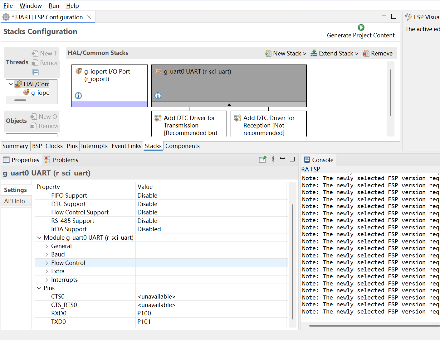

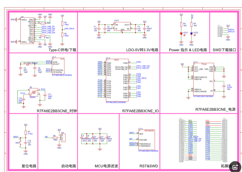

有原理图可知,串口0是P100和P101两脚
打开RA smart配置软件进行配置即可
很简单,关键是要实现串口重映射和中断函数即可

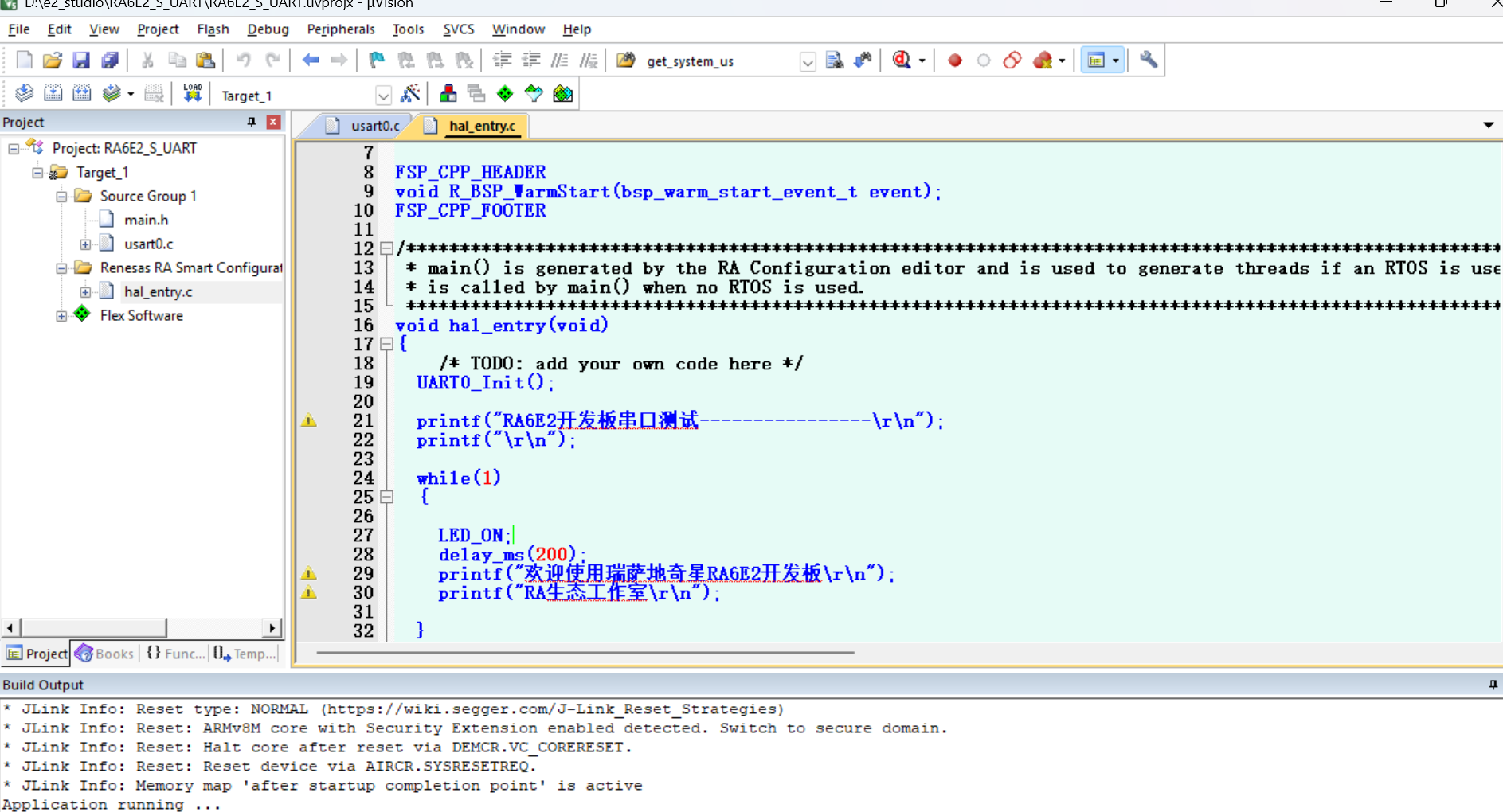

#include "hal_data.h"
#include "main.h"
FSP_CPP_HEADER
void R_BSP_WarmStart(bsp_warm_start_event_t event);
FSP_CPP_FOOTER
main() is generated by the RA Configuration editor and is used to generate threads if an RTOS is used. This function
is called by main() when no RTOS is used.
void hal_entry(void)
/ TODO: add your own code here */
UART0_Init();
printf("RA6E2开发板串口测试----------------\r\n");
printf("\r\n");
while(1)
LED_ON;
delay_ms(200);
printf("欢迎使用瑞萨地奇星RA6E2开发板\r\n");
printf("RA生态工作室\r\n");
#if BSP_TZ_SECURE_BUILD
/* Enter non-secure code */
R_BSP_NonSecureEnter();
#endif

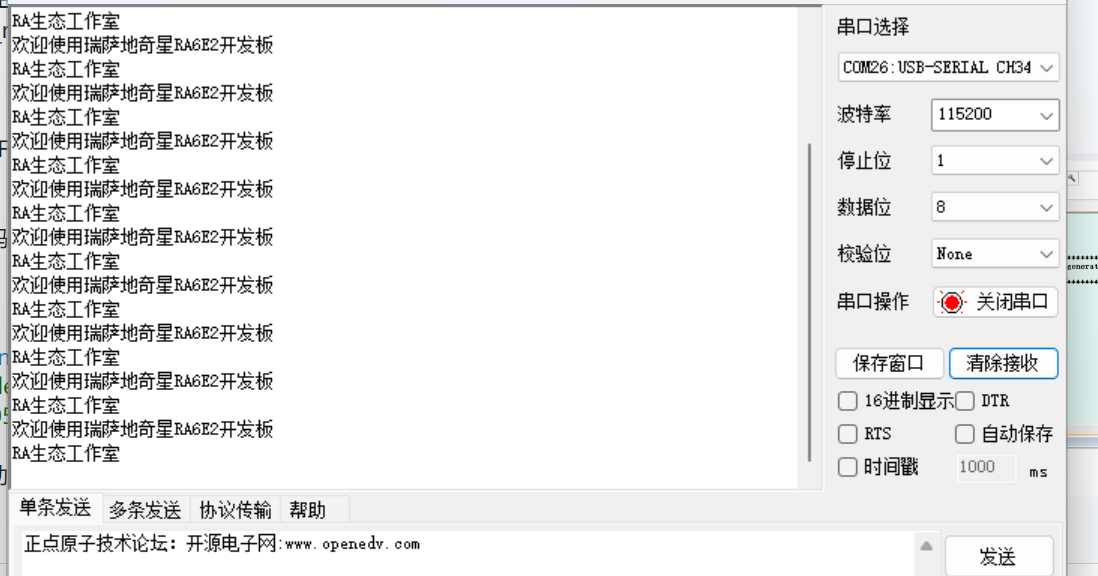

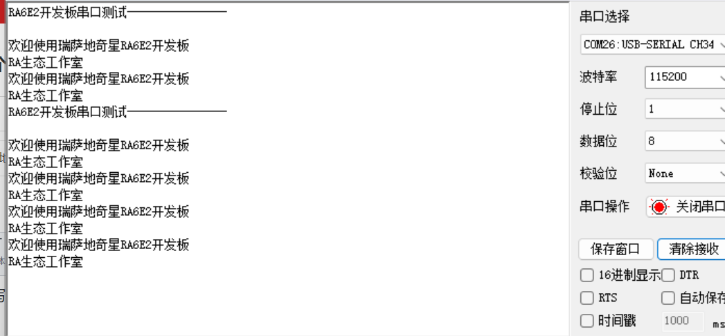

打开KEIL,编译后烧录代码
打开串口助手
详情见视频
