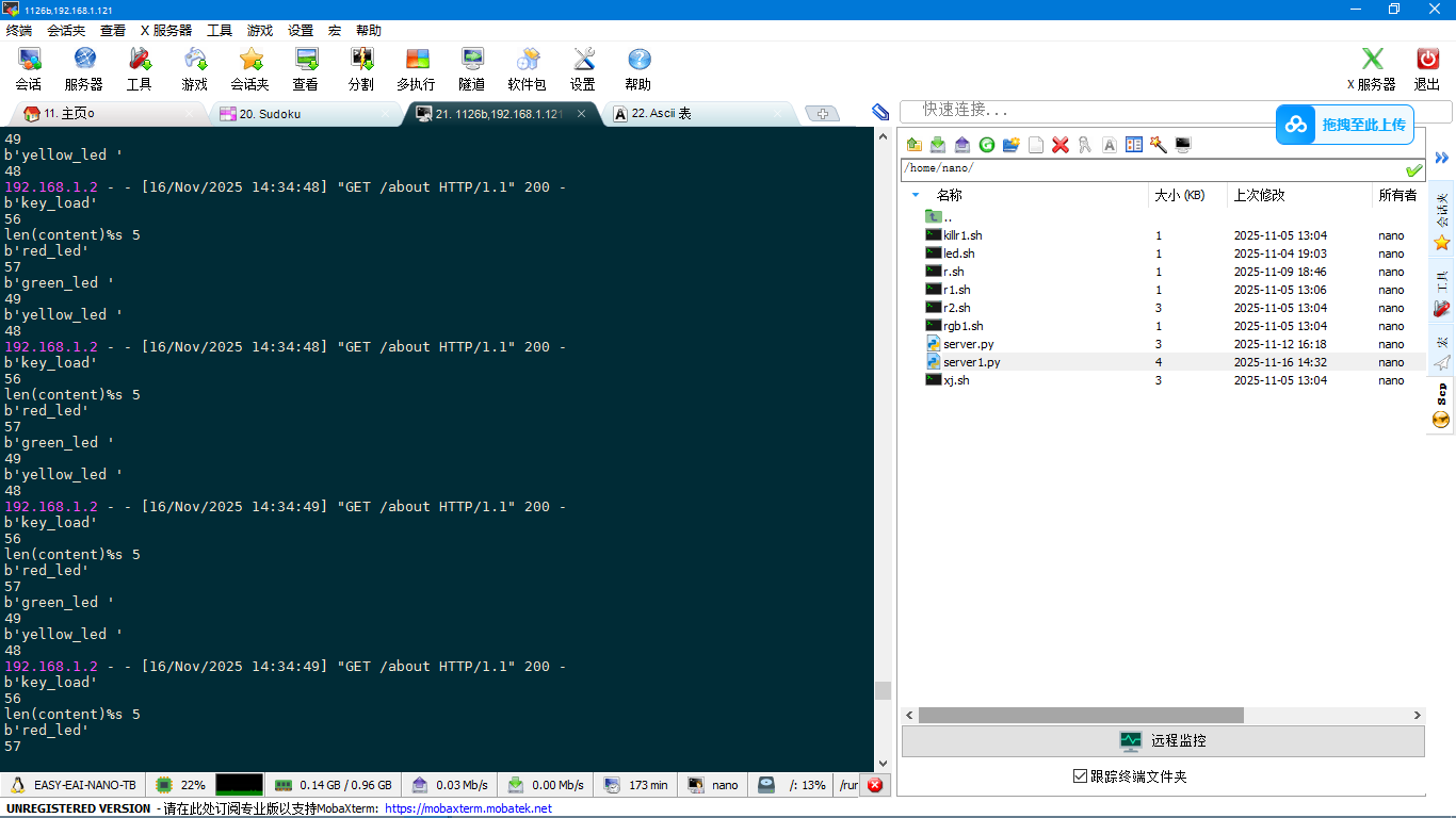

运行脚本
nano@EASY-EAI-NANO-TB:~$ python3 server1.py
Server running on port 8011...
192.168.1.2 - - [16/Nov/2025 14:33:07] "GET / HTTP/1.1" 200 -
b'key_load'
56
len(content)%s 5
b'red_led'
49
b'green_led '
49
b'yellow_led '
48
192.168.1.2 - - [16/Nov/2025 14:33:18] "GET /about HTTP/1.1" 200 -
b'key_load'
56
len(content)%s 5
b'red_led'
49
b'green_led '
49
b'yellow_led '
48
192.168.1.2 - - [16/Nov/2025 14:33:44] "GET /about HTTP/1.1" 200 -
b'key_load'
56
len(content)%s 5
b'red_led'
49
b'green_led '
49
b'yellow_led '
48

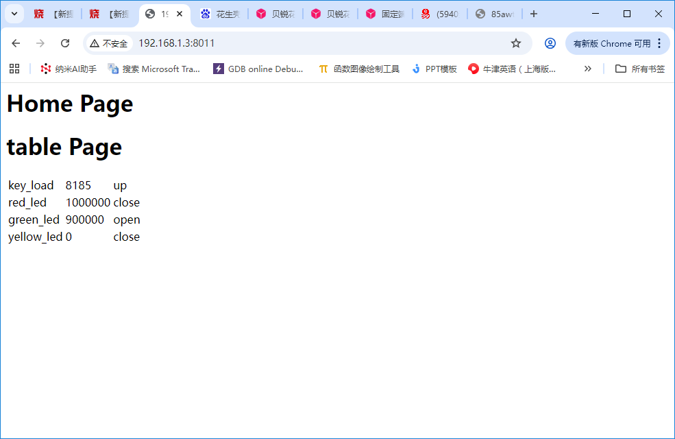

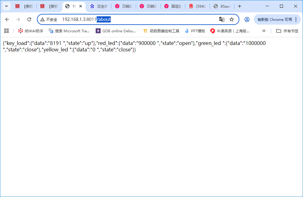

l电脑浏览器显示:

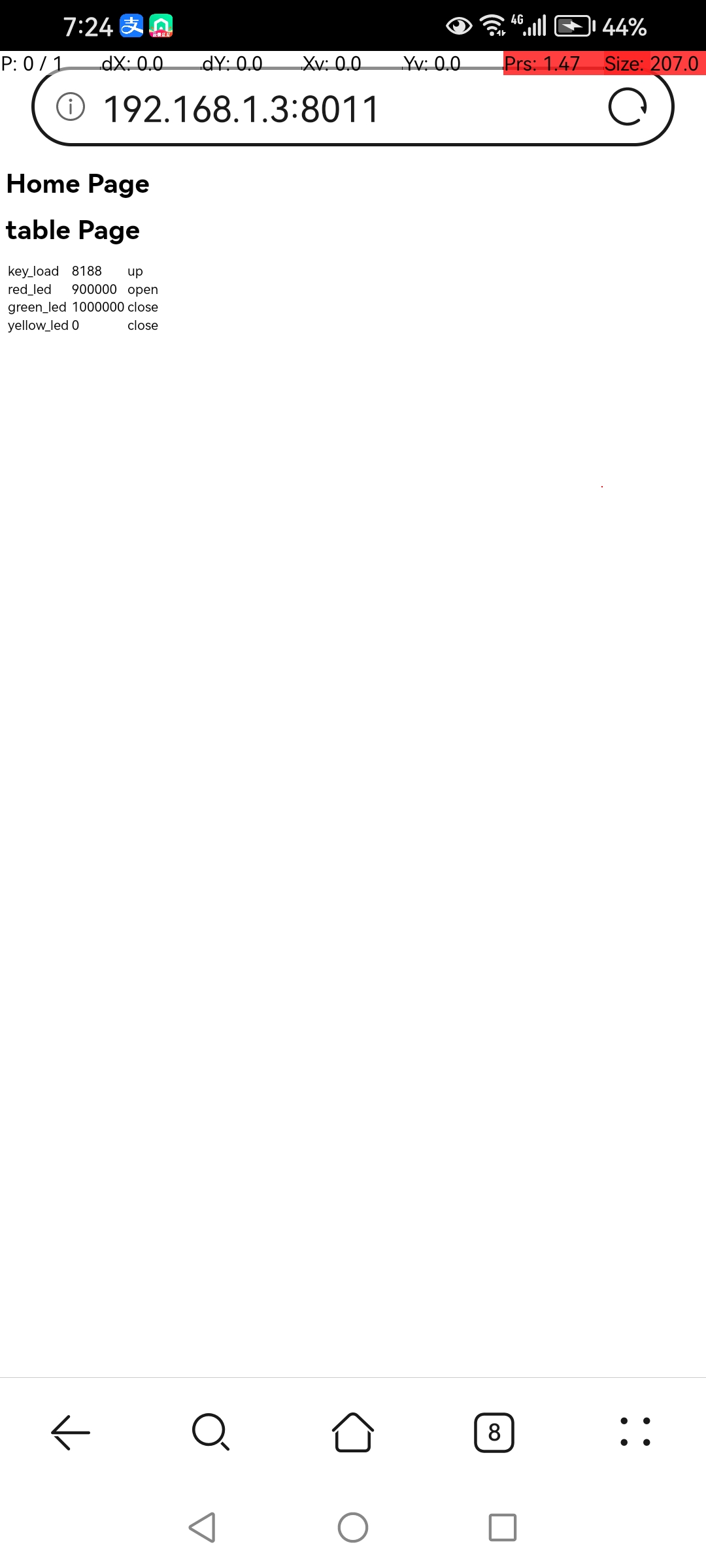

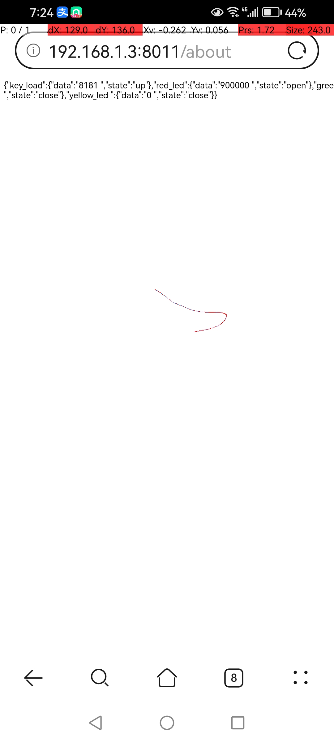

2手机浏览器显示:
灯正常闪!!web显示正常,提供2种显示。
