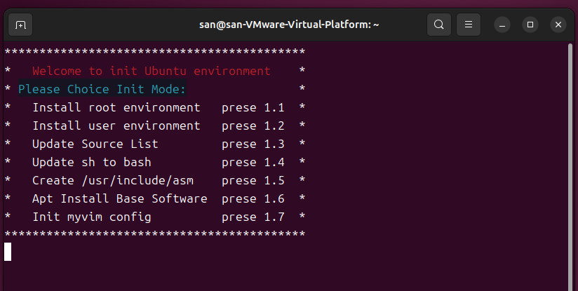

* Welcome to init Ubuntu environment *
* Please Choice Init Mode: *
* Install root environment prese 1.1 *
* Install user environment prese 1.2 *
* Update Source List prese 1.3 *
* Update sh to bash prese 1.4 *
* Create /usr/include/asm prese 1.5 *
* Apt Install Base Software prese 1.6 *
* Init myvim config prese 1.7 *
1.1

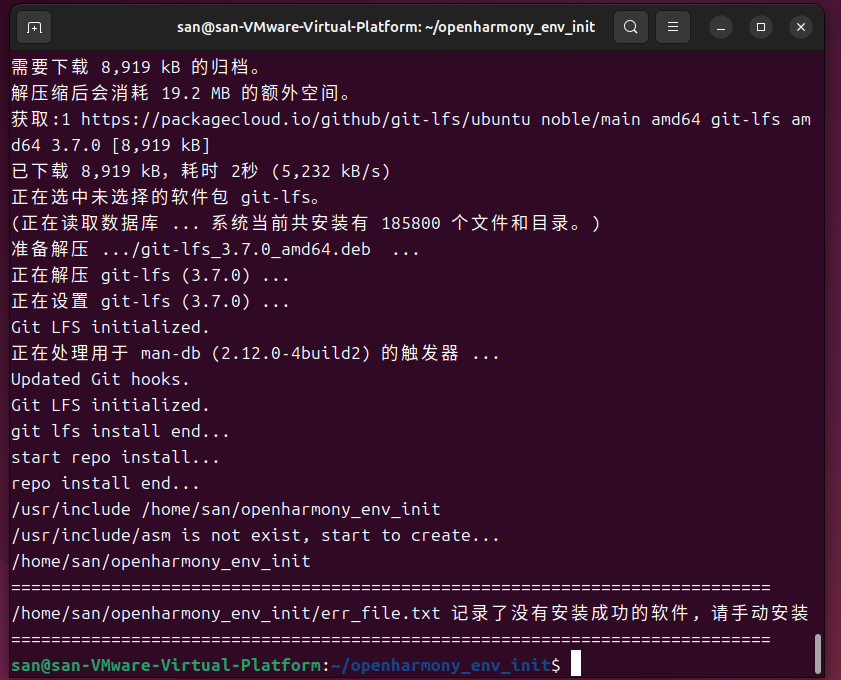

* 4、安装git lfs *
* 5、安装repo *
* 6、创建/usr/include/asm链接/usr/include/x86_64-linux-gnu/asm *
确认是否安装 [Y/n]

然后是漫长的等待
