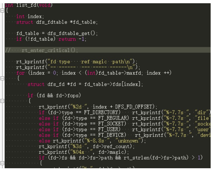

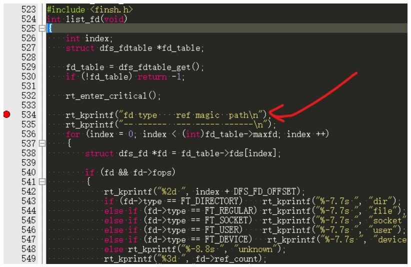

操作系统 RTT 4.1.1 芯片STM32F429 编译器 KEIL AC6 -O0 使用list_fd命令,导致看门狗复位 debug查看进入printf就挂了
注释 rt_enter_critical和rt_exit_critical就可以打印

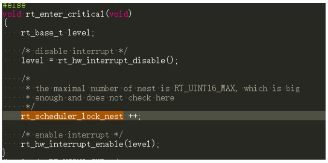

rt_enter_critical和rt_exit_critical这两函数有啥用?
3个回答
这有点类似telnet里面调用netstat了,需要改进下,应该是同类问题。
我照着改了一下代码,不过我打印出来永远都是空的。不知道这个函数声明用途。 你看一下有没有什么问题?没有我提交一个pr上去
int list_fd(void) { int index; struct dfs_fdtable *fd_table; char *buff = rt_malloc(1024); char *buff_start = buff; fd_table = dfs_fdtable_get(); if (!fd_table) return -1; rt_enter_critical(); buff += rt_sprintf(buff, "fd type ref magic pathn"); buff += rt_sprintf(buff, "-- ------ --- ----- ------n"); for (index = 0; index < (int)fd_table->maxfd; index ++) { struct dfs_fd *fd = fd_table->fds[index]; if (fd && fd->fops) { buff += rt_sprintf(buff,"%2d ", index + DFS_FD_OFFSET); if (fd->type == FT_DIRECTORY) buff += rt_sprintf(buff,"%-7.7s ", "dir"); else if (fd->type == FT_REGULAR) buff += rt_sprintf(buff,"%-7.7s ", "file"); else if (fd->type == FT_SOCKET) buff += rt_sprintf(buff,"%-7.7s ", "socket"); else if (fd->type == FT_USER) buff += rt_sprintf(buff,"%-7.7s ", "user"); else if (fd->type == FT_DEVICE) buff += rt_sprintf(buff,"%-7.7s ", "device"); else rt_kprintf("%-8.8s ", "unknown"); buff += rt_sprintf(buff,"%3d ", fd->ref_count); buff += rt_sprintf(buff,"%04x ", fd->magic); if (fd->fs && fd->fs->path && rt_strlen(fd->fs->path) > 1) { buff += rt_sprintf(buff,"%s", fd->fs->path); } if (fd->path) { buff += rt_sprintf(buff,"%sn", fd->path); } else { buff += rt_sprintf(buff,"n"); } } } rt_exit_critical(); rt_kprintf(buff_start); return 0; } MSH_CMD_EXPORT(list_fd, list file descriptor); |
