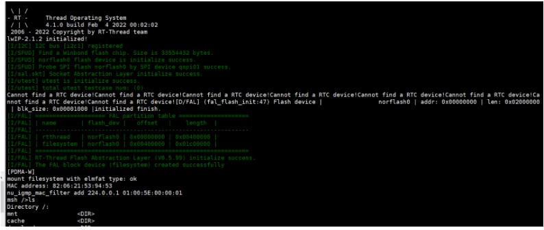

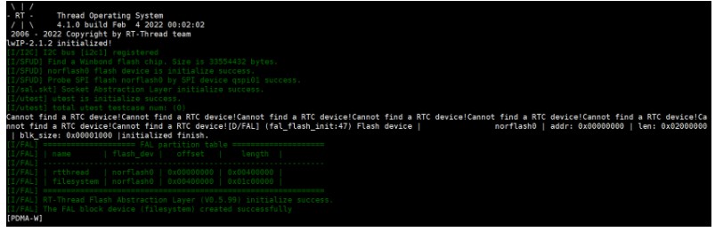

It is BUG, please find solution in below. Append SYS_UnlockReg/SYS_LockReg to un-lock protected register in rtt_port/drv_sys.c. void nu_sys_ip_reset(E_SYS_IPRST eIPRstIdx) { uint32_t volatile u32IPRSTRegAddr; uint32_t u32IPRSTRegBit; rt_uint32_t level; if (eIPRstIdx >= SYS_IPRST_CNT) return; u32IPRSTRegAddr = REG_SYS_AHBIPRST + (4ul * (eIPRstIdx / 32)); u32IPRSTRegBit = eIPRstIdx % 32; /* Enter critical section */ level = rt_hw_interrupt_disable(); /* Unlock write-protect */ SYS_UnlockReg(); /* Enable IP reset */ outpw(u32IPRSTRegAddr, inpw(u32IPRSTRegAddr) | (1 << u32IPRSTRegBit)); /* Disable IP reset */ outpw(u32IPRSTRegAddr, inpw(u32IPRSTRegAddr) & ~(1 << u32IPRSTRegBit)); /* Wait it done. */ while (inpw(u32IPRSTRegAddr) & (1 << u32IPRSTRegBit)) {} /* Lock write protect */ SYS_LockReg(); /* Leave critical section */ rt_hw_interrupt_enable(level); }
