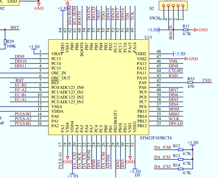

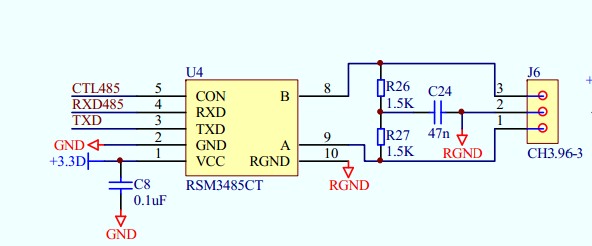

原子哥,我是菜鸟加新手,我弄了一个stm的串口程序,用keil调试时串口数据寄存器值是一直是0,不知道原因,能够帮我看看程序有问题吗
#include "STM32f10x.h" void RCC_Configuration(void); void Delay(uint32_t delaytime); void GPIO_Configuration(void); void USART_Configuration(void); int main(void) { RCC_Configuration(); GPIO_Configuration(); USART_Configuration(); GPIO_ResetBits(GPIOA,GPIO_Pin_11); //485只发送 while (1) { USART_SendData(USART1, (u8) 0xa4); while(USART_GetFlagStatus(USART1, USART_FLAG_TC) == RESET) { } Delay(0xaffff); } } void RCC_Configuration(void) { SystemInit(); RCC_APB2PeriphClockCmd(RCC_APB2Periph_GPIOA | RCC_APB2Periph_USART1, ENABLE); RCC_APB2PeriphClockCmd(RCC_APB2Periph_AFIO, ENABLE); } void GPIO_Configuration(void) { GPIO_InitTypeDef GPIO_InitStructure; /*TX在PA9,配置为推挽*/ GPIO_InitStructure.GPIO_Pin = GPIO_Pin_9; GPIO_InitStructure.GPIO_Speed = GPIO_Speed_50MHz; GPIO_InitStructure.GPIO_Mode = GPIO_Mode_AF_PP; GPIO_Init(GPIOA, &GPIO_InitStructure); GPIO_InitStructure.GPIO_Pin = GPIO_Pin_10; GPIO_InitStructure.GPIO_Speed = GPIO_Speed_50MHz; GPIO_InitStructure.GPIO_Mode = GPIO_Mode_IN_FLOATING; GPIO_Init(GPIOA,&GPIO_InitStructure); GPIO_InitStructure.GPIO_Pin = GPIO_Pin_11 ; GPIO_InitStructure.GPIO_Speed = GPIO_Speed_50MHz; GPIO_InitStructure.GPIO_Mode = GPIO_Mode_Out_PP; GPIO_Init(GPIOA, &GPIO_InitStructure); } void USART_Configuration(void) { USART_InitTypeDef USART_InitStructure; USART_InitStructure.USART_BaudRate = 115200; USART_InitStructure.USART_WordLength = USART_WordLength_8b; USART_InitStructure.USART_StopBits = USART_StopBits_1; USART_InitStructure.USART_Parity = USART_Parity_No; USART_InitStructure.USART_HardwareFlowControl = USART_HardwareFlowControl_None; USART_InitStructure.USART_Mode = USART_Mode_Rx | USART_Mode_Tx; USART_Init(USART1,&USART_InitStructure); USART_Cmd(USART1,ENABLE); } void Delay(uint32_t delaytime) { for(;delaytime>0;delaytime--); } |

串口波特率匹配问题。谢谢
