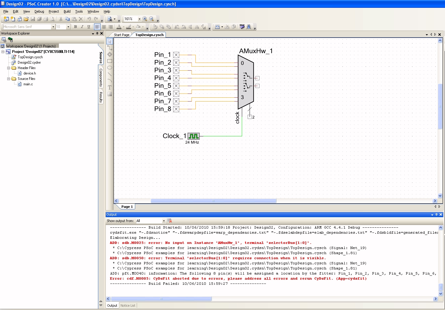

总之,我需要将输入数据复用到ADC中。首先,我想把MUX管脚带到外面的世界。如何使用总线到2个外部数字引脚?它是怎么做的?
基思 新-1.JPG 626.9 K 以上来自于百度翻译 以下为原文 All, I am needing to Mux the input data into an ADC. For starters, I would like to bring the MUX pins to the outside world. How do I use the BUS to 2 external digital pins? How is it done schematicaly? Keith

嗨,基思,
硬件AMOX组件支持模拟引脚作为多路复用器输入通道的输入。 选择线可以是数字输入引脚。由于在这种情况下的设计需要2个选择线在4对输入模拟通道之间进行选择,所以可以使用数字输入引脚。 在配置框中,您可以选择“引脚数”为2。并选择映射到“显示为总线”。 现在,当您将选择线连接到引脚时,导线看起来更厚(这表明它是总线,而不是单线)。 在CYDWR中,引脚可以根据您的方便选择。 让我们知道这是否有帮助。 当做, DASG 以上来自于百度翻译 以下为原文 Hi Keith, Hardware AMux Component supports Analog Pins as input at the multiplexer input channels. The Select lines can be Digital Input Pins. Since your design in this case requires 2 select lines to choose between the 4 pairs of the input Analog Channels, you can use Digital Input Pin. In the Configuration Box, you can choose the 'Number of Pins' to 2. And also Select the mapping to 'Display as Bus'. Now, when you connect the select lines to the pin, the wire appears to be thicker (which is an indication that it is a Bus, not a single wire). In .cydwr, the pins can be chosen according to your convenience. Let us know if this helps. Regards, dasg |
