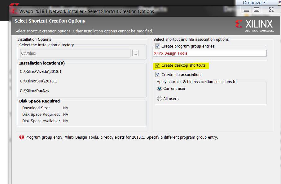

I have successfully installed Vivado 2018.2 WebPack on: Win 10 PCs. 64 bit dell inspiron 15 5000 series
The installer says it has successfully completed, but the Start Menu Group for Xilinx tools is not created nor are the Desktop icons.
I have repeated for  vivado 2017.4 WebPack, then  vivado 2016.4 WebPack. and 2015.4
Same result.
I attempt to run C;XilinxVivado201?binunwrappedwin64.ioVivado.exe  and always get the following series of errors:
The program can't start because librdi_commonmain.dll is missing from your computer. Try reinstalling the program to fix this problem.
The program can't start because librdi_common.dll is missing from your computer. Try reinstalling the program to fix this problem.
The program can't start because SHSMP64.dll is missing from your computer. Try reinstalling the program to fix this problem.
The program can't start because libboost_signals.dll is missing from your computer. Try reinstalling the program to fix this problem.
Vivado then fails to launch.
I have uninstalled all Xilinx tools, restarted the PC and attempted a fresh install again. I get the same results. I have administrator rights on this PC.
I have installed and updated Microsoft Visual C++ Redistributable 2015  and Microsoft Visual C++ Redistributable 2017
lots of reboots.
and i cant find the 4 DLL to install by hand.
Any suggestions on how to proceed?

Hi @timothy4g,
1. To get the vivado shortcut you can run networkShortcutSetup.exe from C:Xilinx.xinstallVivado_2018.1bin and click on shortcut as shown below.
2. Make sure you are using Windows 10.0 Fall Creators update (version 1709) OR 10.0 Version 1803 (64-bit), English/Japanese. If not, please update it.
3. Then, issue still exists - reinstall the microsoft redistributables 2015 and reboot the machine.
Regards,
hemangd

Hi
 Thank for you suggestions.
I uninstalled  microsoft redistributables 2015  and the 6 other versions.
then  installed  microsoft redistributables 2015    x86 and 64 versions
then rebooted.
I then ran networkShortcutSetup.exe
Xilinx Design Tools group    was taken so i named it xilinx.
I ran and calmed successful
then rebooted.
Still  no icon. sill not in start menu. Sill lacking the same DLL when i try to run
 C;XilinxVivado2018.2binunwrappedwin64.ioVivado.exe
Any more suggestions on how to proceed?
