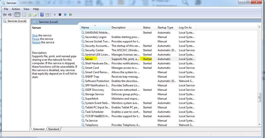

Vivado Webpack 2017.3安装失败
我启动setup exe并显示“提取”窗口,然后显示权限提升请求。
当我按“是”时,设置只是静默停止,没有任何反应。
任何想法如何解决它?

Hello @fandrei,
I have been talking to some other install experts and it turns out that we have seen some other users with the similar issue before and the issue was due to the fact that if the Vivado installer of any versions cannot be launched on Windows, you’d need to check the services settings for the status of 'Server' service. It seems our installer need this service running.
Can you please double check if this is up and running in your case? See my screenshot below.
If it's not running, can you start this up and then see if the installer can successfully be started then? Thanks

Hi @fandrei,
1. Which OS and its version are you using for Vivado Webpack 2017.3 ?
2. Have a look at this AR which may help you on this issue. https://www.xilinx.com/support/answers/60118.html
3. Have you installed microsoft redistributable 2015 on your machine? If not, please install it first.

1. Windows 7 x64
2. This article looks very outdated. For instance, the setup file isn't named xsetup.exe anymore
3. Which redistributable? If you mean VC++ 2015 redist - I have only the VC++ 2017 redistributable installed, and the version from 2015 can't be installed when the later version is present.

Hi @fandrei,
1. VC++ 2015 requires for Vivado 2017.3 . You have to install it. To download it you can go through https://www.microsoft.com/en-us/download/details.aspx?id=52685     - After installing it, you need to reboot your system.
2. And can you provide the snapshot of the error message or any last pop up you face before it fails silently?
3. Also try to make your antivirus inactive for sometime while installing Vivado if you are using any on your machine.
