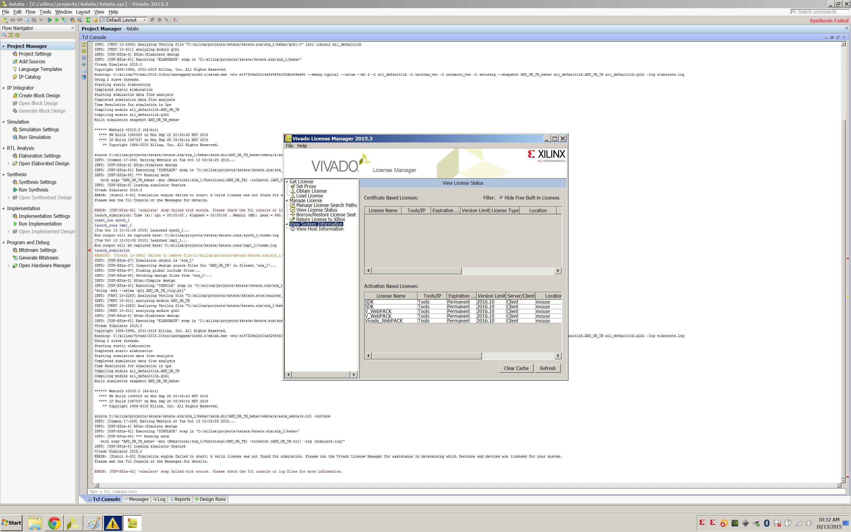

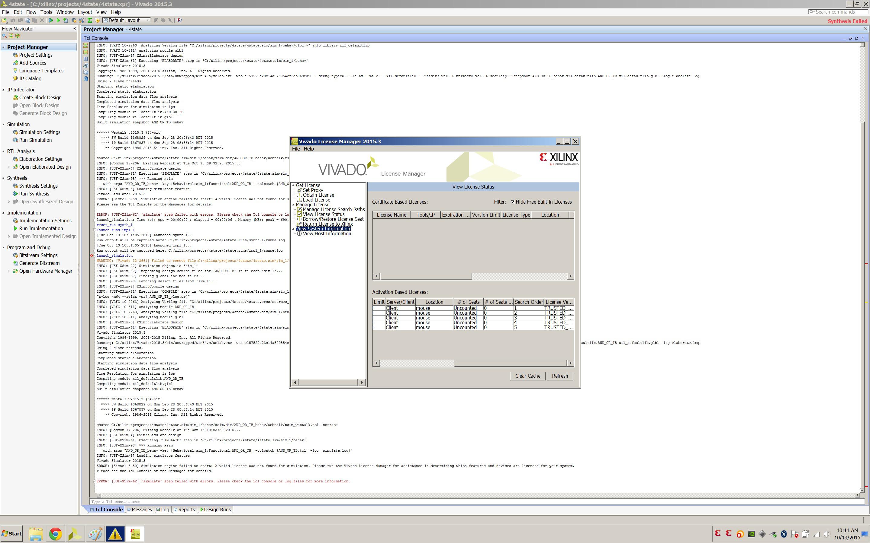

Sucessful webpack licence activation, but unable to synthesize or simulate.
I have read all the messages on this topic I can find. None of the things I try work. Anti-virus is disabled. I am logged in as admin. I run the software as admin.
"Run < Server Tools Directory>win64.oinstallanchorservice.exe." fails due to missing DLL. I add that DLL and verify it, and it still fails.
I uninstalled/deleted, re-downloaded and the same thing happens.
I have worked with a training provider and local field engineer. No one can seem to get the Vivado web pack to work with the licence.
I have started with a fresh install, used the licence manager to aquire a licence, it tells me it was sucessful, But I get an error out of synthesis or simulation. I am using the XC7A35t device.
It is a windows 7 ultimate OS, Vivado WebPack 2015.3
I attached the licence xml and the error screens.
Please help. Despirate.
Thank you
            Xilinx_License (3).xml ‏3 KB

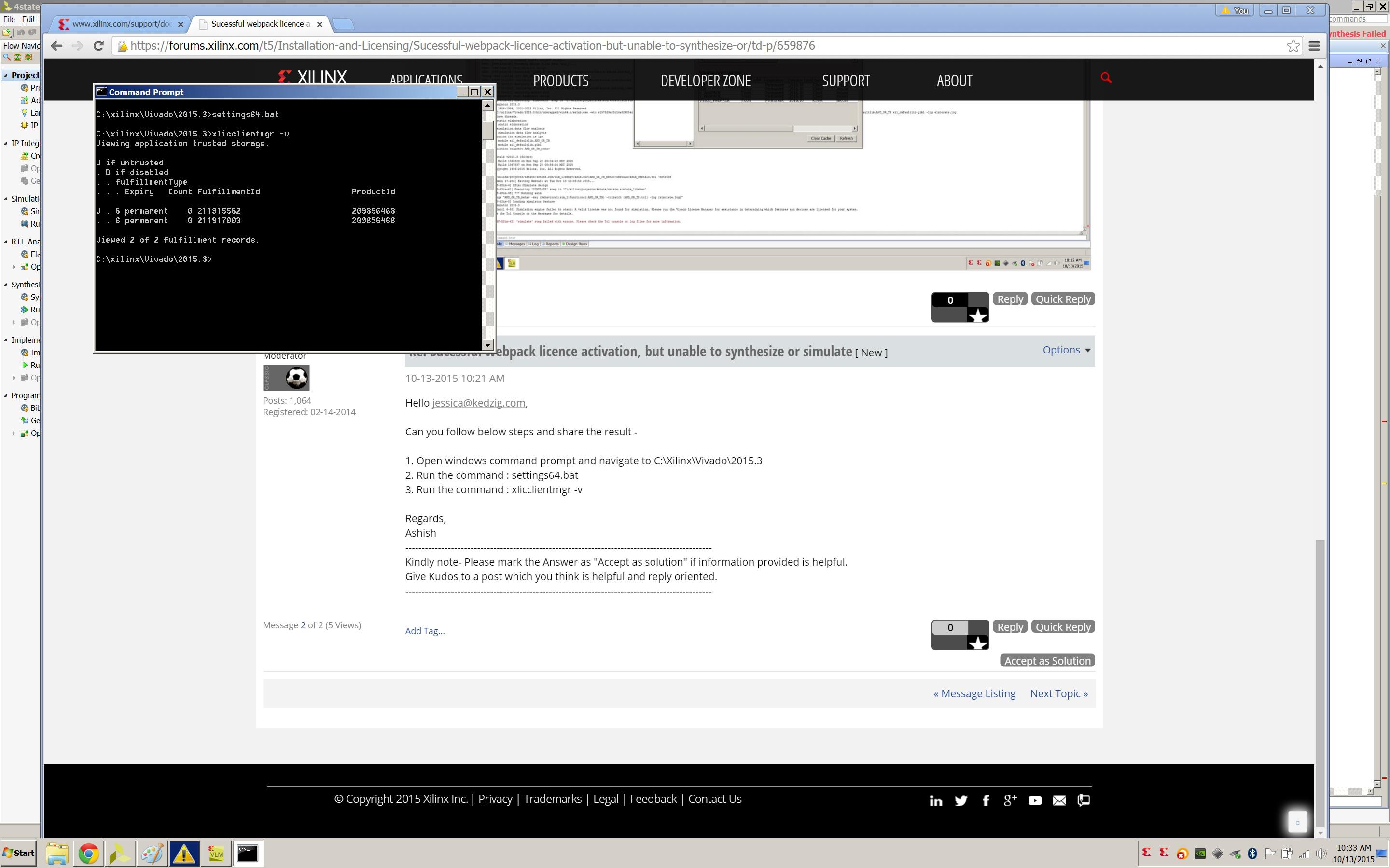

Hello jessica@kedzig.com,
Can you follow below steps and share the result -
1. Open windows command prompt and navigate to C:XilinxVivado2015.3
2. Run the command : settings64.bat
3. Run the command : xlicclientmgr -v

Hi,
I attached the result. Any idea?
From the output, it seems that license has gone 'untrusted' (U). Check below AR to know reasons for this
http://www.xilinx.com/support/answers/63683.html
Have you done any of these operations?

no,
not that I am aware of. the only thing I have done on the machine for the last week is try to get Vivado to work.
