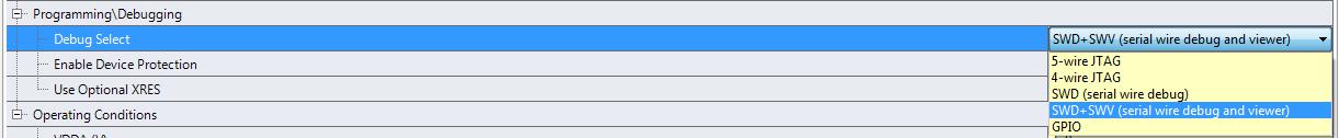

CY8C3666 LTI-068可以使用7,8,10引脚进行编程/调试吗?
我使用CY8C3666 Lti-068。
即使PIN NO 7,8和10是多功能(GPIO),我也不能在PSoC为GPIO击溃它。
我能用PIN NO7,8,10只用于编程/调试吗?

如果在调试选择选项中将这些引脚选择为GPIO或SWD,您是否可以检查CydWr的系统选项卡,即设计范围的资源文件?
您需要选择PIN函数作为GPIO,这将允许路由到这些引脚的信号。在这种情况下,您仍然能够通过这些引脚编程设备,但不使用这些引脚进行调试。
以上来自于百度翻译
     以下为原文
  Can you check in the System tab of .cydwr i.e. the design wide resources file, if these pins are selected as GPIO or SWD in the Debug select option?
You need to chose the pin function as GPIO, this will allow routing signals to these pins. In this case, you will still be able to program the device through these pins but not use these pins for debugging.
