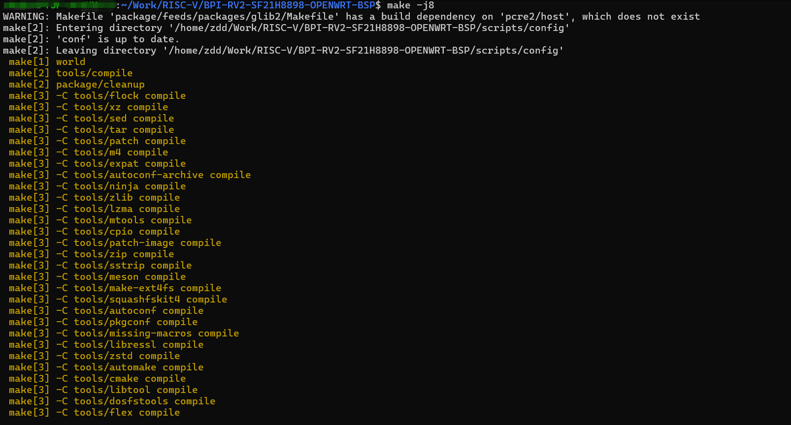

开始编译:
# build your firmware. This will download all sources,
# build the cross-compile toolchain and then cross-compile the GNU/Linux kernel
# & all chosen applications for your target system.
make -j8
剩下就是耐心等待,修复一些异常了。
