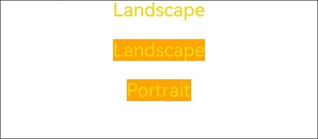

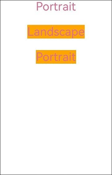

下例中使用媒体查询,实现屏幕横竖屏切换时,给页面文本应用添加不同的内容和样式。
Stage模型下的示例:
import mediaquery from '@ohos.mediaquery';import window from '@ohos.window';import common from '@ohos.app.ability.common';@Entry@Componentstruct MediaQueryExample { @State color: string = '#DB7093'; @State text: string = 'Portrait'; @State portraitFunc:mediaquery.MediaQueryResult|void|null = null; // 当设备横屏时条件成立 listener:mediaquery.MediaQueryListener = mediaquery.matchMediaSync('(orientation: landscape)'); // 当满足媒体查询条件时,触发回调 onPortrait(mediaQueryResult:mediaquery.MediaQueryResult) { if (mediaQueryResult.matches as boolean) { // 若设备为横屏状态,更改相应的页面布局 this.color = '#FFD700'; this.text = 'Landscape'; } else { this.color = '#DB7093'; this.text = 'Portrait'; } } aboutToAppear() { // 绑定当前应用实例 // 绑定回调函数 this.listener.on('change', (mediaQueryResult:mediaquery.MediaQueryResult) => { this.onPortrait(mediaQueryResult) }); } // 改变设备横竖屏状态函数 private changeOrientation(isLandscape: boolean) { // 获取UIAbility实例的上下文信息 let context:common.UIAbilityContext = getContext(this) as common.UIAbilityContext; // 调用该接口手动改变设备横竖屏状态 window.getLastWindow(context).then((lastWindow) => { lastWindow.setPreferredOrientation(isLandscape ? window.Orientation.LANDSCAPE : window.Orientation.PORTRAIT) }); } build() { Column({ space: 50 }) { Text(this.text).fontSize(50).fontColor(this.color) Text('Landscape').fontSize(50).fontColor(this.color).backgroundColor(Color.Orange) .onClick(() => { this.changeOrientation(true); }) Text('Portrait').fontSize(50).fontColor(this.color).backgroundColor(Color.Orange) .onClick(() => { this.changeOrientation(false); }) } .width('100%').height('100%') }}FA模型下的示例:
import mediaquery from '@ohos.mediaquery';import featureAbility from '@ohos.ability.featureAbility';@Entry@Componentstruct MediaQueryExample { @State color: string = '#DB7093'; @State text: string = 'Portrait'; @State portraitFunc:mediaquery.MediaQueryResult|void|null = null; listener:mediaquery.MediaQueryListener = mediaquery.matchMediaSync('(orientation: landscape)'); // 当设备横屏时条件成立 onPortrait(mediaQueryResult:mediaquery.MediaQueryResult) { // 当满足媒体查询条件时,触发回调 if (mediaQueryResult.matches as boolean) { // 若设备为横屏状态,更改相应的页面布局 this.color = '#FFD700'; this.text = 'Landscape'; } else { this.color = '#DB7093'; this.text = 'Portrait'; } } aboutToAppear() { // 绑定当前应用实例 this.listener.on('change', (mediaQueryResult:mediaquery.MediaQueryResult) => { this.onPortrait(mediaQueryResult) }); //绑定回调函数 } build() { Column({ space: 50 }) { Text(this.text).fontSize(50).fontColor(this.color) Text('Landscape').fontSize(50).fontColor(this.color).backgroundColor(Color.Orange) .onClick(() => { let context = featureAbility.getContext(); context.setDisplayOrientation(0); //调用该接口手动改变设备横竖屏状态 }) Text('Portrait').fontSize(50).fontColor(this.color).backgroundColor(Color.Orange) .onClick(() => { let context = featureAbility.getContext(); context.setDisplayOrientation(1); //调用该接口手动改变设备横竖屏状态 }) } .width('100%').height('100%') }}
图1 竖屏
图2 横屏
