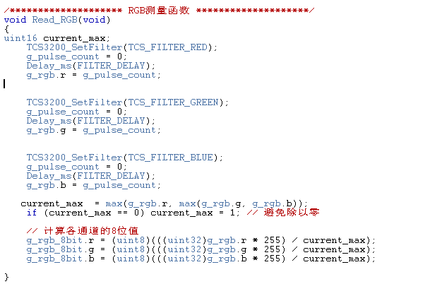

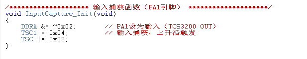

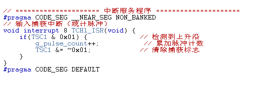

使用MC68HC908QT4去控制TCS3200感光传感器,在输入捕获中卡住了,不知道为什么一直处于捕获中,不能执行主程序内容,代码如下 望大佬们指教 |
2个回答
#include
#include "stdlib.h" #include #include #include "derivative.h" #pragma LINK_INFO DERIVATIVE "MC68HC908QT4" // --------------------- 系统配置 --------------------- #define SYS_CLK 3200000UL // 系统时钟3.2MHz #define PWM_PRESCALER 4 // PWM分频系数(定时器时钟=800kHz) #define FILTER_DELAY 100 // 滤波器切换后稳定时间(ms) //#define uint16 unsigned int #define uint8 unsigned char #define uint16 unsigned short int #define uint32 unsigned long int #define max(x,y) ((x) > (y) ? (x) :(y)) #define min(x,y) ((x) < (y) ? (x) : (y)) // --------------------- 数据结构定义 --------------------- typedef struct { volatile uint16 r; // 红色通道频率 volatile uint16 g; // 绿色通道频率 volatile uint16 b; // 蓝色通道频率 } RGB_Data; typedef struct { uint8 r; // 红色通道(0-255) uint8 g; // 绿色通道(0-255) uint8 b; // 蓝色通道(0-255) } RGB_8Bit; typedef struct{ unsigned int h; //[0,360] unsigned char s; //[0,100] unsigned char l; //[0,100] }COLOR_HSL;//HSL typedef struct { float lower_hue; float upper_hue; const char* color_name; } ColorRange; // --------------------- TCS3200控制参数 --------------------- typedef enum { TCS_FILTER_RED = 0, // S2=0, S3=0 → 红色滤波器 TCS_FILTER_BLUE = 1, // S2=1, S3=0 → 蓝色滤波器 TCS_FILTER_GREEN = 2, // S2=0, S3=1 → 绿色滤波器 TCS_FILTER_CLEAR = 3 // S2=1, S3=1 → 无滤波器 } TCS_ColorFilter; // --------------------- 全局变量 --------------------- volatile uint16 g_pulse_count = 0; // 脉冲计数器 volatile uint8 g_current_filter = 0; // 当前滤波器:0-Red,1-Green,2-Blue RGB_8Bit g_rgb_8bit; // 存储归一化后的RGB值 RGB_Data g_rgb; // 存储RGB测量结果 COLOR_HSL hsl; //HSL volatile uint16 g_pwm_freq = 5200; // PWM目标频率(默认1kHz) ColorRange color_ranges[] = { {0, 15, "Red"}, {15, 30, "Red-Orange"}, {30, 45, "Orange"}, {45, 60, "Yellow-Orange"}, {60, 75, "Yellow"}, {75, 90, "Yellow-Green"}, {90, 150, "Green"}, {150, 180, "Blue-Green"}, {180, 210, "Cyan"}, {210, 240, "Indigo"}, {240, 270, "Blue"}, {270, 300, "Magenta"}, {300, 330, "Purple-Red"}, {330, 360, "Red"} // 共14项 }; // --------------------- 函数声明 --------------------- void SystemInit(void); void TCS3200_Init(void); void TCS3200_SetFilter(TCS_ColorFilter filter); void PWM_Init(uint16 freq); void InputCapture_Init(void); void Read_RGB(void); uint16 Measure_Frequency(void); void Set_PWM_Freq(uint16 target_freq); void Delay_ms(uint16 ms); void RGBtoHSL(RGB_Data *Rgb, COLOR_HSL *Hsl); void judgeColor(RGB_Data *Rgb) ; uint8 flag =0 ; // ===================== 中断服务程序 ===================== #pragma CODE_SEG __NEAR_SEG NON_BANKED // 输入捕获中断(统计脉冲) void interrupt 5 TCH1_ISR(void) { if(TSC1 & 0x80) { // 检测到上升沿 flag = 1; // g_pulse_count++; // 累加脉冲计数 TSC1 &= ~0x80; // 清除捕获标志 } } #pragma CODE_SEG DEFAULT /******************** 主程序 ********************/ void main(void) { SystemInit(); // 系统初始化 TCS3200_Init(); // 初始化TCS3200 PWM_Init(g_pwm_freq); // 初始化PWM(默认1kHz) InputCapture_Init(); // 初始化输入捕获 for(;;) { // Read_RGB(); // 更新RGB测量值到g_rgb if(flag){ Set_PWM_Freq (1200);} // 示例:根据红色通道亮度调整PWM频率 } } /******************** RGB测量函数 ********************/ void Read_RGB(void) { uint16 current_max; TCS3200_SetFilter(TCS_FILTER_RED); g_pulse_count = 0; Delay_ms(FILTER_DELAY); g_rgb.r = g_pulse_count; TCS3200_SetFilter(TCS_FILTER_GREEN); g_pulse_count = 0; Delay_ms(FILTER_DELAY); g_rgb.g = g_pulse_count; TCS3200_SetFilter(TCS_FILTER_BLUE); g_pulse_count = 0; Delay_ms(FILTER_DELAY); g_rgb.b = g_pulse_count; current_max = max(g_rgb.r, max(g_rgb.g, g_rgb.b)); if (current_max == 0) current_max = 1; // 避免除以零 // 计算各通道的8位值 g_rgb_8bit.r = (uint8)(((uint32)g_rgb.r * 255) / current_max); g_rgb_8bit.g = (uint8)(((uint32)g_rgb.g * 255) / current_max); g_rgb_8bit.b = (uint8)(((uint32)g_rgb.b * 255) / current_max); } /******************** TCS3200控制函数 ********************/ void TCS3200_Init(void) { DDRA |= 0x30; // PA4(S2)、PA5(S3)设为输出 PTA &= ~0x30; // 初始状态:红色滤波器 } void TCS3200_SetFilter(TCS_ColorFilter filter) { switch(filter) { case TCS_FILTER_RED: PTA = (PTA & ~0x30) | 0x00; break; case TCS_FILTER_BLUE: PTA = (PTA & ~0x30) | 0x20; break; case TCS_FILTER_GREEN: PTA = (PTA & ~0x30) | 0x30; break; case TCS_FILTER_CLEAR: PTA = (PTA & ~0x30) | 0x10; break; } } void PWM_Init(uint16 freq) { uint16 tmod; // 配置PA0为PWM输出(TCH0功能) DDRA |= 0x01; // PA0设为输出 // 计算周期和比较值(占空比50%) tmod = (SYS_CLK / (PWM_PRESCALER * freq)) - 1; TMODH = (tmod >> 8) & 0xFF; TMODL = tmod & 0xFF; TCH0H = (tmod / 2) >> 8; TCH0L = (tmod / 2) & 0xFF; // 定时器通道0配置:输出比较,翻转电平 TSC0 = 0x16; // TOV=0, CHMAX=0, MS0A=1, ELS0=2(翻转模式) TSC = 0x02; // 分频4,启动定时器 } /******************** PWM输出函数(PA0引脚) ********************/ void Set_PWM_Freq(uint16 target_freq) { uint16 tmod; tmod = (SYS_CLK / (PWM_PRESCALER * target_freq)) - 1; DisableInterrupts; TMODH = (tmod >> 8) & 0xFF; TMODL = tmod & 0xFF; TCH0H = (tmod / 2) >> 8; TCH0L = (tmod / 2) & 0xFF; EnableInterrupts; } /******************** 输入捕获函数(PA1引脚) ********************/ void InputCapture_Init(void) { DDRA &= ~0x02; // PA1设为输入(TCS3200 OUT) TSC1 = 0x44; // 输入捕获,上升沿触发 TSC |= 0x02; // 分频4(与PWM共用定时器) } /******************** 系统初始化函数 ********************/ void SystemInit(void) { OSCTRIM = *(uint8*)0xFFC0; // 时钟微调 CONFIG1 = 0x00; // 关闭看门狗 CONFIG2 = 0x40; // 启用IRQ中断 } /******************** 简单延时函数 ********************/ void Delay_ms(uint16 ms) { uint16 i,j; for( i=0; ir, Rgb->g), Rgb->b); int rgbMin = min(min(Rgb->r, Rgb->g), Rgb->b); // printf("\n Rgb->r, Rgb->g, Rgb->b =%d =%d =%d\n ",Rgb->r, Rgb->g, Rgb->b); int temp,temp2; //hue[flatten] temp2=(rgbMax - rgbMin); if (abs(rgbMax - rgbMin) < precision) // max == min { Hsl->h = 0; } else if (abs(rgbMax - Rgb->r) < precision) // max == r { temp = Rgb->g - Rgb->b;// / (rgbMax - rgbMin); temp*=60; temp/=temp2; if (Rgb->g < Rgb->b) temp += 360; Hsl->h=(uint16)temp; } else if (abs(rgbMax - Rgb->g) < precision) // max == g { temp=Rgb->b - Rgb->r; temp*=60; temp/=temp2; temp += 120; Hsl->h=(uint16)temp; //Hsl->h = 60 * (Rgb->b - Rgb->r) / (rgbMax - rgbMin) + 120; } else if (abs(rgbMax - Rgb->b) < precision) // max == b { temp=Rgb->r - Rgb->g; temp*=60; temp/=temp2; temp += 240; Hsl->h=(uint16)temp; //Hsl->h = 60 * (Rgb->r - Rgb->g) / (rgbMax - rgbMin) + 240; } // light temp= (rgbMax + rgbMin) / 2; Hsl->l=(uint8)temp; // saturation if (temp <= precision || abs(rgbMax - rgbMin) < precision) { Hsl->s = 0; } else if (temp > 0 && temp <= 0.5) { temp=rgbMax - rgbMin; temp2=rgbMax + rgbMin; temp/=temp2; Hsl->s=(uint16)temp; //Hsl->s = (rgbMax - rgbMin) / (rgbMax + rgbMin); } else if (temp > 0.5) { temp=rgbMax - rgbMin; temp*=100; temp2=rgbMax + rgbMin; temp2=510-temp2; temp/=temp2; Hsl->s=(uint16)temp; //Hsl->s = (rgbMax - rgbMin) / (2 - (rgbMax + rgbMin)); } } // 2. 修正函数实现 void judgeColor(RGB_Data *Rgb) { unsigned int ColorVoltage[16]={12000,11000,10000,9000,9500,8500,8000,7000,6500,6000,5000,4000,3000,2500,2000,12000}; int num_ranges,i; RGBtoHSL(&Rgb, &hsl); // Define the color range array num_ranges= sizeof(color_ranges) / sizeof(ColorRange); for ( i = 0; i < num_ranges; i++) { if (hsl.h >= color_ranges[i].lower_hue && hsl.h < color_ranges[i].upper_hue) { //输出频率 Set_PWM_Freq(ColorVoltage[i] ); } } } 完整代码如上 |
在使用MC68HC908QT4微控制器控制TCS3200感光传感器时,如果输入捕获功能卡住,导致主程序无法继续执行,可能是由于以下几个原因导致的。我们可以通过检查代码和硬件配置来逐步排查问题。 1. 输入捕获配置问题首先,确保输入捕获功能的配置是正确的。MC68HC908QT4的输入捕获功能通常通过定时器模块(Timer)来实现。你需要确保定时器的输入捕获通道已经正确配置,并且中断已经启用。 2. 中断服务程序问题输入捕获中断服务程序(ISR)需要正确处理捕获事件,并清除中断标志。如果中断标志没有清除,中断会一直触发,导致程序卡在中断服务程序中。 3. 主程序逻辑问题确保主程序逻辑不会因为等待输入捕获事件而卡住。如果主程序中有等待输入捕获事件的循环,可能会导致程序无法继续执行。 4. 硬件连接问题检查TCS3200传感器与MC68HC908QT4的硬件连接是否正确。确保传感器的输出信号正确连接到微控制器的输入捕获引脚,并且信号电平符合微控制器的输入要求。 5. 调试和验证使用调试工具(如仿真器或逻辑分析仪)来验证输入捕获信号是否正常,并且中断是否被正确触发。通过调试工具可以更直观地发现问题所在。 示例代码以下是一个简单的示例代码,展示了如何配置和使用输入捕获功能: 总结通过检查输入捕获的配置、中断服务程序、主程序逻辑以及硬件连接,应该能够找到问题所在并解决。如果问题仍然存在,建议使用调试工具进一步分析。 |
