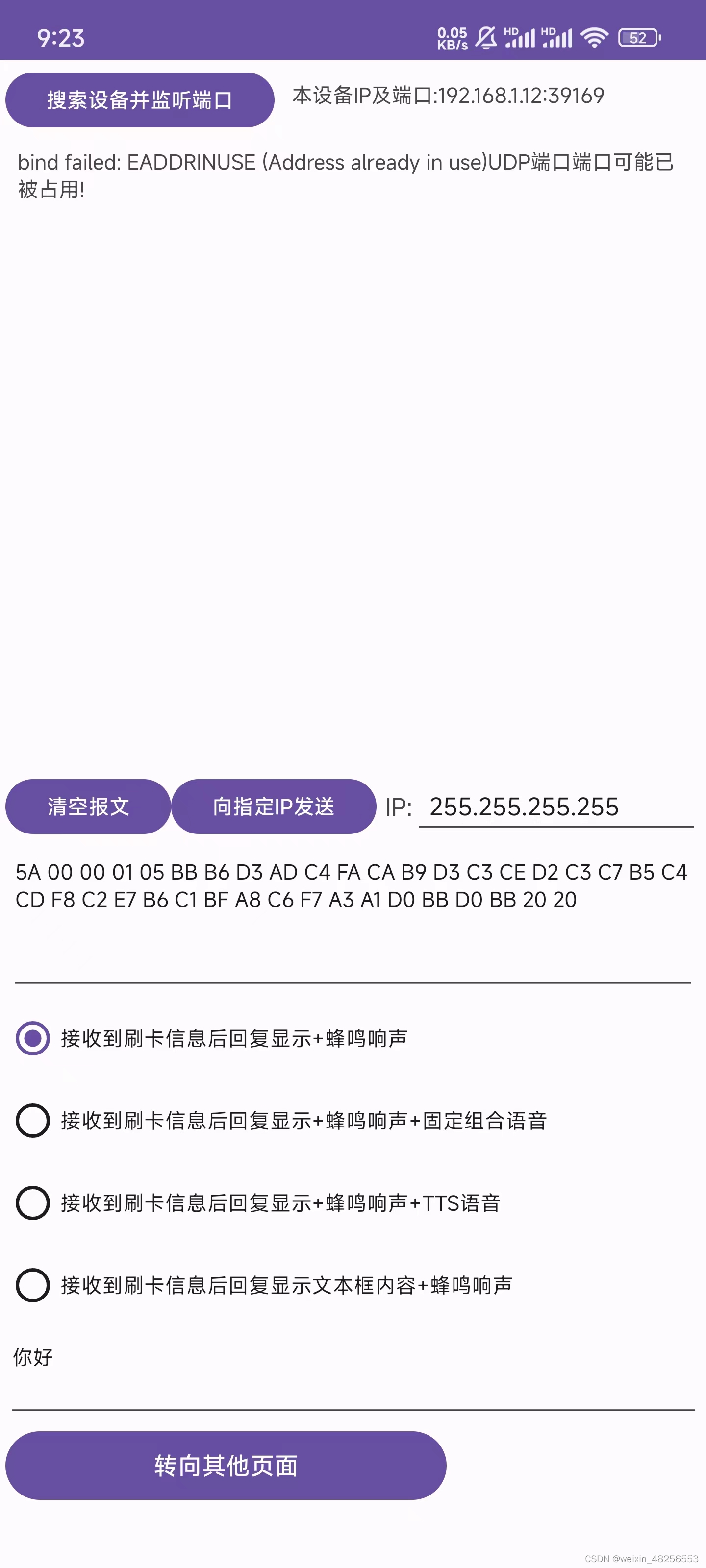

1.创建UDP套接字:
public void UDPServerActive(boolean isNeedActive){
if(isNeedActive) {
try {
if (mSocket != null) {
mSocket.close();
mSocket = null;
if (mRevPacket != null) {
mRevPacket = null;
mSocket = new DatagramSocket(mPort);
mRevPacket = new DatagramPacket(MyUdpData, 0, MyUdpData.length);
mSocket.setReuseAddress(true);
Recv.append("UDP套接字打开成功!\n\n");
} catch (Exception e) {
mSocket = null;
mRevPacket = null;
Recv.append(e.getMessage());
Recv.append("UDP端口端口可能已被占用!\n\n");
UDPServerUDPRead();

2.绑定端口
Myip = getIP();
mPort = DEFAULT_PORT;
IPandPortV.append(Myip+":"+Integer.toString(mPort));
UDPServerActive(true);
mPort的值等于指定的端口号,因为前面定义常量DEFAULT_PORT 值
private final static int DEFAULT_PORT = 39169;
