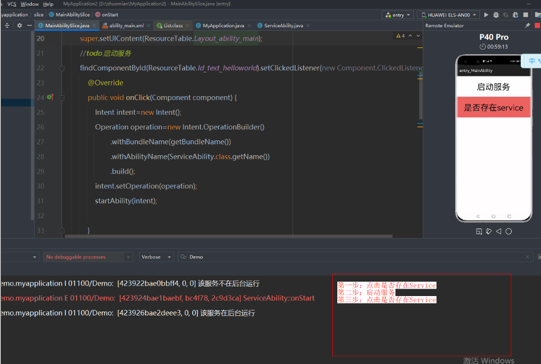

mainAbilitySlice代码实现
分别实现启动ServiceAbility和判断当前ServiceAbility是否在后台运行,代码如下
package com.newdemo.myapplication.slice;
import com.newdemo.myapplication.MyApplication;
import com.newdemo.myapplication.ResourceTable;
import ohos.aafwk.ability.AbilitySlice;
import ohos.aafwk.ability.RunningProcessInfo;
import ohos.aafwk.content.Intent;
import ohos.aafwk.content.Operation;
import ohos.agp.components.Component;
import ohos.hiviewdfx.HiLog;
import ohos.hiviewdfx.HiLogLabel;
import java.util.List;
public class MainAbilitySlice extends AbilitySlice {
private static final HiLogLabel LABEL_LOG = new HiLogLabel(3, 0xD001100, "Demo");
public void onStart(Intent intent) {
super.onStart(intent);
super.setUIContent(ResourceTable.Layout_ability_main);
findComponentById(ResourceTable.Id_text_helloworld).setClickedListener(new Component.ClickedListener() {
public void onClick(Component component) {
Intent intent=new Intent();
Operation operation=new Intent.OperationBuilder()
.withBundleName(getBundleName())
.withAbilityName(ServiceAbility.class.getName())
.build();
intent.setOperation(operation);
startAbility(intent);
findComponentById(ResourceTable.Id_isstartservice).setClickedListener(new Component.ClickedListener() {
if( MyApplication.getsingleton().getAbilities().size()>0){
if( MyApplication.getsingleton().getAbilities().get(0).isTerminating()){
HiLog.info(LABEL_LOG, "该服务不在后台运行");
}else {
HiLog.info(LABEL_LOG, "该服务在后台运行");
}else {
public void onActive() {
super.onActive();
public void onForeground(Intent intent) {
super.onForeground(intent);
运行效果
