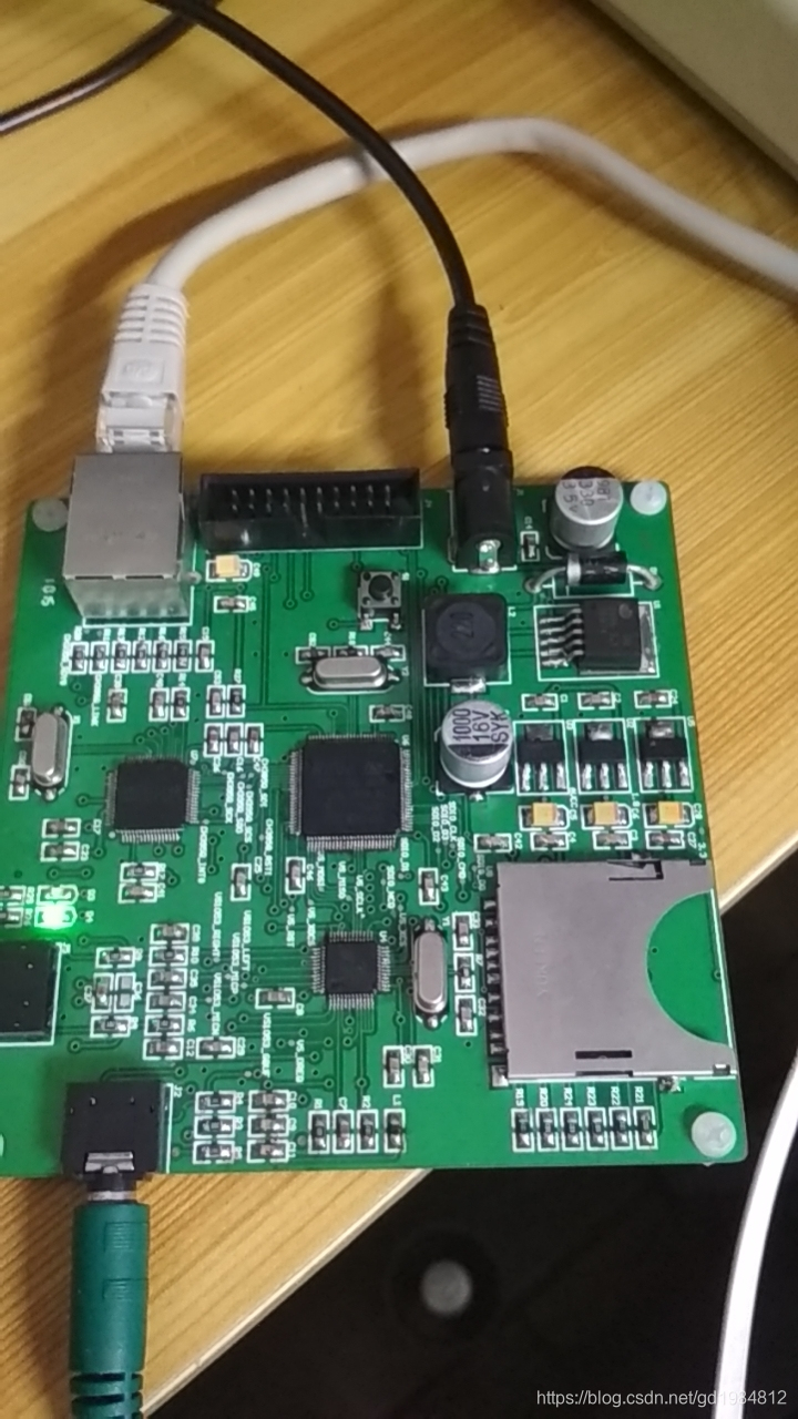

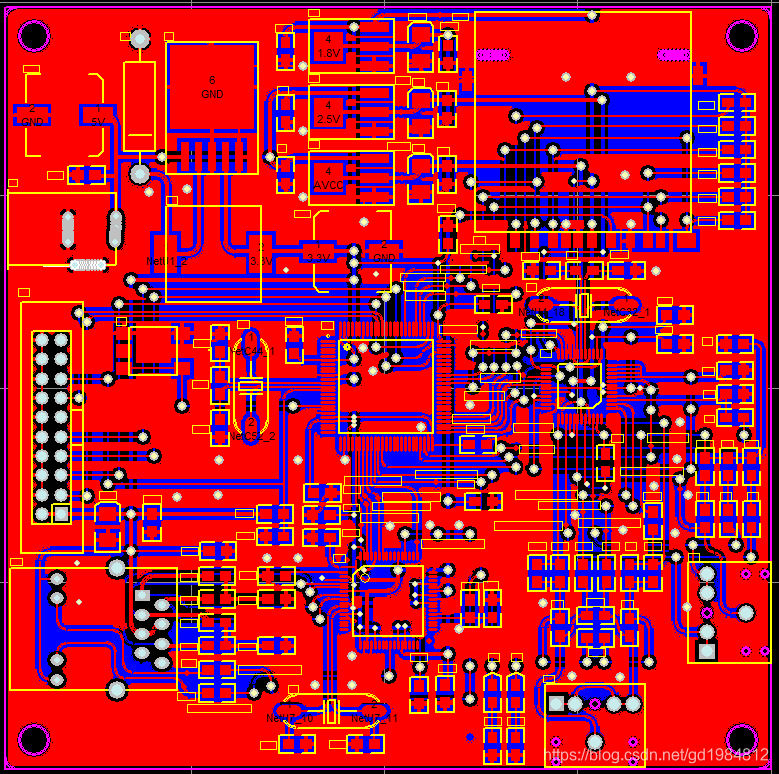

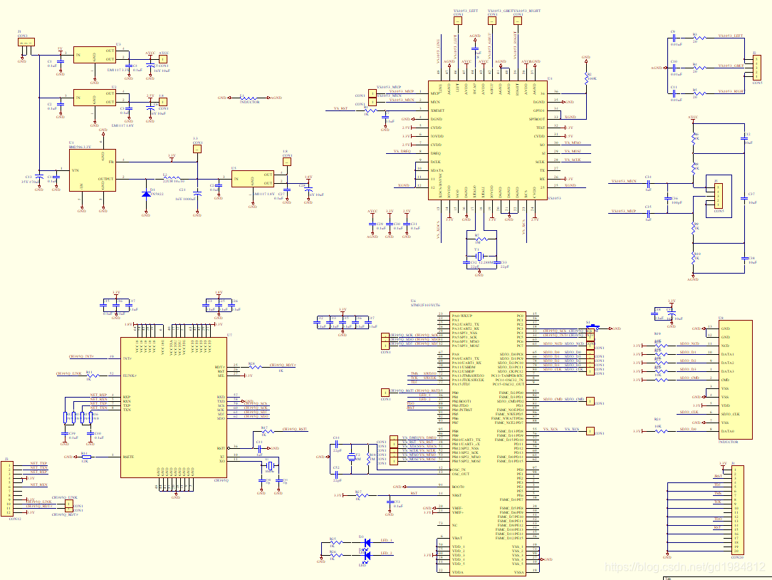

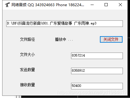

电子可以一边玩,一边研究,网络音频这个课题特别适合电子爱好者。几方面的挑战如下, 单片机实现对接以太网、实时对音频流解码播放,上位机配合单片机做音频流传输控制,音频信号的对接放大处理。在这里分享下资料,自己把这些关键技术整理下。
原理图
PCB
上位机
实物

C#上位机程序
- using System;
- using System.Collections.Generic;
- using System.ComponentModel;
- using System.Data;
- using System.Drawing;
- using System.Linq;
- using System.Text;
- using System.Threading.Tasks;
- using System.Windows.Forms;
- using System.Net.Sockets;
- using System.IO;
- using System.Net;
- using System.Threading;
- namespace WindowsFormsApplication12
- public partial class Form1 : Form
- IPEndPoint udpPoint; //本机IP地址,端口号
- IPEndPoint targetPoint; //服务器的IP地址,端口号
- IPEndPoint Remote;
- UdpClient udpClient;
- UdpClient udpRecvClient;
- int num = 0, readoffset = 0;
- byte[] byData = new byte[1024];
- private long Send_count;
- private long Recv_count;
- private long file_len;
- private long file_close = 0;
- private string file_nem;
- int Recv_flag;
- int Button_flag=0;
- Thread Sendthread;
- Thread Rcvethread;
- Thread Showthread;
- public Form1()
- InitializeComponent();
- udpPoint = new IPEndPoint(IPAddress.Parse("192.168.18.10"), 8888);
- targetPoint = new IPEndPoint(IPAddress.Parse("192.168.18.200"), 8888);
- Remote = new IPEndPoint(IPAddress.Any, 0);
- Showthread = new Thread(Showstate);
- Showthread.IsBackground = true;
- Showthread.Start();
- public delegate void CallSetTextbox();
- private void SetTextbox()
- try
- if (this.InvokeRequired)
- CallSetTextbox myCallSetTextbox = new CallSetTextbox(SetTextbox);
- this.Invoke(myCallSetTextbox);
- else
- textBox1.Text = file_len.ToString();
- catch { }
- private void SetSendTextbox()
- try
- CallSetTextbox myCallSetTextbox = new CallSetTextbox(SetSendTextbox);
- else
- textBox2.Text = Send_count.ToString();
- catch { }
- private void SetRecvTextbox()
- try
- CallSetTextbox myCallSetTextbox = new CallSetTextbox(SetRecvTextbox);
- else
- textBox3.Text = Recv_count.ToString();
- catch { }
- private void Showstate()
- while (true)
- SetTextbox();
- SetSendTextbox();
- SetRecvTextbox();
- private void Udp_SendFunction()
- try
- FileStream file = new FileStream(file_nem, FileMode.Open);//打开txt文件
- file_len=file.Length;
- file.Seek(0, SeekOrigin.Begin);
- while (true)
- if (Recv_flag == 1)
- Recv_flag = 0;
- num = file.Read(byData, readoffset, 1024);//读取txt文件内容
- udpClient.Send(byData, byData.Length, targetPoint);//发送数据
- Send_count = Send_count + 1024;
- if (num <= 0)
- //MessageBox.Show("完成");
- break;
- if (file_close == 1)
- file_close = 0;
- break;
- file.Close();//关闭txt文件
- catch (IOException e)
- //MessageBox.Show("Send" + e.ToString());
- private void Udp_RecvFunction()
- //udpRecvClient = new UdpClient(udpPoint);//初始化udp
- while (true)
- try
- byte[] recBuffer = udpClient.Receive(ref Remote);
- if (recBuffer != null)
- Recv_flag = 1;
- Recv_count = Recv_count + recBuffer.Length;
- catch (Exception ex)
- //MessageBox.Show("Recv" + ex.ToString());
- private void button1_Click(object sender, EventArgs e)
- if (Button_flag == 0)
- file_close = 0;
- Send_count=0;
- Recv_count =0;
- file_len = 0;
- Button_flag = 1;
- udpClient = new UdpClient(udpPoint);//初始化udp
- using (OpenFileDialog ofd = new OpenFileDialog())
- if (ofd.ShowDialog() == DialogResult.OK) //如果点击的是打开文件
- textBox4.Text = ofd.FileName; //获取全路径文件名
- file_nem = ofd.FileName;
- Sendthread = new Thread(Udp_SendFunction);
- Sendthread.IsBackground = true;
- Sendthread.Start();
- Rcvethread = new Thread(Udp_RecvFunction);
- Rcvethread.IsBackground = true;
- Rcvethread.Start();
- button1.ForeColor= Color.FromArgb(255, 155, 0, 0);
- button1.Text = "关闭文件";
- label5.Text = "播放中 ...";
- else
- file_close = 1;
- Button_flag = 0;
- Send_count = 0;
- Recv_count = 0;
- file_len = 0;
- Sendthread.Abort();
- Rcvethread.Abort();
- button1.ForeColor = Color.FromArgb(255, 0, 155, 0);
- button1.Text = "打开文件";
- label5.Text = "已停止播放";
- udpClient.Close();
复制代码
