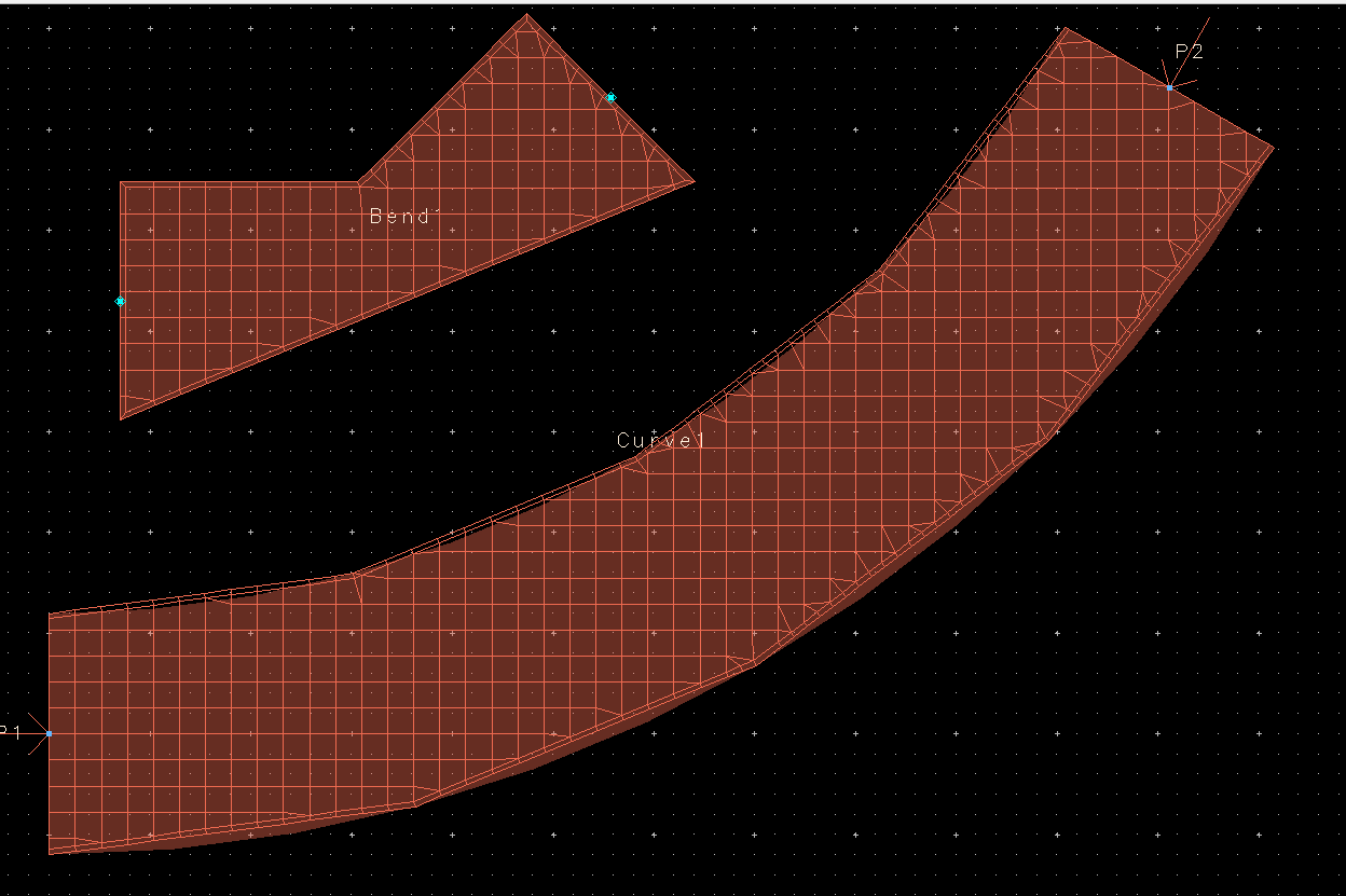

对于MCURVE,我的网格模拟似乎已关闭。

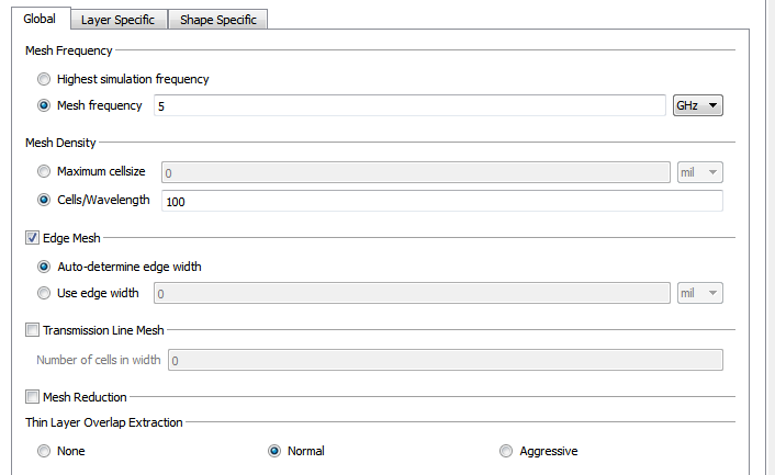

这是Bend和它的比较。 有什么想法吗? 我尝试使用网格选项,但我似乎无法确定是什么造成了这个问题。 2.PNG17.1 KB 以上来自于谷歌翻译 以下为原文 My mesh simulation seems to be off for the MCURVE. Here's a comparison of a Bend and it. Any ideas of the issue? I tried playing with the mesh options but I can't seem to pinpoint what's creating this issue. 附件 |

在“选项”>“预处理器”选项卡(“网格”选项卡之前的选项卡)下的emSetup中,将“简化布局”设置的圆弧分辨率设置为较小的值。
弧度分辨率为5度可能会更好。 以上来自于谷歌翻译 以下为原文 In the emSetup under Options > Preprocessor tab (the one just before the Mesh tab) set the arc resolution for the Simplify the Layout settings to something smaller. An arc resolution of 5 degrees would probably work better. |
