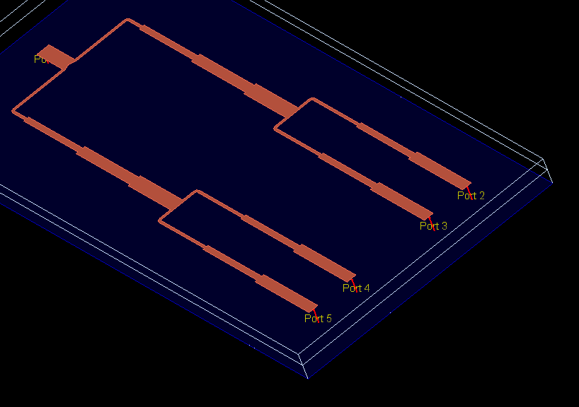

我正在设计一款4路wilkinson on ADS for rojer duriod 2010.2LM。
材料规格如下。 Er = 10.2 H = 0.635mm Hu = 11mm T = 35um tanD = 0.0023并且我相应地计算了长度和宽度它理想地是在5GHz-15GHz的频带中工作的宽带,我期望得到6.02左右的正向传输系数,但是 我得到了一些变化。 端口2和5给我类似的输出,而端口3和4(内部端口)给我类似的输出,但它们之间存在差异。 调整后,我已经能够将差距缩小到0.124db ...... !!! 我上传了项目文件,如果可以进行更多的调整,那将是一种享受... !!! 非常感谢1.lay4.7 KBMomentum_final1_mom.dds29.2 KB 以上来自于谷歌翻译 以下为原文 I am designing a 4 way wilkinson on ADS for rojer duriod 2010.2LM. material specs are as follows. Er=10.2 H=0.635mm Hu=11mm T=35um tanD=0.0023 and i have calculated the length and width accordingly It is wideband operating in frequency band of 5GHz-15GHz ideally, i expect to get the forward transmission coefficients around 6.02, but i get a bit of variation in it. port 2 and 5 give me similar output whereas port 3 and 4 (inner ones) give me similar output but there is a difference between them. After tuning, i have been able to reduce the gap to 0.124db...!!! i have uploaded the project files, if any more tuning is possible, it will be a treat...!!! thanks a lot 附件

嗨Anum,我设法将您的文件导入ADS2012,虽然翻译人员报告了一些丢失文件的问题(手动删除?)对于其他可能想要评论的读者,我附上了您的布局截图。 对于完整模型的EM仿真,我移除了顶盖并将其替换为开放边界。 正如您所报道的那样,我也看到传输是略微不对称的(~0.1dB),虽然布局看起来完全对称,并且EM网格中没有明显的不对称。 看起来真实。 我的解释是,这确实来自输出线之间的耦合。 它们都是同相的,但是相邻的线为“内部”线创造了与“外部”线不同的环境。 到目前为止,结果和方法看起来很好,有了最新的调整。 我单独模拟了两个阶段,这看起来很好。 隔离和输出匹配当然是关闭的,因为缺少电阻器。 为了更容易放置SMD电阻,您现在可能希望使用曲线或90°线段将布局更改为“环形”样式。 我附上了一个带有90°弯曲的旧设计的示例图片。 最好的问候Volker anum_layout.PNG17.5 KB 以上来自于谷歌翻译 以下为原文 Hi Anum, I managed to import your file into ADS2012, although the translator was reporting a few issues with missing files (removed manually?) For other readers who might want to comment, I have attached a screenshot of your layout. For EM simulation of the full model, I removed the top cover and replaced it by open boundary. As you reported, I also see that transmission is slighty asymmetrical (~ 0.1dB), although the layout seems to be perfectly symmetrical, and there are no obvious asymmtries in the EM mesh. Looks real. My interpretation is that this is indeed from coupling between the output lines. They are all in phase, but that adjacent lines creates a different environment for the "inner" lines than for the "outer" lines. Results and method look good so far, with your latest tweaks. I simulated the two stages individually and that looks fine to me. Isolation and output matching are of course off as along as the resistors are missing. For easier placement of the SMD resistors, you now might want to change your layout to "ring" style with either curved lines or 90° segments. I have attached an example picture from an old design with 90° bends. Best regards Volker 附件
lmksa 发表于 2018-12-21 10:52 非常感谢您对设计的详细分析和解释。 我肯定会在设计中采用这种戒指风格。 问候和祝福。 以上来自于谷歌翻译 以下为原文 Thanks a lot for your detailed analysis and explanation of the design. I'll definitely adopt this ring style in designs i'll make. Regards and best wishes. |
