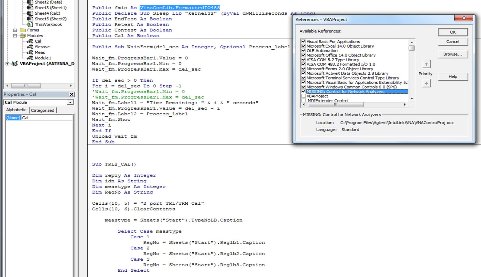

嗨,我正在尝试修改用excel编写的VB代码。
除了缺少参考之外,一切看起来都不错,这是“网络分析仪的控制”。 我安装了最新的Agilent IO库,但我怀疑这是其他的。 有谁知道我可以在哪里下载它? 我附上了截图。 谢谢 以上来自于谷歌翻译 以下为原文 Hi, I'm trying to modify a VB code written in excel. Everything looks ok apart from a missing reference, which is 'control for network analysers'. I've installed the latest Agilent IO libraries, but I suspect this from something else. Does anyone know where I can download it? I've attached a screenshot. Thanks 附件
1个回答
嗨,FormattedIO488库来自安捷伦IO库,您已经拥有它,但网络分析器控件不包含在IO库中,应该由其他人实现。
从我看到,丢失的VNA控件的位置是“C: Program Files Agilent Intuilink VNA VNAControlProj.ocx”,你安装了Intuilink软件吗? 似乎vna控件是Intuilink软件的一部分。 以上来自于谷歌翻译 以下为原文 Hi, the FormattedIO488 library is from Agilent IO Libraries and you already have it, but the network analyzer control is not included in IO Libraries and should be implemented by someone else. From what I see, the location of the missing VNA control is "C:Program FilesAgilentIntuilinkVNAVNAControlProj.ocx", have you installed the Intuilink software? It seems the vna control is part of the Intuilink software. |
