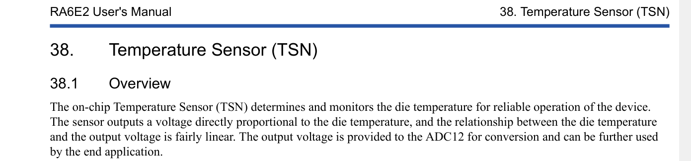

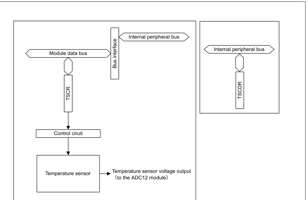

什么是TSN?
TSN是Temperature Sensor (TSN)温度传感器的简写,只不过它是瑞萨RA6E2内部的温度传感器,直接连接MCU芯片。
由上图可以看到TSN其实是ADC12通道

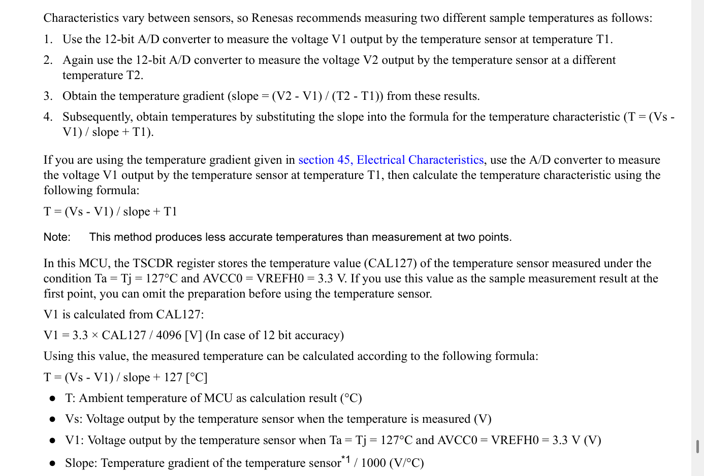

Characteristics vary between sensors, so Renesas recommends measuring two different sample temperatures as follows:
Use the 12-bit A/D converter to measure the voltage V1 output by the temperature sensor at temperature T1.
Again use the 12-bit A/D converter to measure the voltage V2 output by the temperature sensor at a different
temperature T2.
Obtain the temperature gradient (slope = (V2 - V1) / (T2 - T1)) from these results.
Subsequently, obtain temperatures by substituting the slope into the formula for the temperature characteristic (T = (Vs -
V1) / slope + T1).
If you are using the temperature gradient given in section 45, Electrical Characteristics, use the A/D converter to measure
the voltage V1 output by the temperature sensor at temperature T1, then calculate the temperature characteristic using the
following formula:
T = (Vs - V1) / slope + T1
Note:
This method produces less accurate temperatures than measurement at two points.
In this MCU, the TSCDR register stores the temperature value (CAL127) of the temperature sensor measured under the
condition Ta = Tj = 127°C and AVCC0 = VREFH0 = 3.3 V. If you use this value as the sample measurement result at the
first point, you can omit the preparation before using the temperature sensor.
V1 is calculated from CAL127:
V1 = 3.3 × CAL127 / 4096 [V] (In case of 12 bit accuracy)
Using this value, the measured temperature can be calculated according to the following formula:
T = (Vs - V1) / slope + 127 [°C]
● T: Ambient temperature of MCU as calculation result (°C)
● Vs: Voltage output by the temperature sensor when the temperature is measured (V)
● V1: Voltage output by the temperature sensor when Ta = Tj = 127°C and AVCC0 = VREFH0 = 3.3 V (V)
● Slope: Temperature gradient of the temperature sensor*1 / 1000 (V/°C)

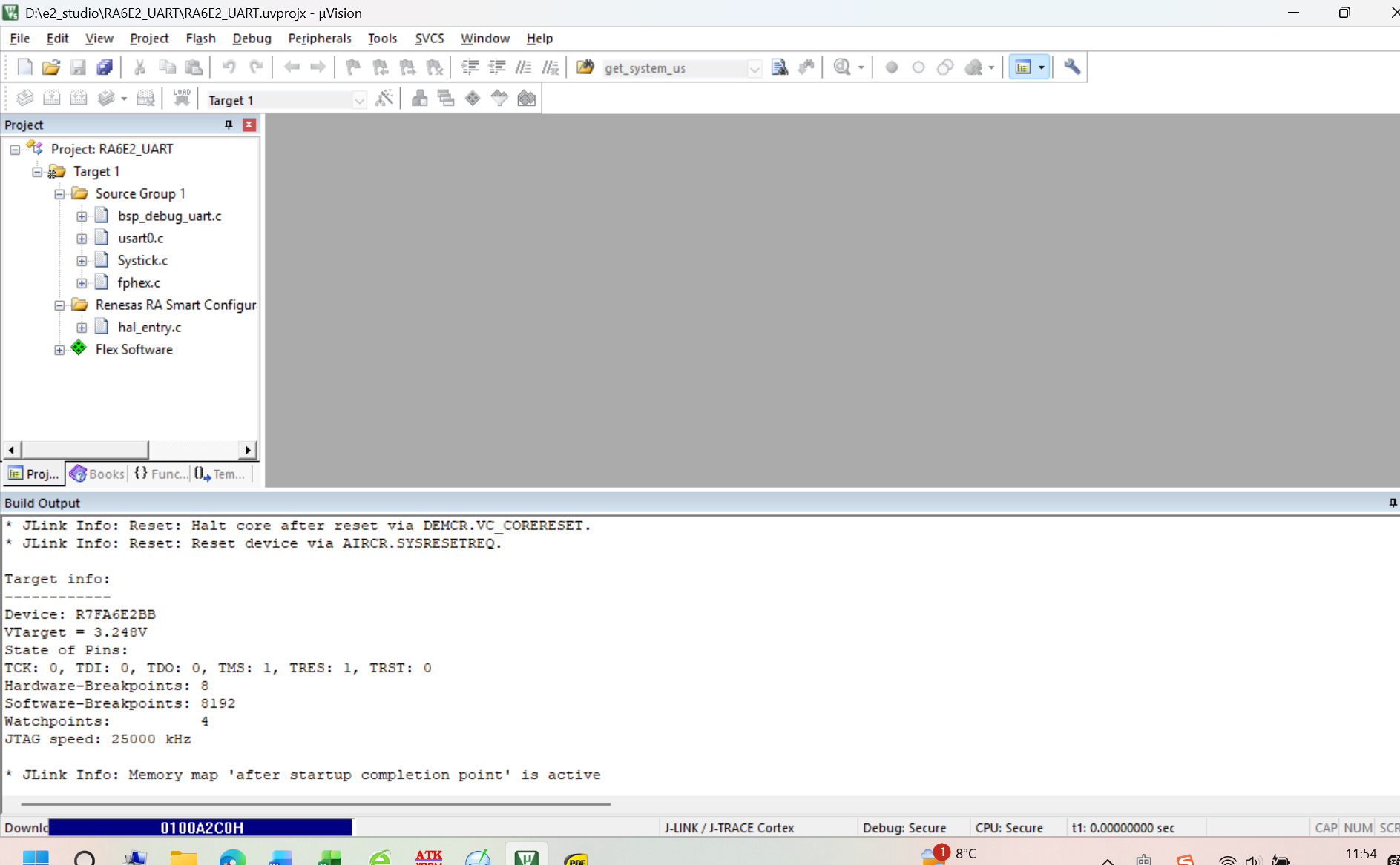

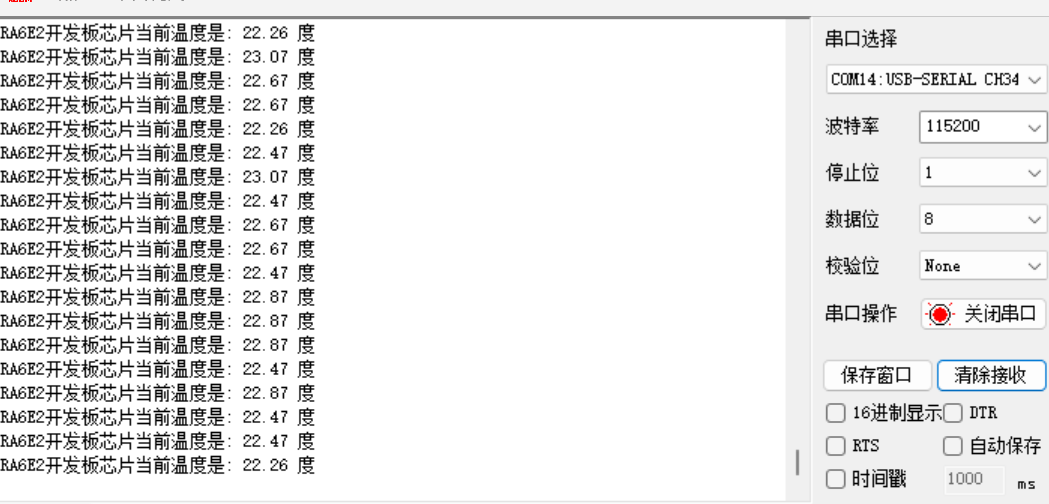

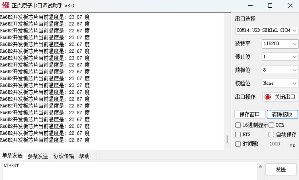

编译烧录代码,
打开串口助手
可以看到
RA6E2开发板芯片当前温度是: 22.67 度
