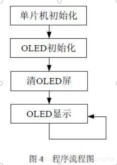

实现目标1、2所用固件库(只放了主要代码)
main.c
#include "delay.h"
#include "sys.h"
#include "oled.h"
#include "bmp.h"
int main(void)
  {        u8 t;
                delay_init();                     //
                NVIC_Configuration();          //
        LED_Init();                             //
        //                delay_ms(8000);
                OLED_Init();                        //
                OLED_Clear()          ;
                t=' ';
        while(1)
                OLED_Clear();
                OLED_WR_Byte(0x2e,OLED_CMD);    //
                OLED_WR_Byte(0x2a,OLED_CMD);    //
                OLED_WR_Byte(0x00,OLED_CMD);                //
                OLED_WR_Byte(0x01,OLED_CMD);                //
                OLED_WR_Byte(0x03,OLED_CMD);                //
                OLED_ShowCHinese(0,0,0);//
                OLED_ShowCHinese(18,0,1);//
                OLED_ShowCHinese(36,0,2);//
                OLED_ShowCHinese(0,2,3);//
                OLED_ShowCHinese(18,2,4);//
                OLED_ShowCHinese(36,2,5);//
                OLED_ShowCHinese(0,4,6);//
                OLED_ShowCHinese(18,4,7);//
                OLED_ShowCHinese(36,4,8);//
                OLED_ShowCHinese(0,6,9);//
                OLED_ShowCHinese(18,6,10);//
                OLED_ShowCHinese(36,6,11);//
                OLED_WR_Byte(0x2f,OLED_CMD);    //
                //OLED_ShowString(0,3,"19990592",16);
                //OLED_ShowString(8,2,"ZHONGJINGYUAN");
         //        OLED_ShowString(20,4,"2014/05/01");
                //OLED_ShowString(0,6,"ASCII:",16);
                //OLED_ShowString(63,6,"CODE:",16);
                //OLED_ShowChar(48,6,t,16);//
                t++;
                if(t>'~')t=' ';
                        delay_ms(9000);
                delay_ms(9000);
                OLED_DrawBMP(0,0,128,8,BMP1);  //
                delay_ms(9000);
                                        delay_ms(9000);
                delay_ms(9000);
                delay_ms(9000);
//                OLED_DrawBMP(0,0,128,8,BMP1);
//                delay_ms(8000);
//                                        delay_ms(8000);
//                delay_ms(8000);
//                delay_ms(8000);
                OLED_Clear();     //

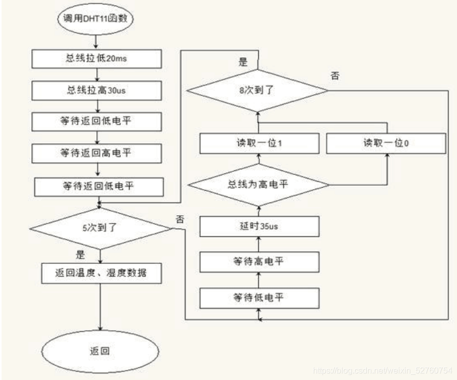

实现扩展目标所用固件库
举报
郭静
2021-12-23 10:15:03
main.c
#include "delay.h"
#include "sys.h"
#include "oled.h"
#include "bmp.h"
#include "Time.h"
#include "DHT11.h"
#define KEY1 PAin(4)
#define KEY2 PAin(2)
#define KEY3 PAin(1)
#define KEY4 PAin(0)
#define KEY_NUM1 1
#define KEY_NUM2 2
#define KEY_NUM3 3
#define KEY_NUM4 4
uint8_t KEY_Value; //°´¼üÖµ±äÁ¿
extern u16 miao,fen,shi;
void LED_GPIO_Init(void)//°´¼üGPIOÅäÖÃ
        GPIO_InitTypeDef  GPIO_InitStructure;
        RCC_APB2PeriphClockCmd(RCC_APB2Periph_GPIOB, ENABLE);         //
        GPIO_InitStructure.GPIO_Pin = GPIO_Pin_0;
        GPIO_InitStructure.GPIO_Mode = GPIO_Mode_Out_PP;
        GPIO_InitStructure.GPIO_Speed = GPIO_Speed_50MHz;//
        GPIO_Init(GPIOB, &GPIO_InitStructure);          //
        GPIO_SetBits(GPIOB,GPIO_Pin_0);
int main(void)
                u8 temperature;
          u8 humidity;
                delay_init();                     //
                OLED_Init();                        //
                DHT11_Init();
                TIM3_Int_Init(999,7199);
                NVIC_PriorityGroupConfig(NVIC_PriorityGroup_2);
                OLED_Clear();
                OLED_ShowString(24,0, "DHT11",16);
                OLED_ShowCHinese(80,0,0);//²â
                OLED_ShowCHinese(96,0,1);//ÎÂ
                OLED_ShowString(0,2,"Temp:   C",16);
                OLED_ShowString(0,4,"Humi:   %",16);
        while(1)
                        if(miao>=4)
                                          PBout(0)=!PBout(0);//LEDÉÁ˸
                  DHT11_Read_Data(&temperature,&humidity);        //
                              OLED_ShowNum(40,2,temperature,2,16);        //
                              OLED_ShowNum(40,4,humidity,2,16);                //
                                          miao=0;
oledfont.h
char Hzk[][32]={
{0x10,0x60,0x02,0x8C,0x00,0xFE,0x02,0xF2,0x02,0xFE,0x00,0xF8,0x00,0xFF,0x00,0x00},
{0x04,0x04,0x7E,0x01,0x80,0x47,0x30,0x0F,0x10,0x27,0x00,0x47,0x80,0x7F,0x00,0x00},/*"测",0*/
{0x10,0x60,0x02,0x8C,0x00,0x00,0xFE,0x92,0x92,0x92,0x92,0x92,0xFE,0x00,0x00,0x00},
{0x04,0x04,0x7E,0x01,0x40,0x7E,0x42,0x42,0x7E,0x42,0x7E,0x42,0x42,0x7E,0x40,0x00},/*"温",1*/
dht11.c
u8 DHT11_Init(void)
        GPIO_InitStructure.GPIO_Pin = GPIO_Pin_11;                                 //
        GPIO_InitStructure.GPIO_Mode = GPIO_Mode_Out_PP;                  //
        GPIO_SetBits(GPIOB,GPIO_Pin_11);                                                 //
        DHT11_Rst();  //¸´Î»DHT11
        return DHT11_Check();//µÈ´ýDHT11µÄ»ØÓ¦

2.主流程图
3.模块流程图
四、结语
以上是本人通过查阅资料和自己学习的成果,通过最小系统STM32F103C8T6对OLED进行控制使其显示图像和姓名及用温湿度模块对环境温度进行采集,将环境温度显示在OLED屏幕上,希望这些内容可以帮助读者解决一些基础问题,同时也希望读者能够充分利用网上资源去学习。
