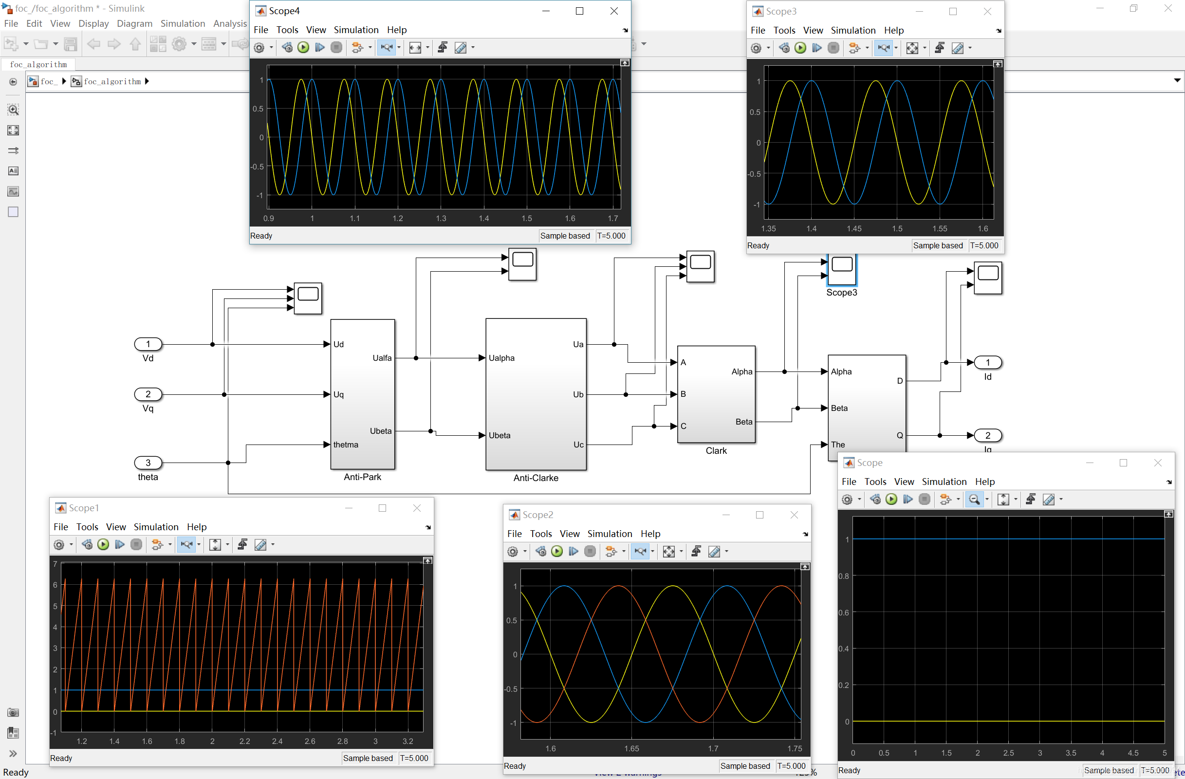

  FOC算法的搭建及板子验证
  simulink模型仿真及结果

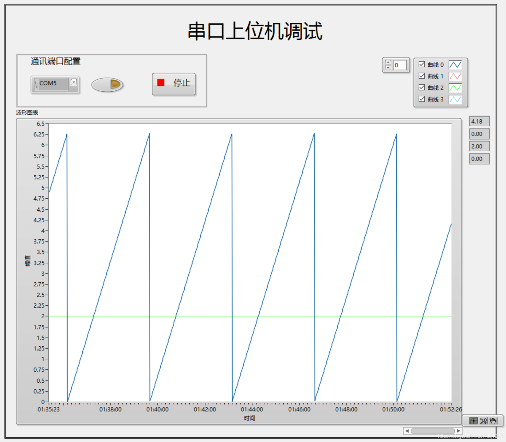

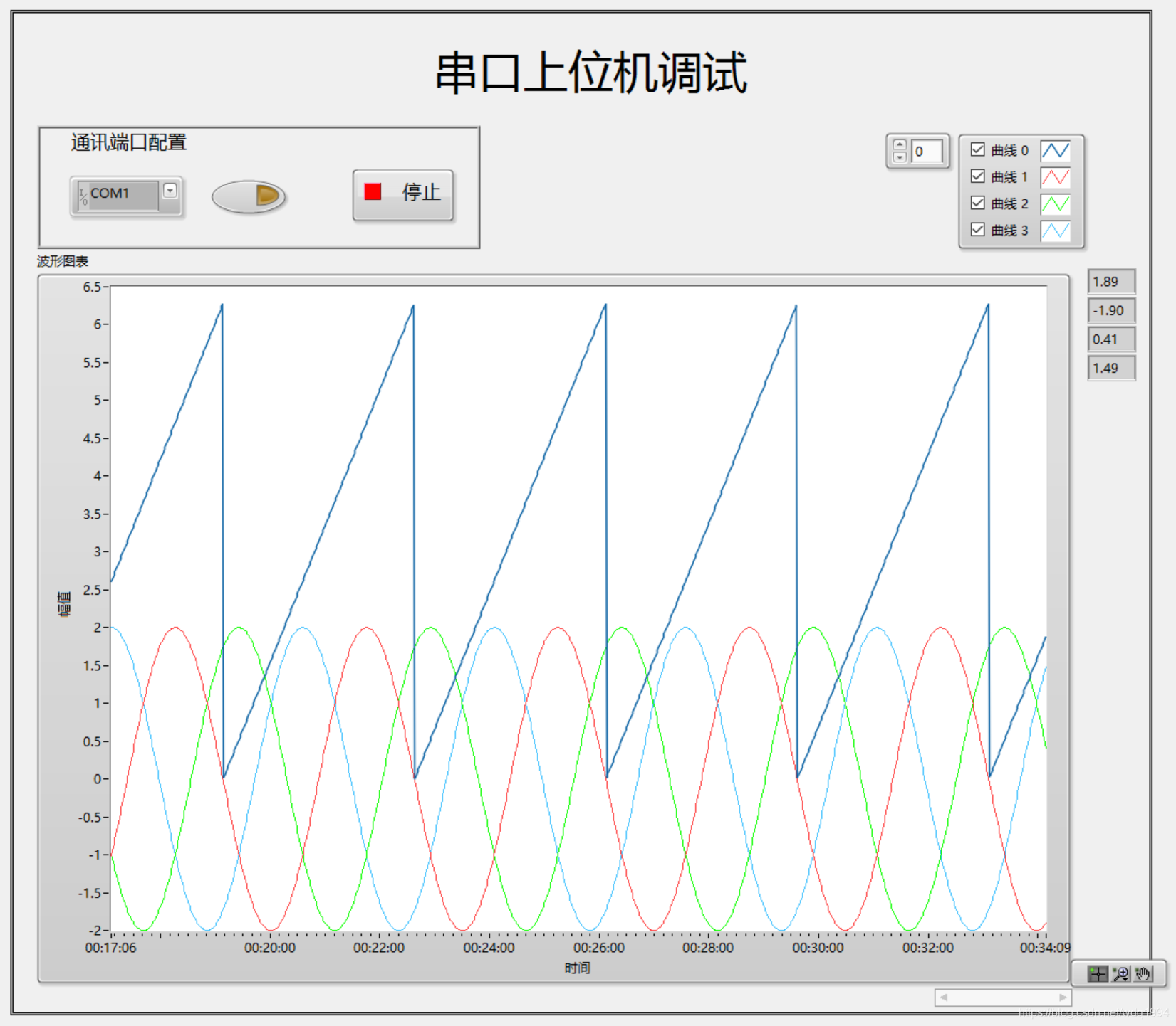

  硬件仿真及结果
  下面是ADC中断中运行的代码,Iq手动给的2A。
  //验证FOC算法
  theta += 0.03f;
  if(theta 》 (2.0f * PI))
  theta -= (2.0f * PI);
  rtU.theta = theta;
  rtU.Vd = 0;
  rtU.Vq = 2;
  foc_algorithm_step();
  printf(“%4.3f,%4.3f,%4.3f,%4.3f,n”,rtU.theta,rtY.Ua, rtY.Ub, rtY.Uc);
  //printf(“%4.3f,%4.3f,%4.3f,n”,rtU.theta,rtY.Id, rtY.Iq);
