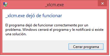

Webpack ISE 14.7的许可问题
我已经安装了ISE Webpack 14.7但是当我尝试运行许可时,会出现一条消息:
_xlcm.exedejódefuncionar(_xlcm.exestopped working)
我有win8.1
朋友有相同的操作系统,他们没有任何问题。
以上来自于谷歌翻译
以下为原文
I've installed ISE Webpack 14.7 but when I try to run licensing, a message appears:
_xlcm.exe dejó de funcionar    (_xlcm.exe stopped working)
I have win8.1
A friend has the same OS and they don't have any problem.

这可能会有所帮助 -  http://binarykoala.blogspot.in/2013/10/get-xilinx-ise-146-webpack-to-work-on.html

这对我来说对14.7 Labtools有用,希望它有所帮助。
将 Xilinx  14.7  LabTools  LabTools  lib  nt64  libportability.dll重命名为libportability.dll.orig2。
将 Xilinx  14.7  LabTools  common  lib  nt64  libportability.dll重命名为libportability.dll.orig3。
将 Xilinx  14.7  LabTools  LabTools  lib  nt64  libportabilityNOSH.dll复制到​​ Xilinx  14.7  LabTools  LabTools  lib  nt64  libportability.dll4。
将 Xilinx  14.7  LabTools  LabTools  lib  nt64  libportabilityNOSH.dll复制到​​ Xilinx  14.7  LabTools  common  lib  nt64  libportability.dll
